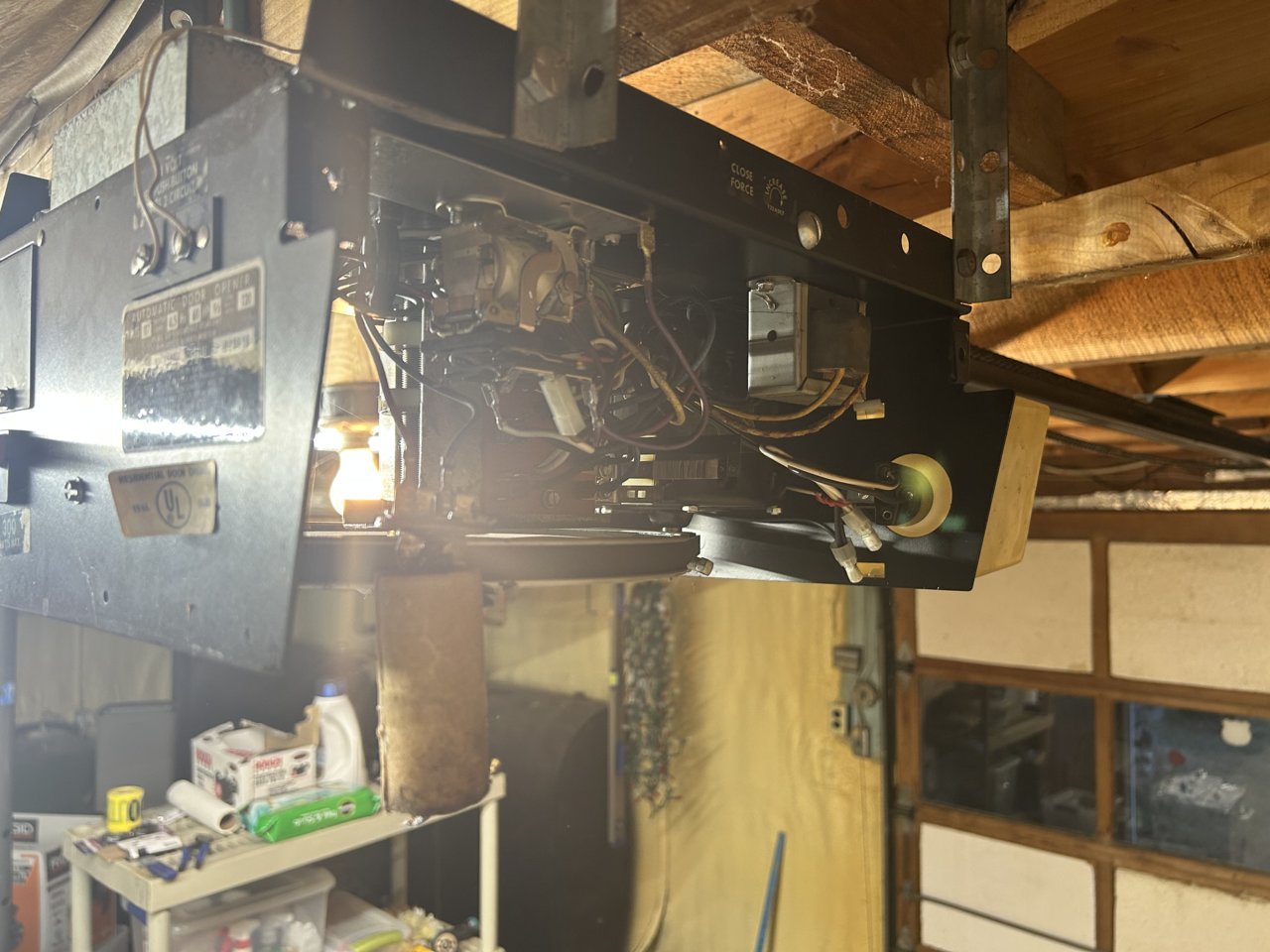

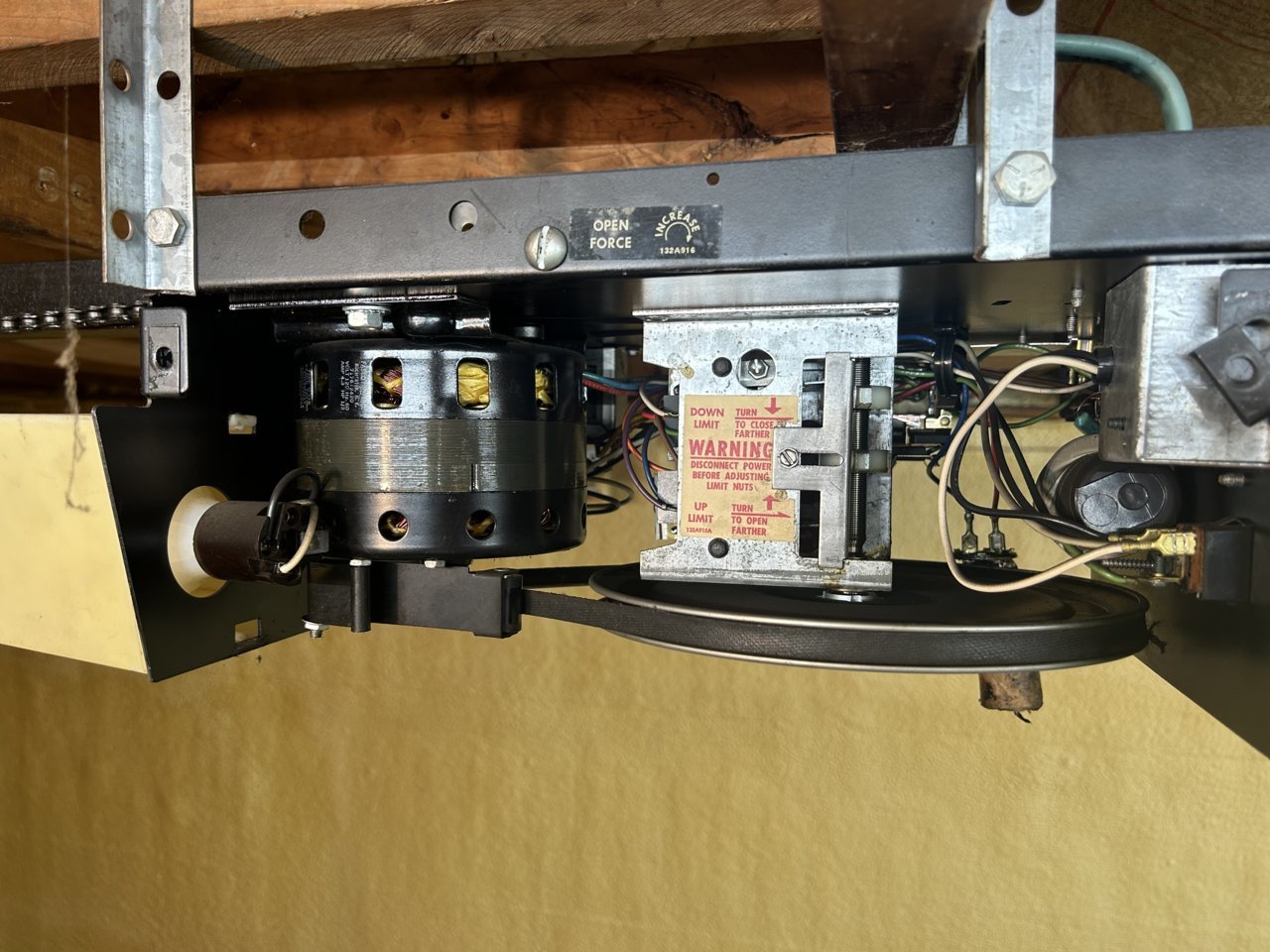

    The new capacitor is around $20 at any industrial motor shop or an HVAC supply house. Often the problem is that the door is just so far out of adjustment, the door wheels get bad too and cause drag.
    Fortunately they are pretty cheap:
    https://americandoorsupply.com/garage-door-rollers.html
    A few dollars and an hour or two to tune everything up and be back in business, with most of your money still in your pocket. :D

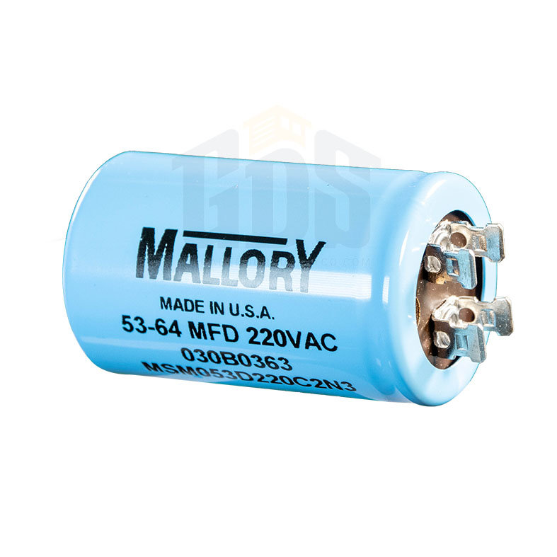

    30b363 should be the part number for the capacitor.
    https://www.garagedoorsupplyco.com/LiftMaster-30B363-Capacitor-for-12-13-HP-Openers_p_979.html
    The specs are in the photo so you could get one locally.
    That unit was built for Sears by Liftmaster.
