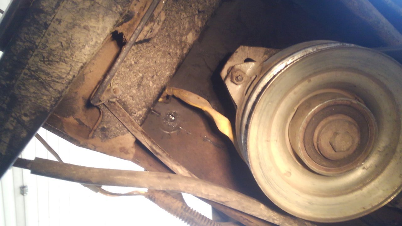

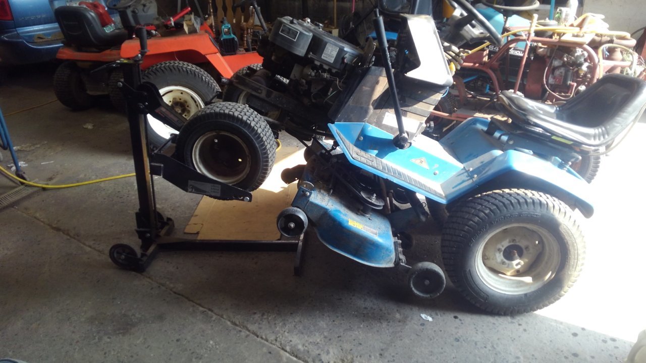

    Well, equipped with the mower jack this time I assumed "the position" underneath the New Holland mower.
    And found this...
    There is supposed to be a bolt at about 1 o'clock in the photo.

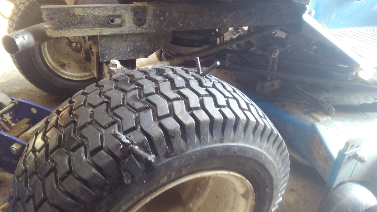

    ... and this too... :(
    Two loose bolts, one missing and one snapped off. This is where I needed the :canada: thread bolts.
    They are supposed to hold the engine to the mower chassis -- this explains that funny knocking noise, I observed the engine shifting around as I cranked it over.
    I figured 3 new tight bolts were better than 2 old loose ones... :notsure:

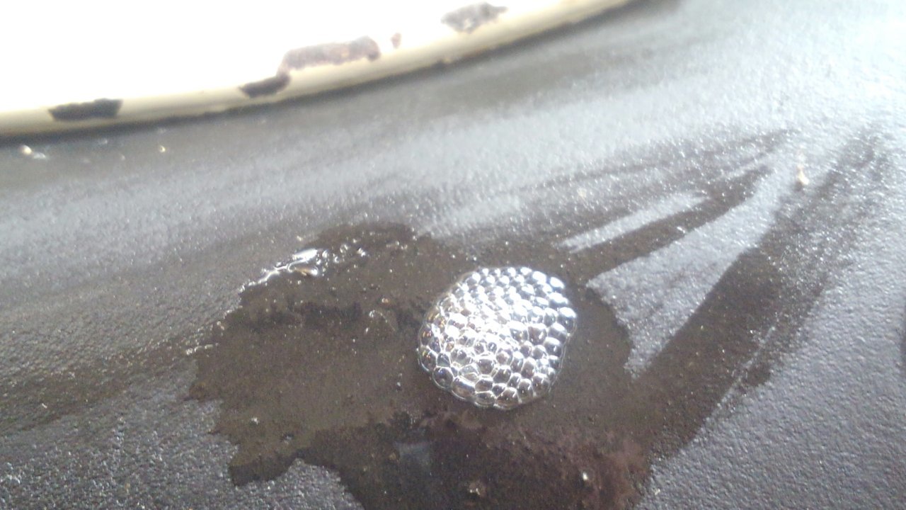

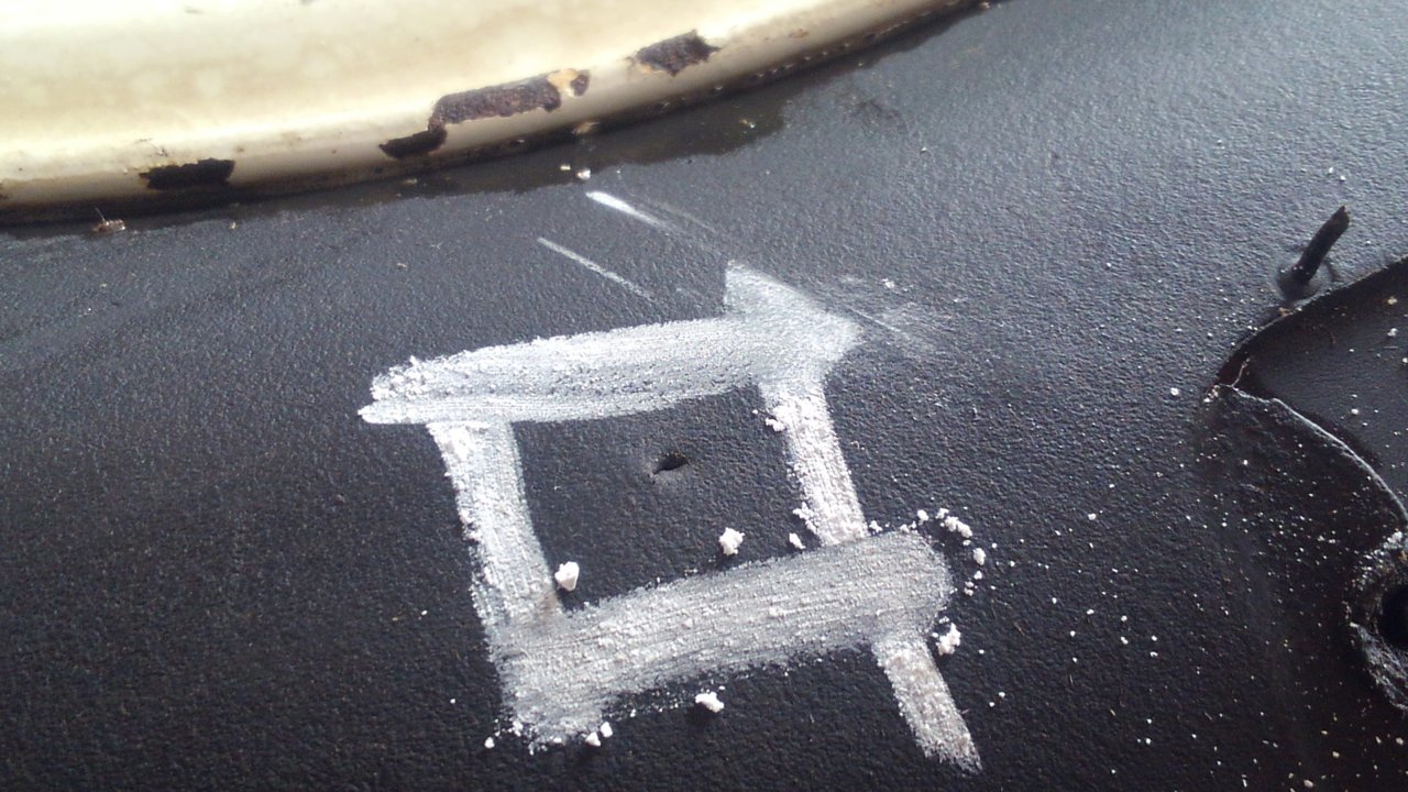

    And then the tires - always :censored: tires... :mad:
    The rear tire has leaked for a little bit *cough*...
    since last year. :anonymous:
    I would have to fill it each week which is a PITA as the valve stem is on the inside..
    Turns out so was the leak.
    In the sidewall of the tire :confused::confused:, I was expecting a thorn in the tread, instead I found this little pock. Manufacturing defect?
    Normally sidewall damage on a tire is a terminal fault - it's on a mower with a top speed of 6 mph so I put a plug in it.
    :fingerscrossed:

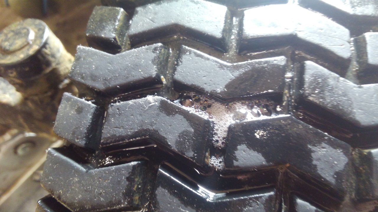

    The diagonal front tire leaked too. :annoyed:
    Turned out to be in 2 places, again just tiny pinholes :confused: , I noticed this tire had 2 plugs already, now it has 4.
    All of the tires were new about 3 years ago, made in :oldglory:, just not like they used to I guess. :pout:
