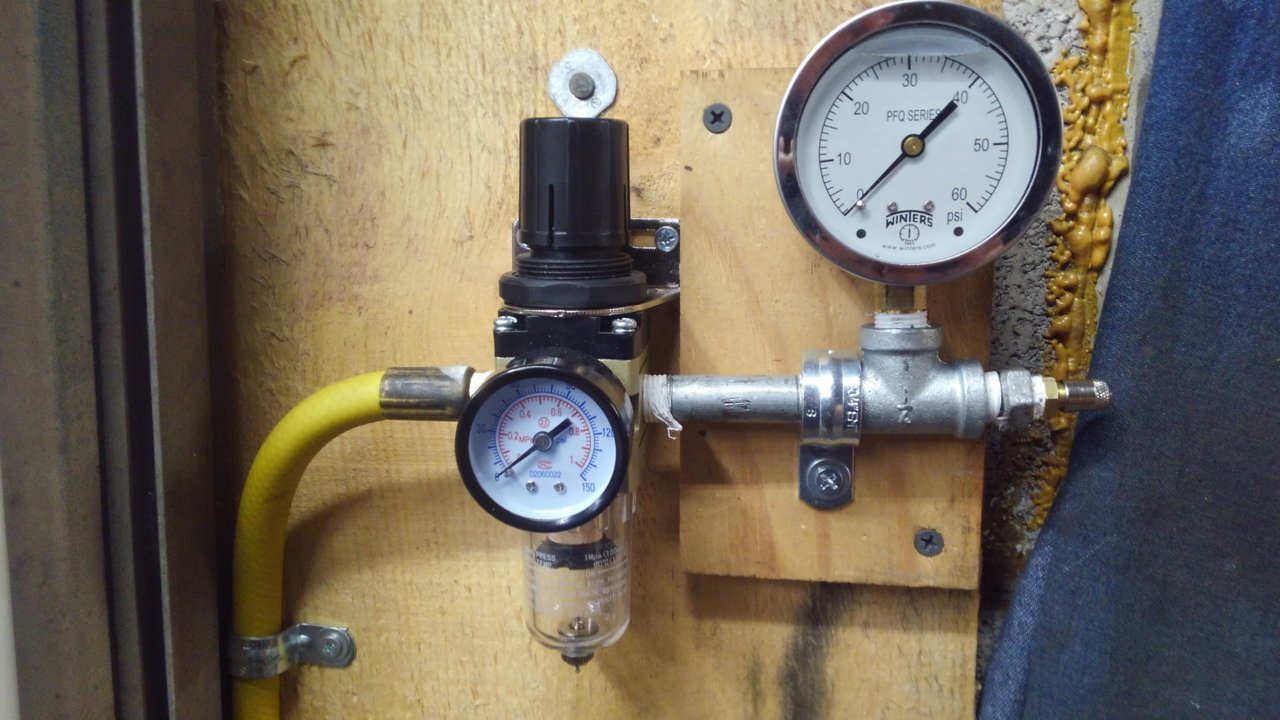

    Well Wrenchmen, after yesterday's fun filled adventures with tree I'm moving pretty slow today - first gear only.
    Too wet to mow so I found a low impact project.
    As any longer term reader knows I have a challenged relationship with sleep, I'm sure many Wrenchmen have lain awake at night wondering the age old question: "is my tire gauge accurate??"
    ...well, maybe not... ;)
    So I put this unit together with stuff I had around the archives.
    Pretty self explanatory, a reg-u-lator, nice liquid filled 0-60 psi gauge and a tire fitting (Schrader valve) on the end.
    Gauges are generally most accurate in the center of the scale, that is why I used a 60 psi max unit.

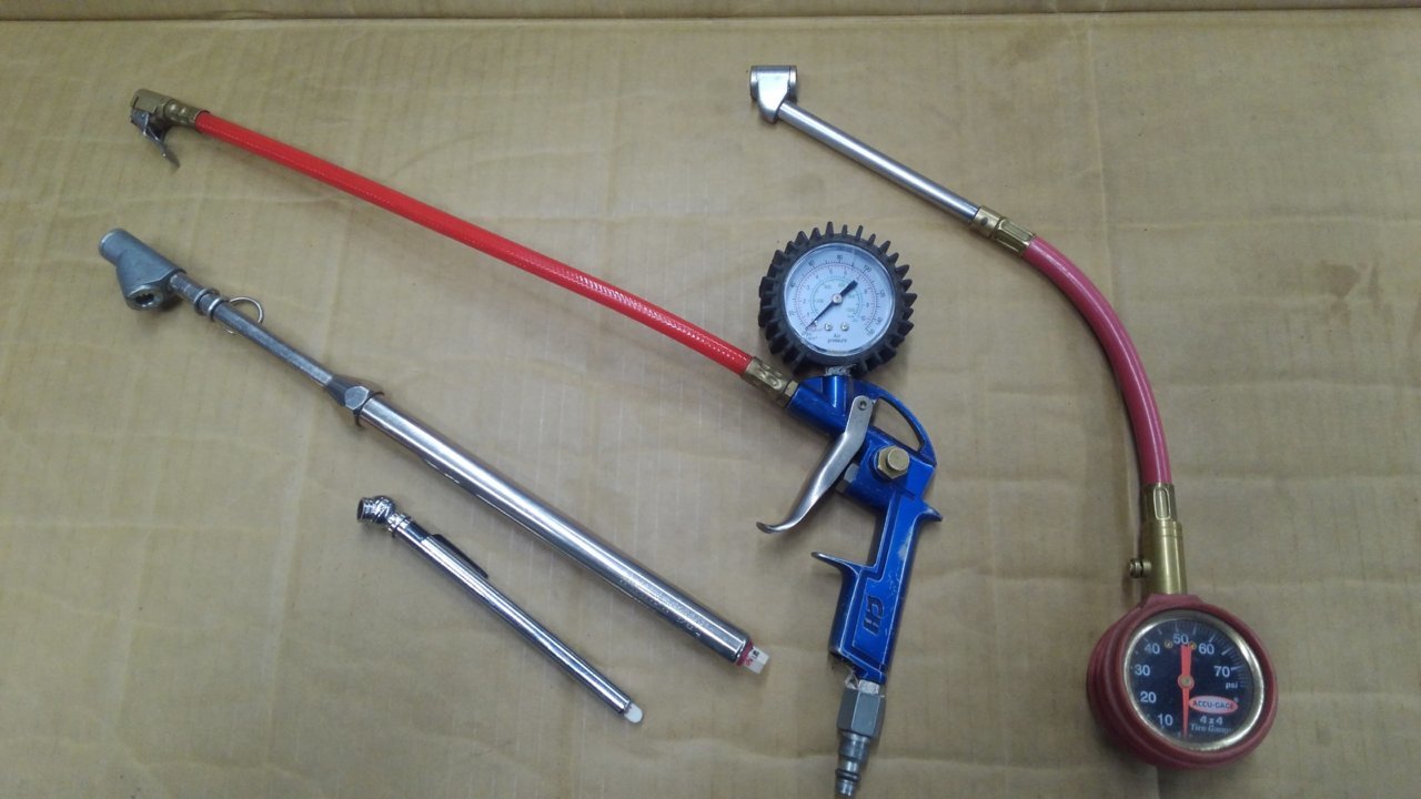

    I rooted around and found four gauges.
    On the left, a cheapie that came with a tire plug kit.
    Next a HD Milton unit I have had for years. :oldglory:
    #3 A Campbell Hausfeld unit from The Mart - I knew this one wasn't trustworthy.

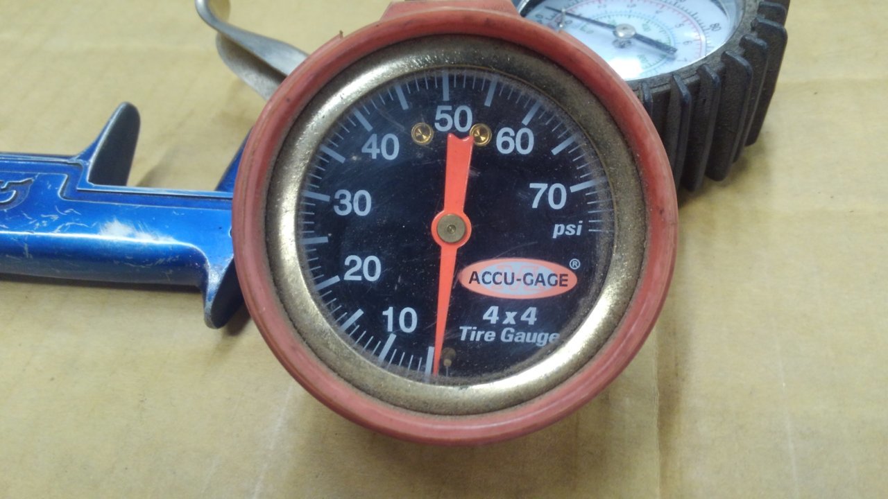

    #4 A nicer "Accu-Gage 4x4 :taco:
    This one has a deflate valve too.
    I tested from 20 to 60 psi in 5 psi increments.
    What I learned:
    #1: 2-3 psi low at all psi - it only goes to 50 max.
    #2: The 25 year old Milton was the most accurate, from right on to 1 psi low at maximum.
    #3 I knew this thing was junk, up to 8 psi low. :eek:
    #4 Interesting, this one holds the reading until you push the vent button. With air applied it read high, off the air the reading dropped to within 2 psi, this is the only gauge that read high.
    Useful :notsure:, didn't cost anything and didn't take much effort. :laugh:
    Now I will sleep better...:rofl::rofl::rofl:
