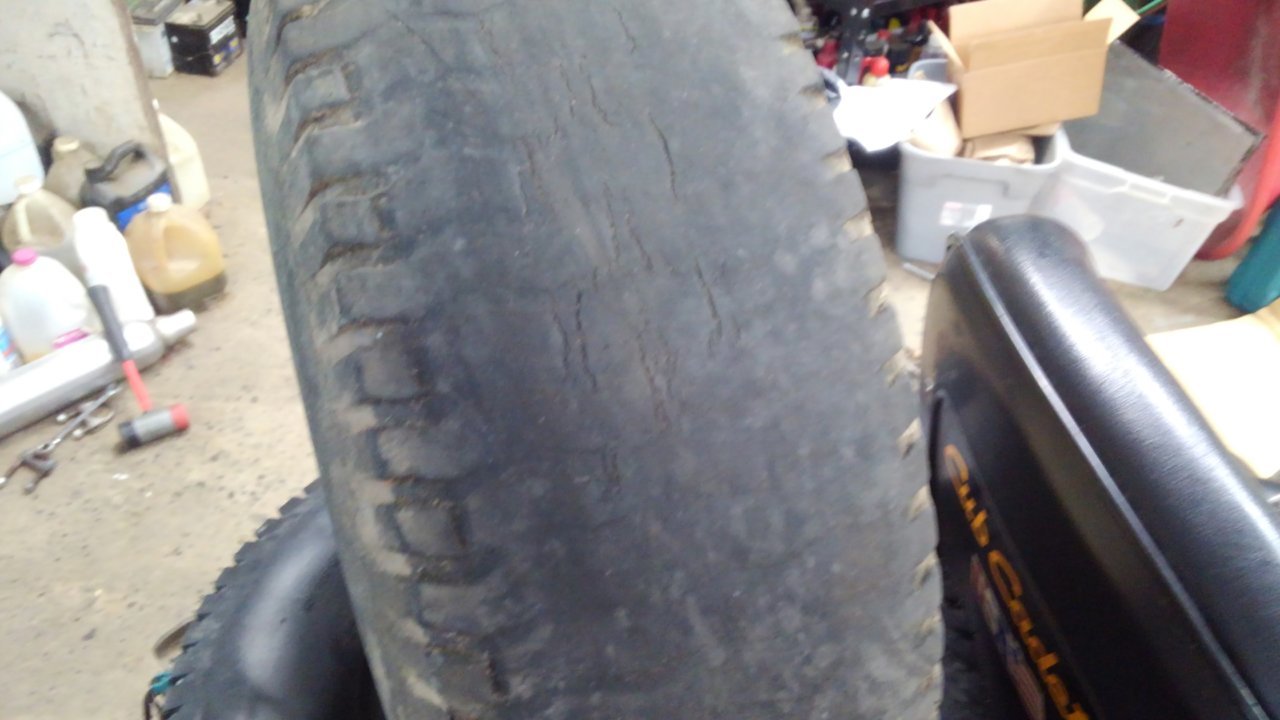

    Meanwhile, back at the cabin, this tire has been giving me a bit of concern, after all I want (need, I'm poor) to get the most use from it.
    It isn't as bad as it seems, it holds air still -- for most of a week. :D
    Anyhow, as I'm grumbling about the exorbitant price of the blades that I will probably find a new rock with inside of half an hour I happen to look on the floor under the blade rack. Hmm :confused:
    Well, now - that size seems familiar. :)
    Whaddya know - the sun shines on a dog's @$$ now and then it would seem!
    :yes:
    .... or does it....? :ballchain:

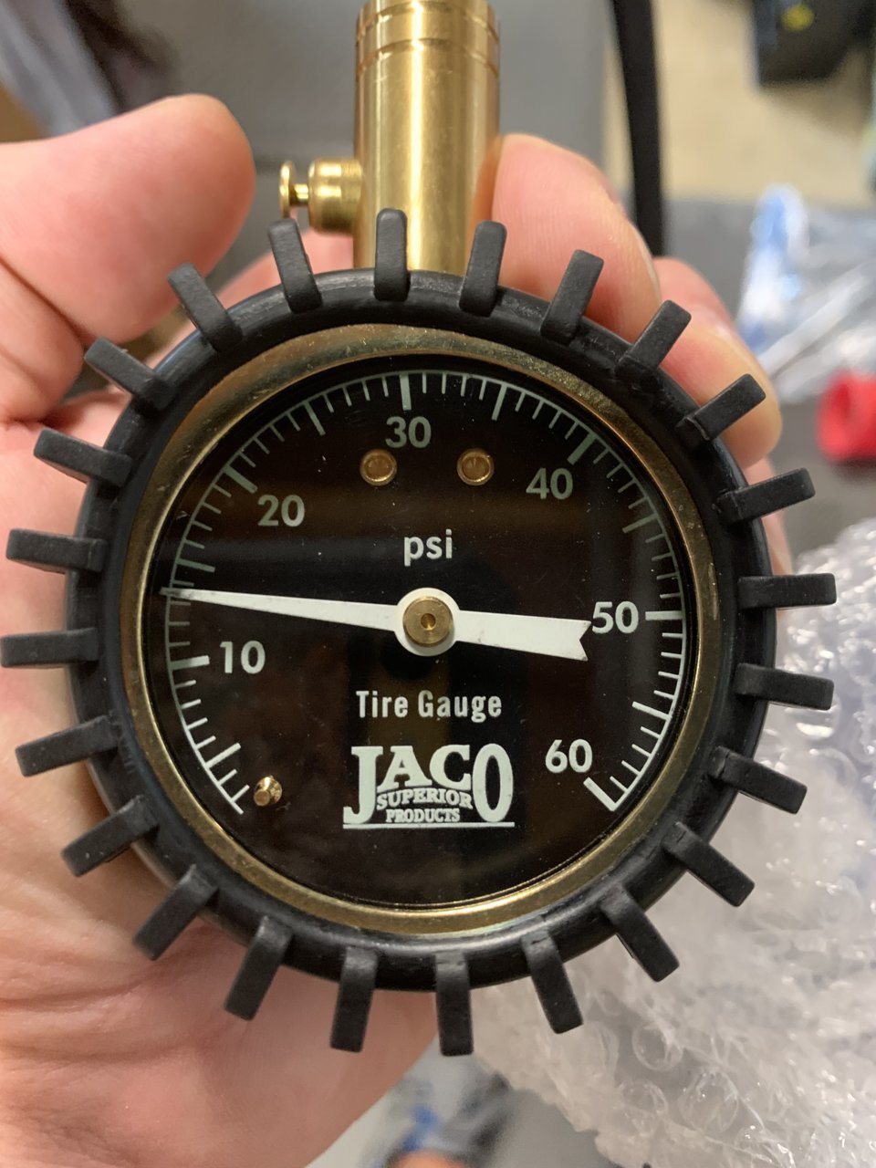

    Bought new from Amazon and it showed up stuck on 13psi, replacement sent and works as it should, but is there any easy way to get the needle back to 0psi?

    Toss it in the trash can and see if that helps

    If the face will come off you can usually pop the hand off using 2 putty knives 180 degrees apart.
    Then press it back on in the zero position & check against a known good gauge.

    Probably just a sticky hand. I've had this happen so many times that nowadays I just flick them as soon as I lay eyes on, even when flat. Give that glass plastic a solid somewhat firm thwack.

    Yes, the needle is pressed on. Pull upwards and it will release (the rod and center are a taper fit to accept the press capture). You can then either zero, or better… regulate a known pressure and set. Check a few pressures to confirm accuracy. The track ones were all made this way to allow for recalibration.
