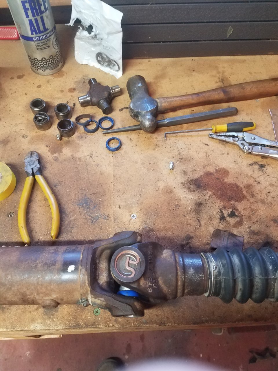

    Wife was busy in the kitchen so I went about the job myself. Driveshaft put back together. It almost feels a little tight like the spring clips a hair too thick...it'll loosen I suppose 20210117_135746.jpg

  2. Jan 17, 2021 at 12:07 PM
    #7482
    Delta09
    Delta09 Requires Supervision
    Apr 29, 2019
    #291677
    13,296
    Adam
    South Central PA
    2024 SR5 DCSB 4WD
    "Gently" tap where the joint goes into the shaft. That should loosen things up. If you have ANY binding or resistance it will not last long at all.

  3. Jan 17, 2021 at 12:11 PM
    #7483
    tacotoe
    tacotoe Pastry Chef
    Nov 25, 2007
    #3593
    5,915
    Nebraska
    `17 AC Sport MT
    ARE Topper, Icon aal, OEM Audio+
    Hmm, ok I appreciate that advice. I actually did that on the first two in and that helped a bunch. Do you mean right on the end where the spring keeper goes over the cap?
  4. Jan 17, 2021 at 12:14 PM
    #7484
    tacotoe
    tacotoe Pastry Chef
    Nov 25, 2007
    #3593
    5,915
    Nebraska
    `17 AC Sport MT
    @Delta09 that worked great. A few taps all around with dead blow and it freed up..much better thanks!

  5. Jan 17, 2021 at 12:16 PM
    #7485
    Delta09
    Apr 29, 2019
    #291677
    13,296
    Adam
    South Central PA
    2024 SR5 DCSB 4WD
    I'm horrible at explaining things, so here's my badass MS Paint rendering. Tap where arrows point:
    Damn you're fast! I'm still leaving my original post as it took me a little bit :rofl:
  6. Jan 17, 2021 at 12:25 PM
    #7486
    tacotoe
    tacotoe Pastry Chef
    Nov 25, 2007
    #3593
    5,915
    Nebraska
    `17 AC Sport MT
    Still much appreciated!

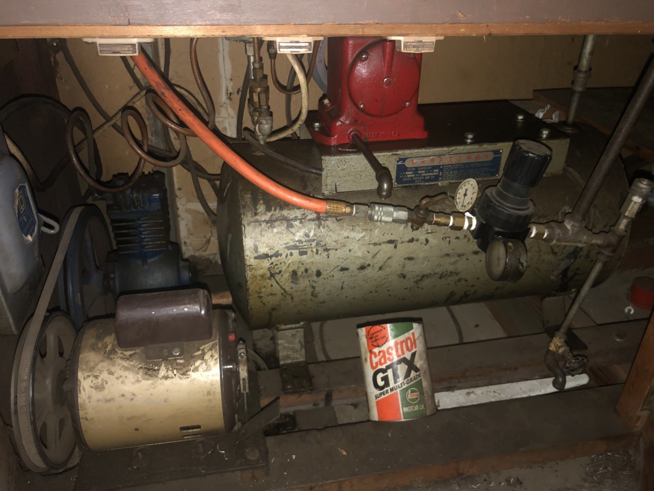

  13. Jan 17, 2021 at 1:17 PM
    #7493
    WBF610
    WBF610 Member well known
    Aug 25, 2015
    #162672
    22,332
    Carey
    Eastern PA
    2016 DC OR
    mats, flaps, and stickers. Extang solid fold 2.0. Mobtown sliders and full skids. AVS vents
    Any of you know anything about old built in compressors? I got as far as turning it on to check if it runs, it does. Need to figure out valving, drain, etc.image.jpg
  14. Jan 17, 2021 at 1:23 PM
    #7494
    Wyoming09
    Wyoming09 Well-Known Member
    Apr 24, 2015
    #153833
    14,277
    New Tripoli Pa
    2000 Work truck 5 speed 4x4 3.4
    Super Springs
    What do you need to know ?Like setting up pressure switch etc
    Looks like it could be a Truck Compressor someone borrowed and hung a motor on.
    quite a few of those were floating around back in the seventies .
  15. Jan 17, 2021 at 1:39 PM
    #7495
    six5crèéd
    six5crèéd [OP] Be the light
    Jul 9, 2019
    #298734
    35,983
    Southern Virginia
    8 lugs no plugs
    The drain on the right looks just to drain the moisture build up. Looks like a farmer fix :D
    WBF610[QUOTED], tacotoe and T-yoda like this.

  18. Jan 17, 2021 at 2:01 PM
    #7498
    tacotoe
    tacotoe Pastry Chef
    Nov 25, 2007
    #3593
    5,915
    Nebraska
    `17 AC Sport MT
    Ringo got to thinking, lol:frusty: it looked like this U-joint was dry soooooo maybe I couldn't get the grease gun in there on the zerk... I'll just put the zerk in facing the other way! I should know better 20210117_154503.jpg
  19. Jan 17, 2021 at 2:02 PM
    #7499
    six5crèéd
    Jul 9, 2019
    #298734
    35,983
    Southern Virginia
    8 lugs no plugs
    Time to grind some off the grease gun end. Make it fit :D
    T-yoda and tacotoe[QUOTED] like this.
  20. Jan 17, 2021 at 2:04 PM
    #7500
    tacotoe
    tacotoe Pastry Chef
    Nov 25, 2007
    #3593
    5,915
    Nebraska
    `17 AC Sport MT
    :rofl:I don't know look at my previous post :crazy::homer: I know better now! Thanks though, it should hold until spring, and I have a needle tip that might work.
