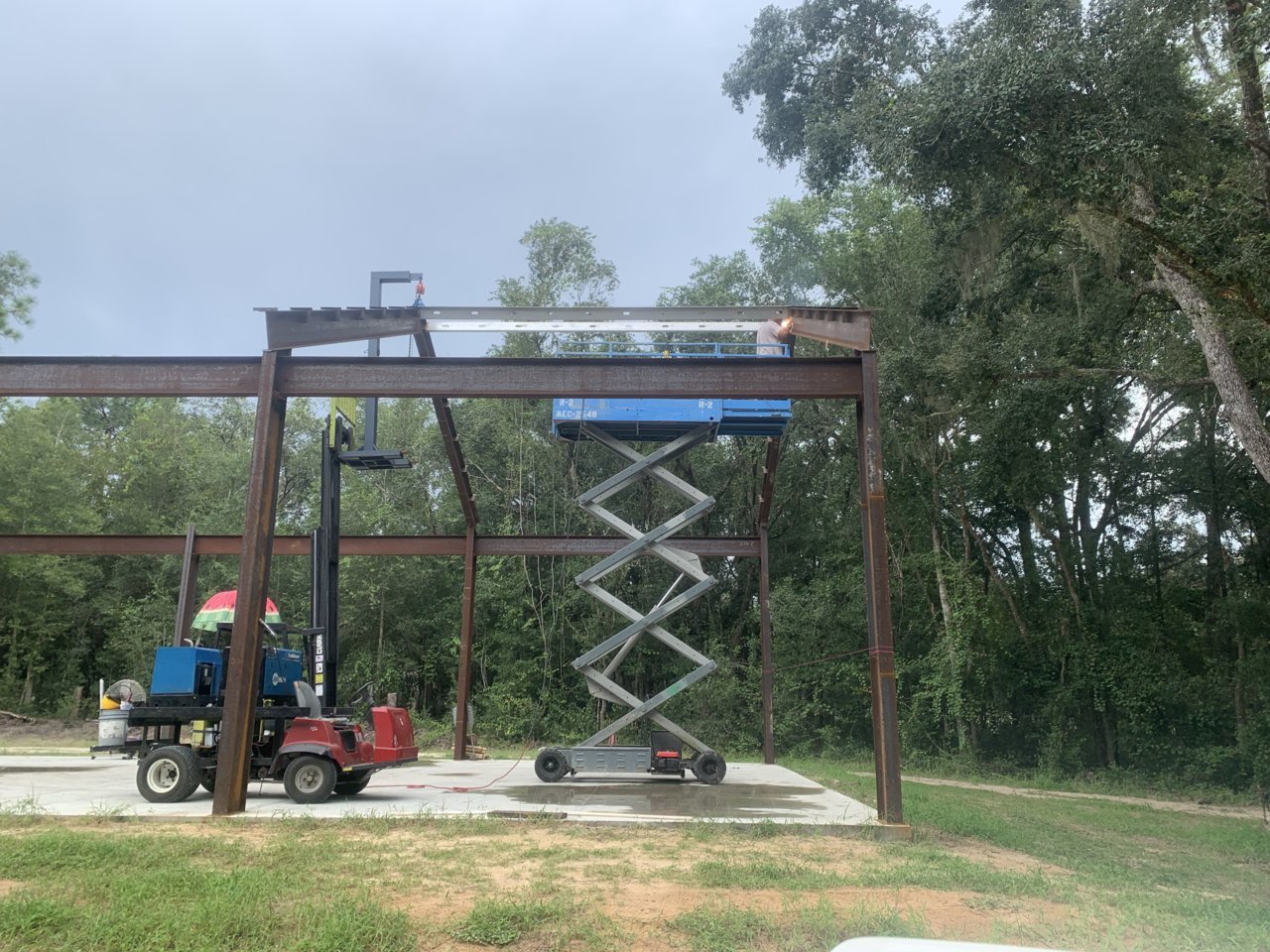

    2nd beam up tagging IMG_6898.jpg purlins

    Using Man lifts makes these jobs so much easier .
    2 Machines in case one quits? One for AC power one to weld?

    Many years back a co-worker and I (both of us big guys) were up on a similar but smaller manlift like that.
    We had the "porch" section extended out and both of us were out there leaning way out over the front pulling on a big pipe wrench.
    :benchpress: :benchpress:
    Simultaneously we both detected an odd sensation... :confused::confused:
    Then realized it was the rear wheels of the lift coming off the ground -- about 19 feet below us.
    :eek: :censored: :rocket: << Rusty
    :eek: :censored: :rocket: << Rusty's co-worker
    Squealing like teenage girls at a Shaun Cassidy concert we both scrambled (uphill) to the back of the lift and felt the rear tires hit the concrete with a solid thud and clang.
    After we got our heart rates down below 200 we much more cautiously continued the work (and from that day forward).

    Just could not quite get the Man Lift into the correct spot .
    Being on Two different ladders would suck more.

    He got both last week and just putting some hr on the booth, he bought them and was told they didn’t work, did a plug change and fixed the grounds and boom 2 beautiful welding generators . He knows every thing mechanical. I’ve gotten better being married to his sister for the last 23 years and learned a lot from him. He recently told me I have gotten better from the beginning :anonymous:

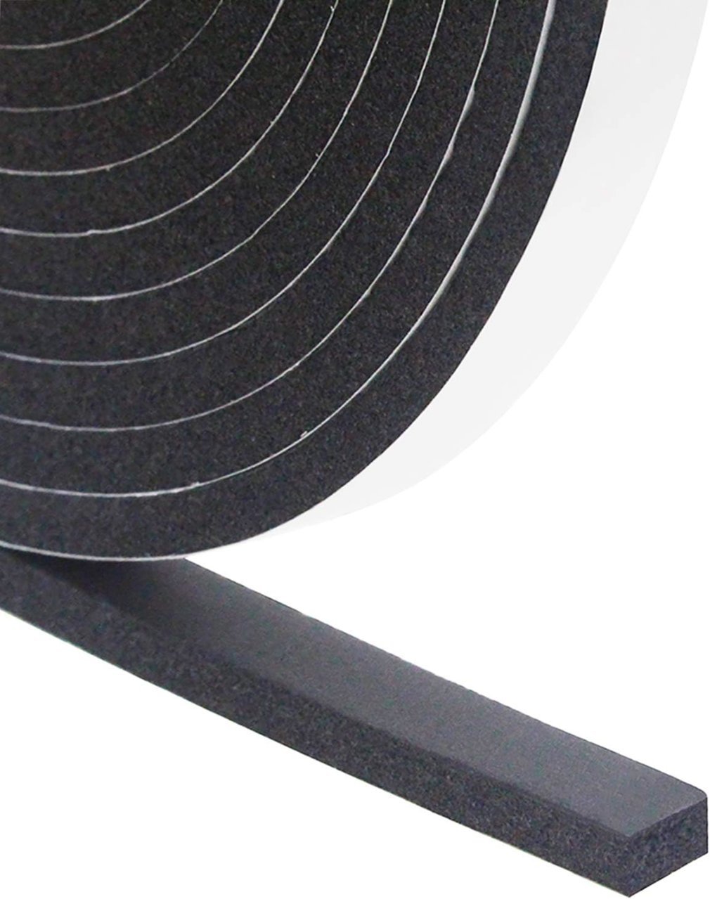

    I had a problem with the evaporator coil icing over on our fridge, the problem was a factory wimpy foam gasket allowing the air to go around the coil. Some thicker foam from Slowes fixed the problem.
    Like this, peel off the backing and it sticks well on a clean dry surface.

    The wimpy original was 1/4" wide and about 1/8" thick -- and falling off... :mad:
    The manly new material is about 3/4" wide and 1/2" thick. :muscleflexing:

    The foam seals are adequate on the coil cover, there’s really no room to put in thicker foam. Biggest problem is the factory defrost coil just isn’t big enough, only covers the bottom of the coil, it can’t keep up with the moisture as it cycles.
