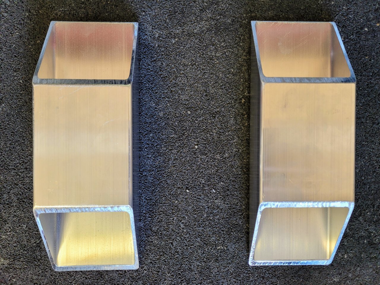

    @samiam posted these over in Maner's thread, some compressor mounts he made. Thought I'd share them in case anybody wanted to copy them ask any questions :D

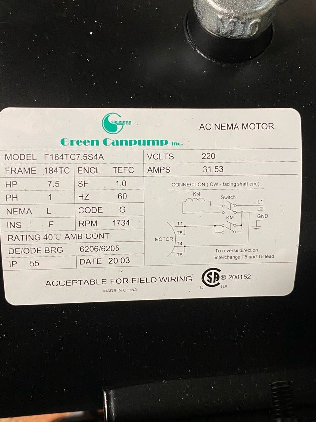

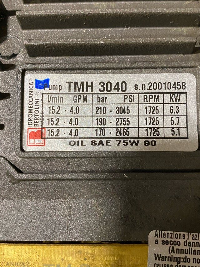

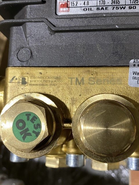

    This motor is 220V single phase, the pump is Italian.

    He said he's going to use it to wash his racks when they come out of the burn off oven. He's been using a gas pressure washer for a while and he's tired of getting gas and waiting on his guy to hook it up, etc. This way all he has to do is flip a switch and he's washing.

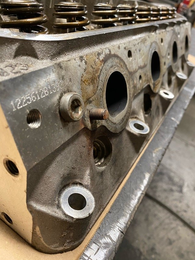

    Customer came in and said the tire place recommended us to him. He has two aluminum heads with a bolt broke off in each one. Luckily they’re sticking out. Time to try the weld a nut technique.

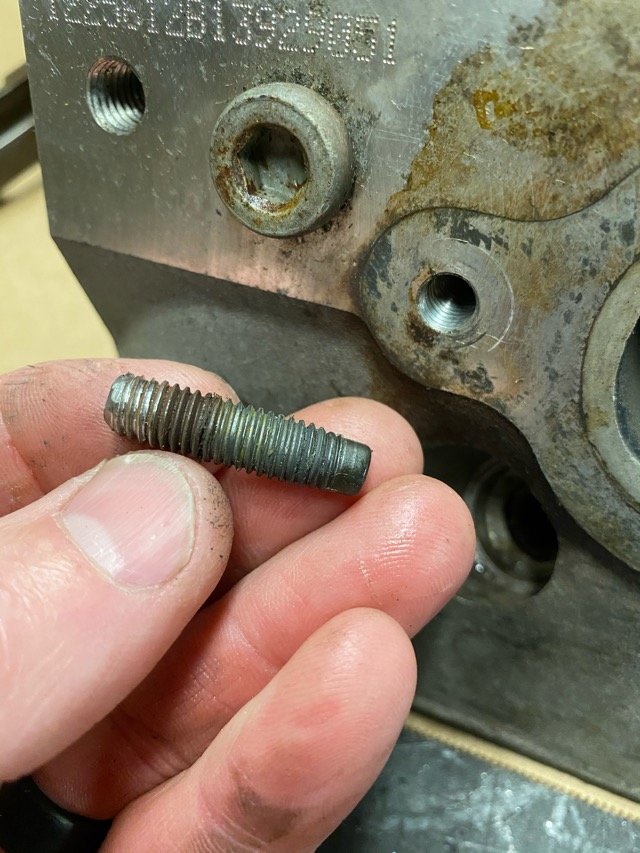

    Try before you pry. One down, one to go :)

    Damn, that things gonna suck down the juice, 32 amps! Our 25HP motors normally only draw an average of 13-15 using 3 phase. It does get me a little confused sometimes doing electrical at the house :rofl:

    Ahh that lovely "hey I think it's gonn... SNAP!" Atleast this head is out of the vehicle. It's a super fun job on say an older 5.4L 2 valve or 6.8L in the truck. Agh, there goes those Vietnam style flashbacks... :laugh:
