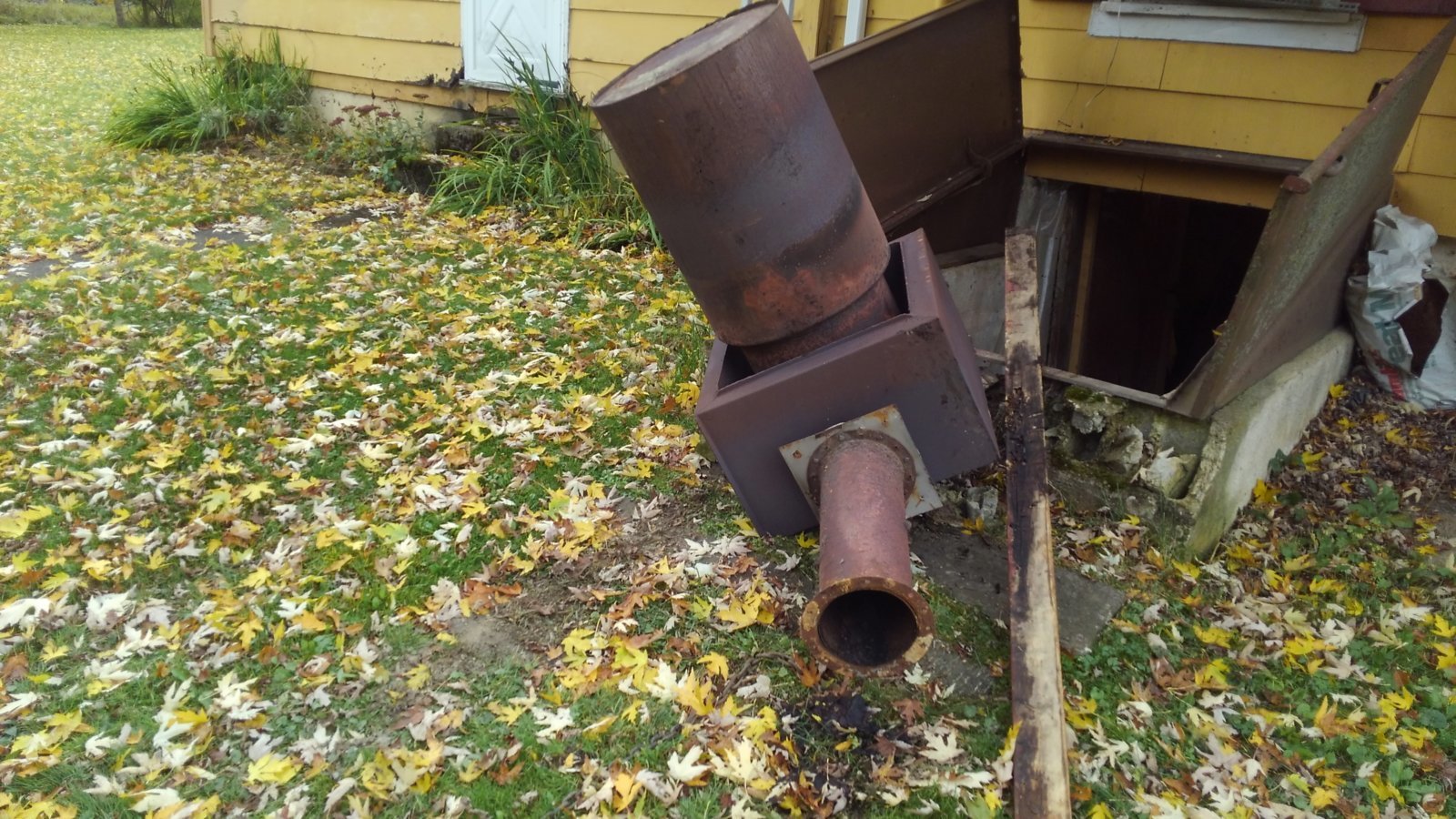

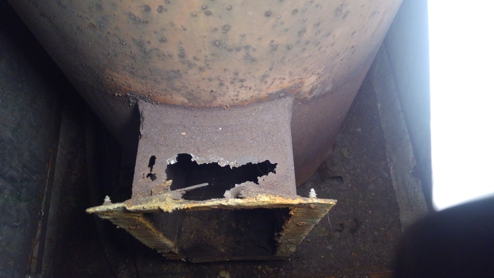

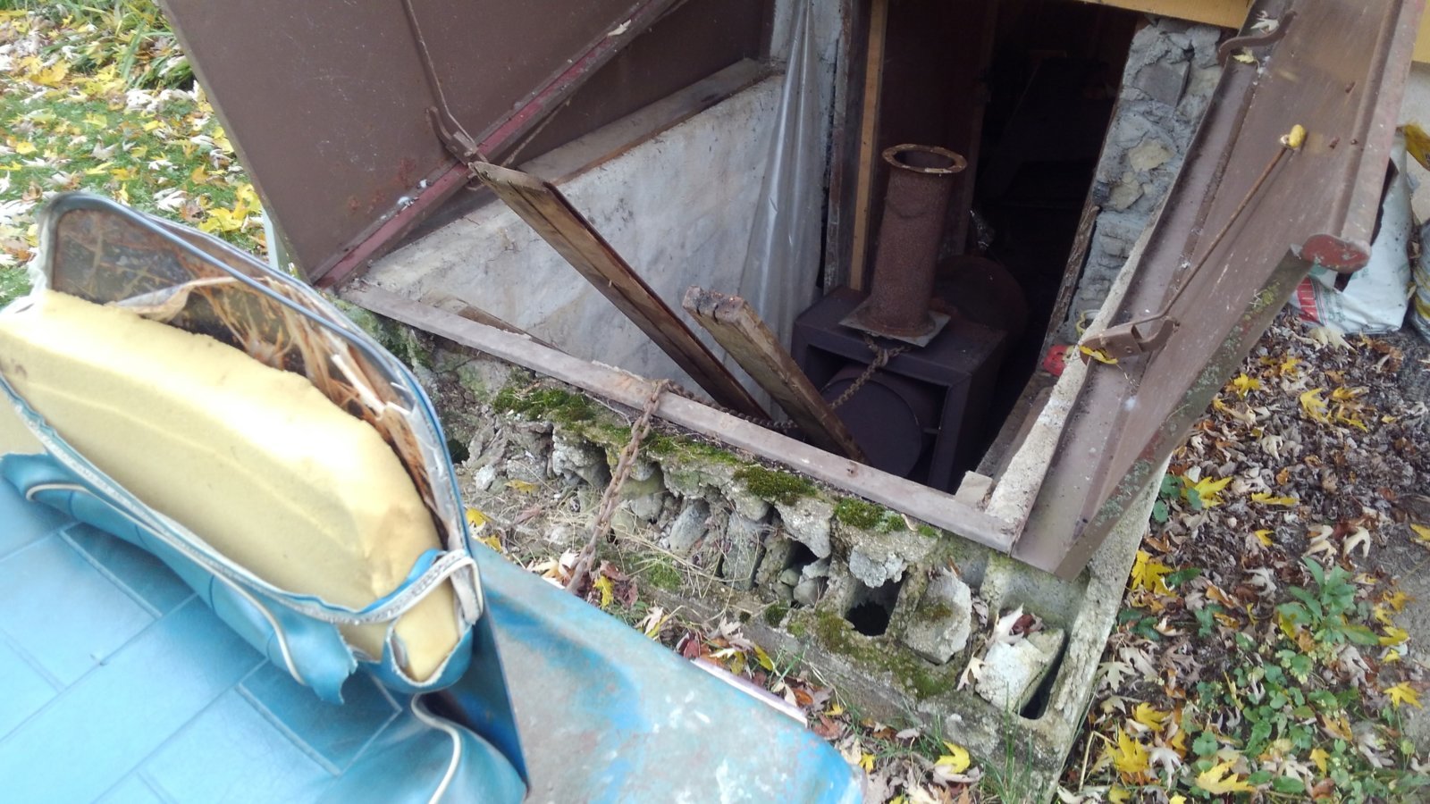

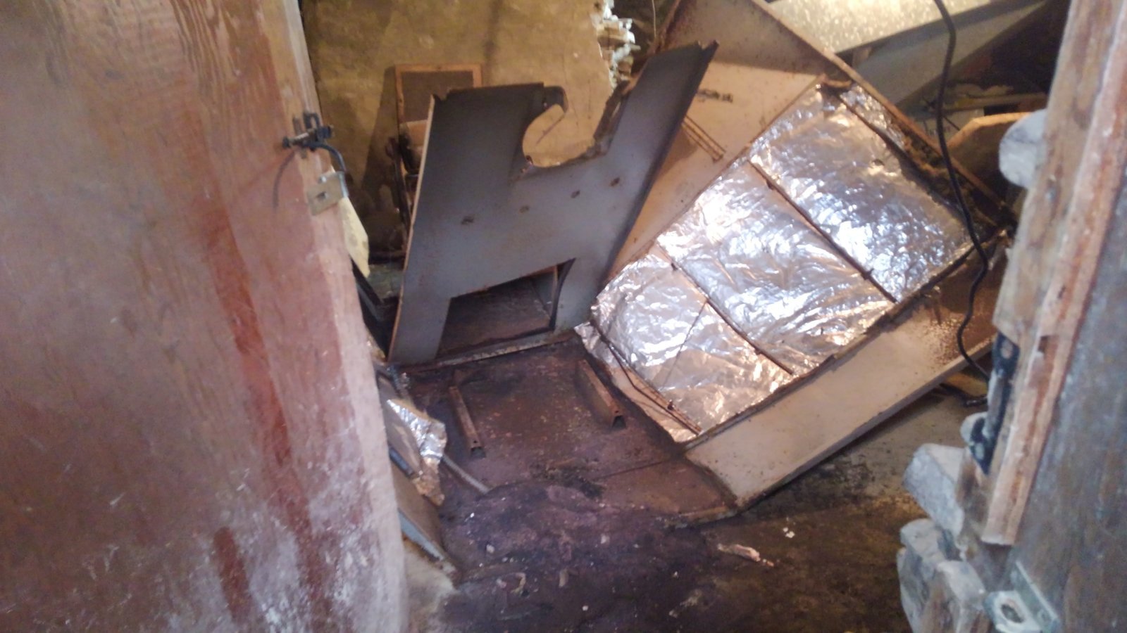

    The furnace ran beautifully, it just smelled like a diesel engine in the house. :confused:
    ...and I think this might be the problem.
    The burner bolted to the flange in the foreground.

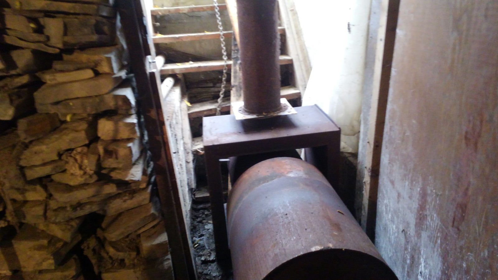

    Here is the heat exchanger, I can't get it up the stairs alone.
    Like most of my home projects it isn't long before I get the old Ford out.
    The old girl didn't even spin a tire.
    I cleaned the rest of the metal up and by then my back was getting vocal.
    More to do another day, the shower felt extra good. :)
    Sad to see the old dinosaur go in a way, it and I spent a lot of (?) quality (?) time together... More importantly I learned a lot about how an oil furnace works.

    It was way oversize for this small house.
    When I moved here I noticed it cycling on high limit - a very bad thing.
    There was a 1 gallon per hour nozzle installed, about 138,000 BTU, the duct work couldn't move the heat as fast as it was being produced. I down rated it to a .6 gph nozzle, around 82,000 BTU and it ran nicely for many years.
    The heat exchanger finally rusted through letting fumes into the house.

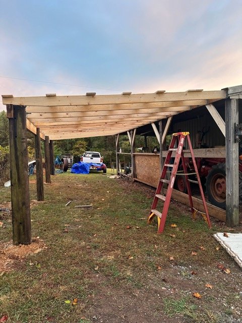

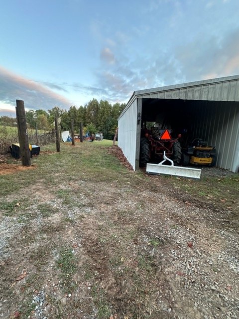

    Been a couple busy days after planting post Tuesday. Now to wire it.

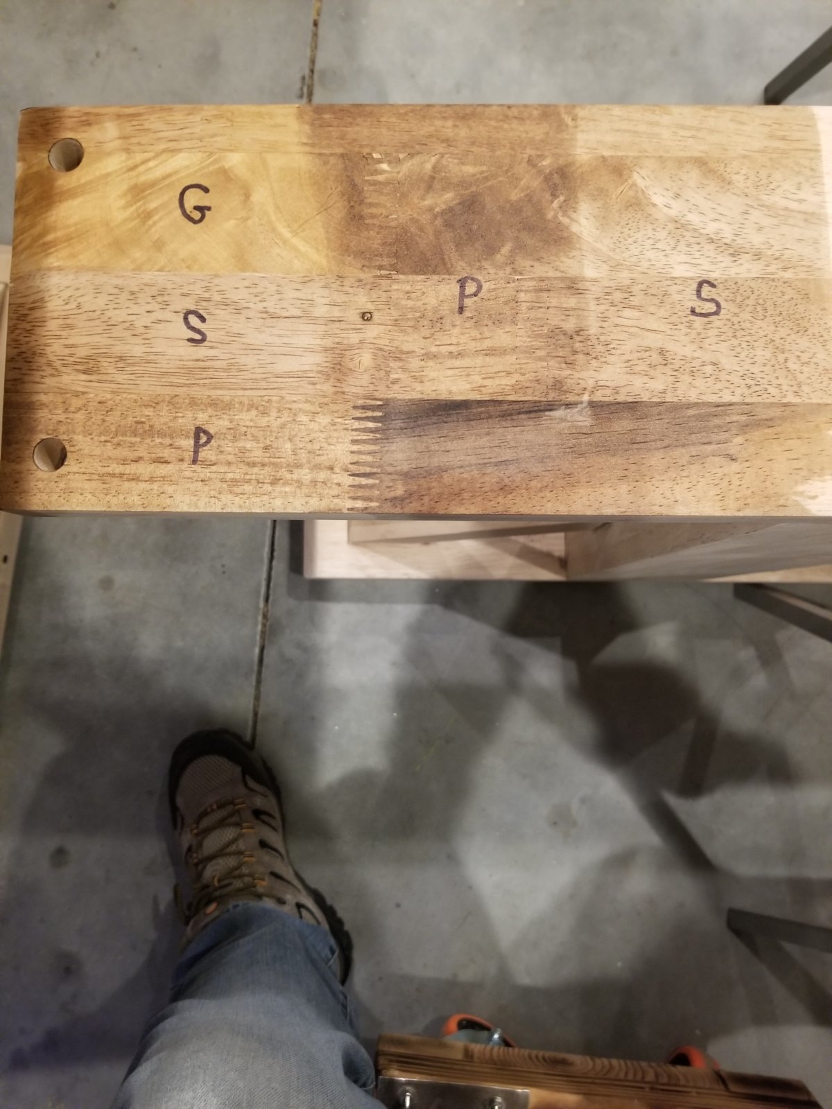

    Leaving a note for future generations?
  15. Oct 21, 2023 at 7:17 PM
    hiPSI
    hiPSI Laminar Flow
    May 21, 2017
    #219544
    12,121
    South Carolina
    2024 Long Tundra
    Testing mixed stain colors on a place nobody will ever see lol.
  16. Oct 21, 2023 at 7:21 PM
    shakerhood
    shakerhood Well-Known Member
    Aug 9, 2015
    #161370
    37,086
    Southern Ohio
    2017 MGM DCSB Off Road, 6 Speed MT, P&T
    I made the mistake once of trying several stains in an exposed area before, took some extra work to cover my mistake.
