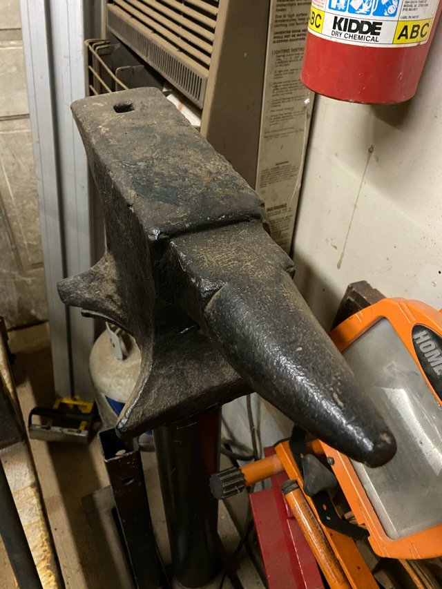

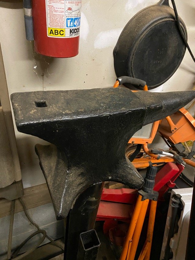

    @Martyinco here it is. 18” long, 9” high. No name.

    Looks heavy.... I don’t know 100lbs heavy... looks like it sits on a stand?

    Yes sir, I made a stand for it several years ago.

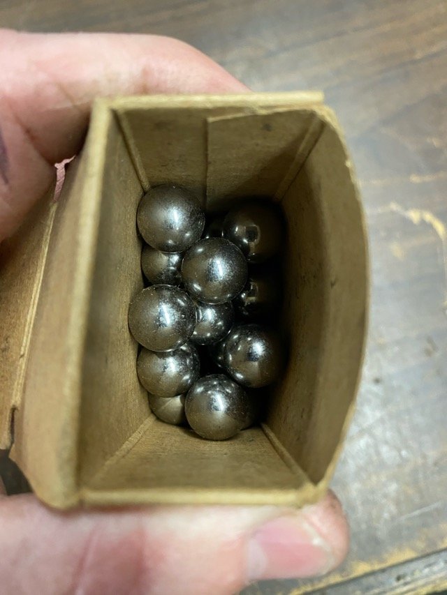

    If you’ve got any 1/2” - 1” ball bearings around the shop I can tell you how to test the anvil :thumbsup:

    Found some 9/16”, please share how :D

    Drop (DO NOT THROW) the ball 10" onto the face of the anvil. Measure the amount of rebound (that number will then be a percentage) and that will give you a rough estimate of hardness. Hard anvils will be 75% and up
