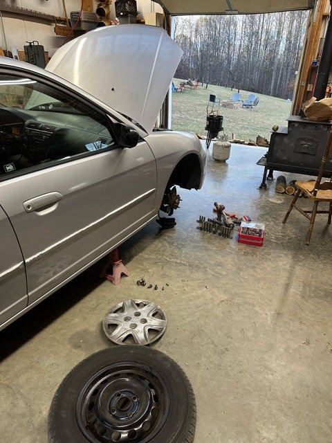

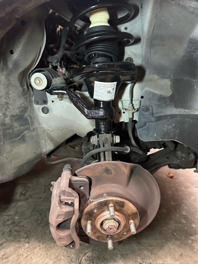

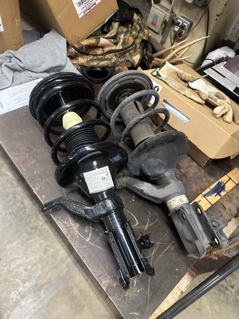

    Hopefully the Honda rides better. Passenger side was leaking. Drivers side wasn’t much better. Gonna turn the rotors while I got em off.

    Honda rotors tend to warp. Just FYI. it’s the heat/wet cool cycling that does it. Thankfully they’re relatively cheap, so I just changed them every 2 pad cycles.

    Yep, had them turned once and it warped pretty quick. I just replaced them with the front pads every time..was cheap enough
