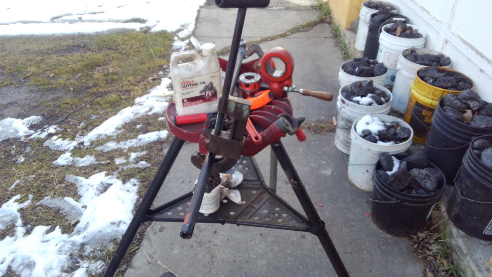

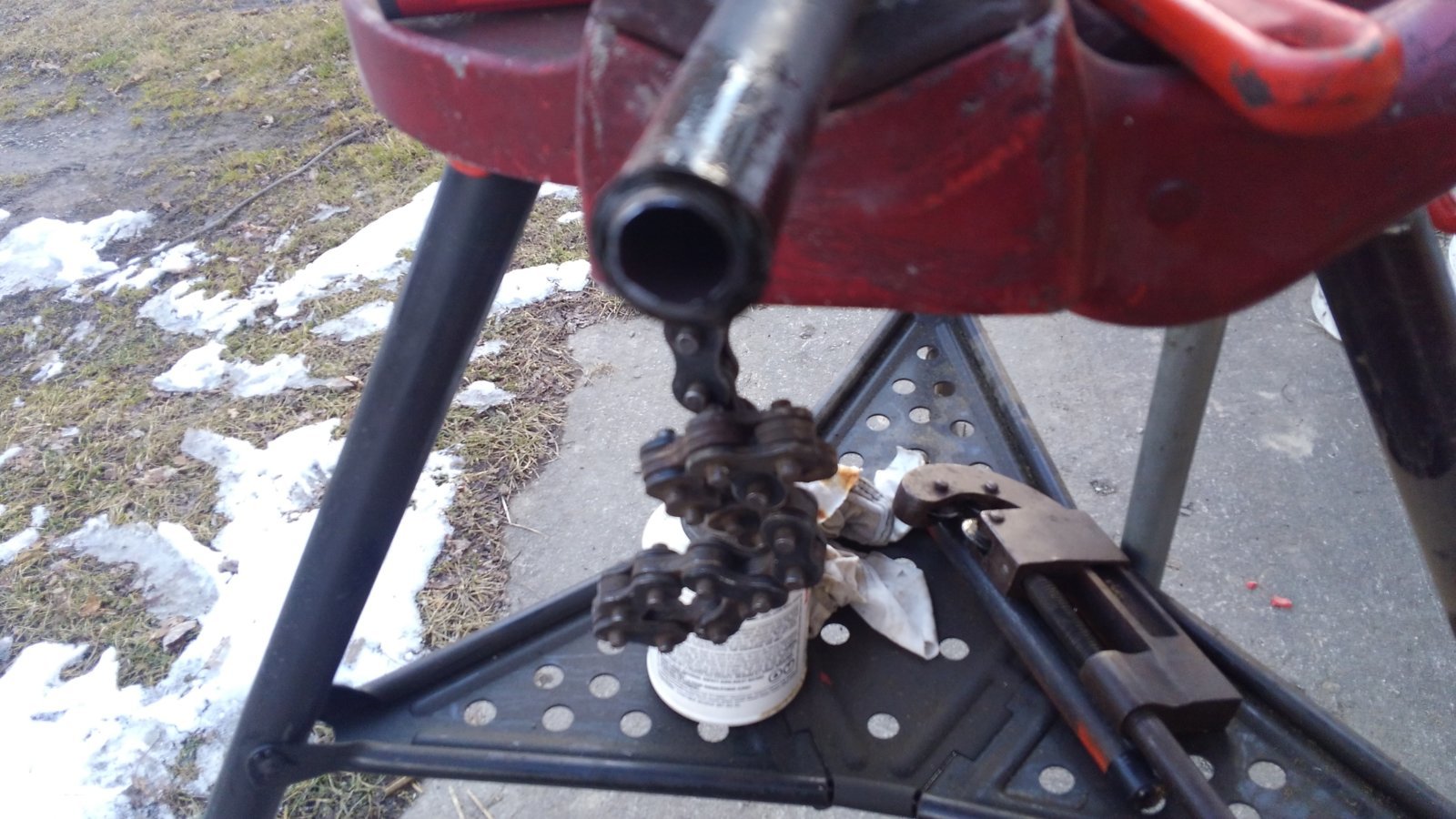

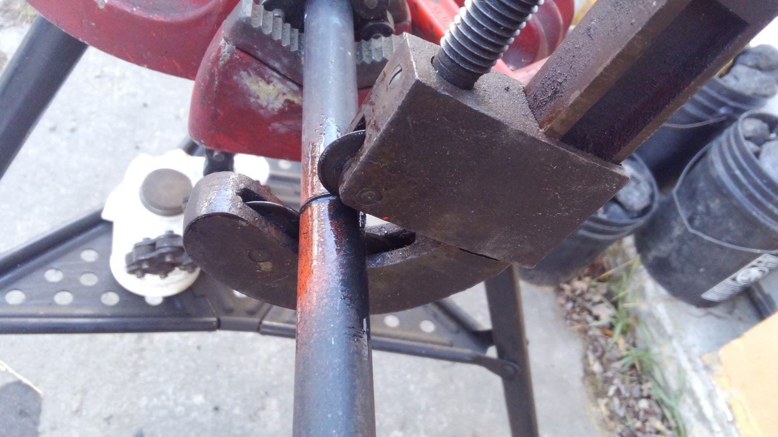

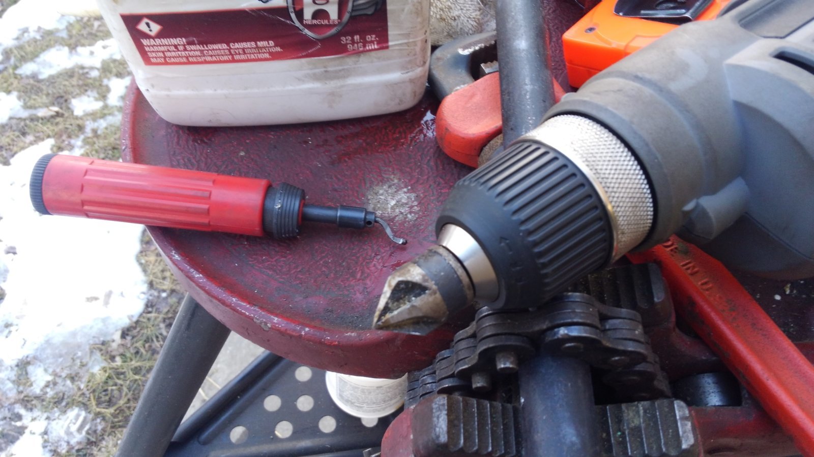

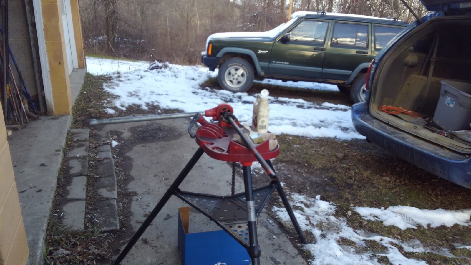

    Florida
    2019 Quicksand Tacoma OR DCLB

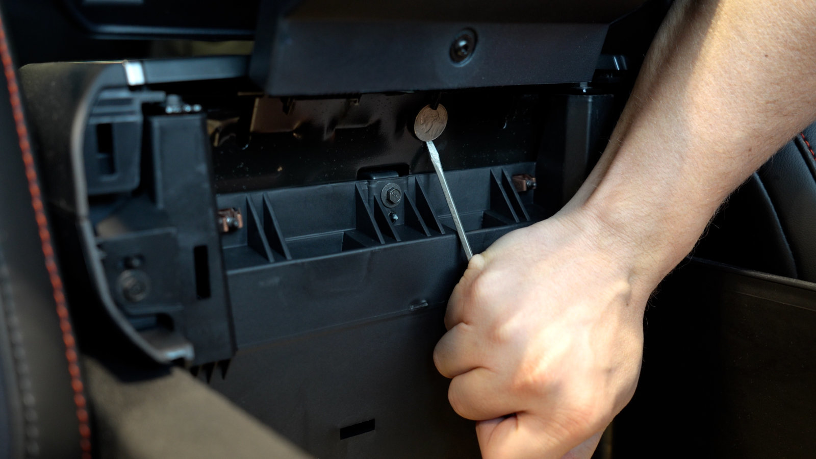

  5. Dec 13, 2023 at 7:38 AM
