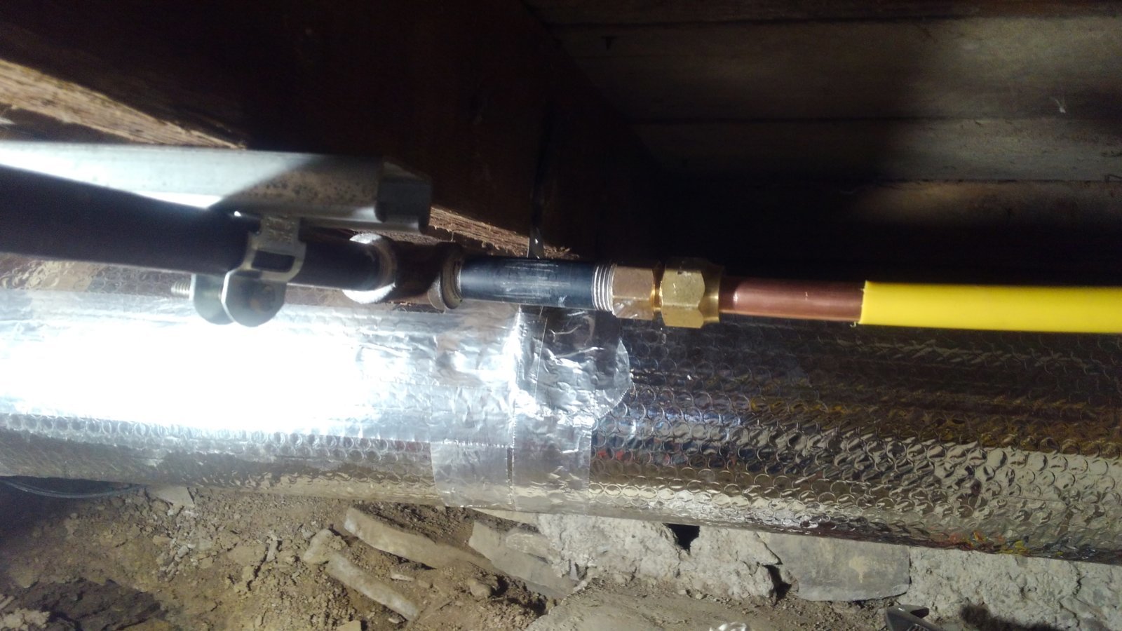

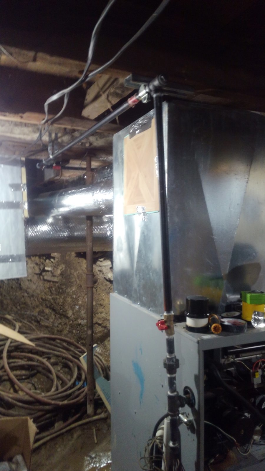

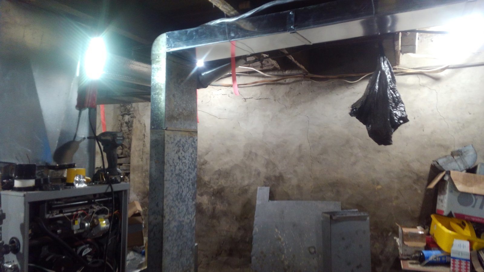

    The black iron line near the furnace is done, this was easier than snaking the copper around all the ductwork.
    o_O Yes, I know the vertical run is crooked -- the natural lay of the pipe coming out of the furnace forced it.
    To pull it into plumb would put a lot of stress on the gas valve - gas valves are fussy & expensive so I'll let it ride.
    We all can't do @Delta09 quality work...
    :boink: :bowdown: :p
    In bigger news, the work on the mud slide side should be done! :woot:
    The yellow coating on the copper line is polypropylene (IIRC), the propane supplier recommended this product for being in the crawlspace.
    Almost $300 for a 60 foot roll...:bananadead:
    Notice the uni-strut clamps on the BI, even though I'm not in industry anymore I still do things the heavy duty way. :laugh:

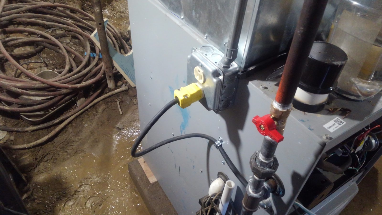

    Power is available.
    Out here in the boondocks the power goes off now & then so I made it easily generator ready.

    Maybe I'm an idiot but doesn't that mean you'll have a double ended male cord with hot prongs?
  11. Dec 15, 2023 at 12:33 PM
    CraigF
    CraigF Well-Known Member
    Jun 21, 2020
    #332105
    1,814
    Craig
    Oak Grove, OR
    06 AC PR OR 4.0L
    none yet
    no, breaker to outlet then a power cord on the furnace that normal plugs into the outlet but cab be plugged into a battery pack or generator if the power goes out
  12. Dec 15, 2023 at 12:52 PM
    RustyGreen
    Aug 12, 2020
    #337468
    14,562
    sleeping in a chair
    2017 AC 4x4 Sport 6M Inferno
    Pavement Princess
    No.
    I put a heavy duty cord and plug on the furnace and mounted an outlet on a dedicated circuit right to the furnace.
    For generator use I would just unplug the furnace and plug it into an extension cord connected to my small portable generator outside the cellar entrance.

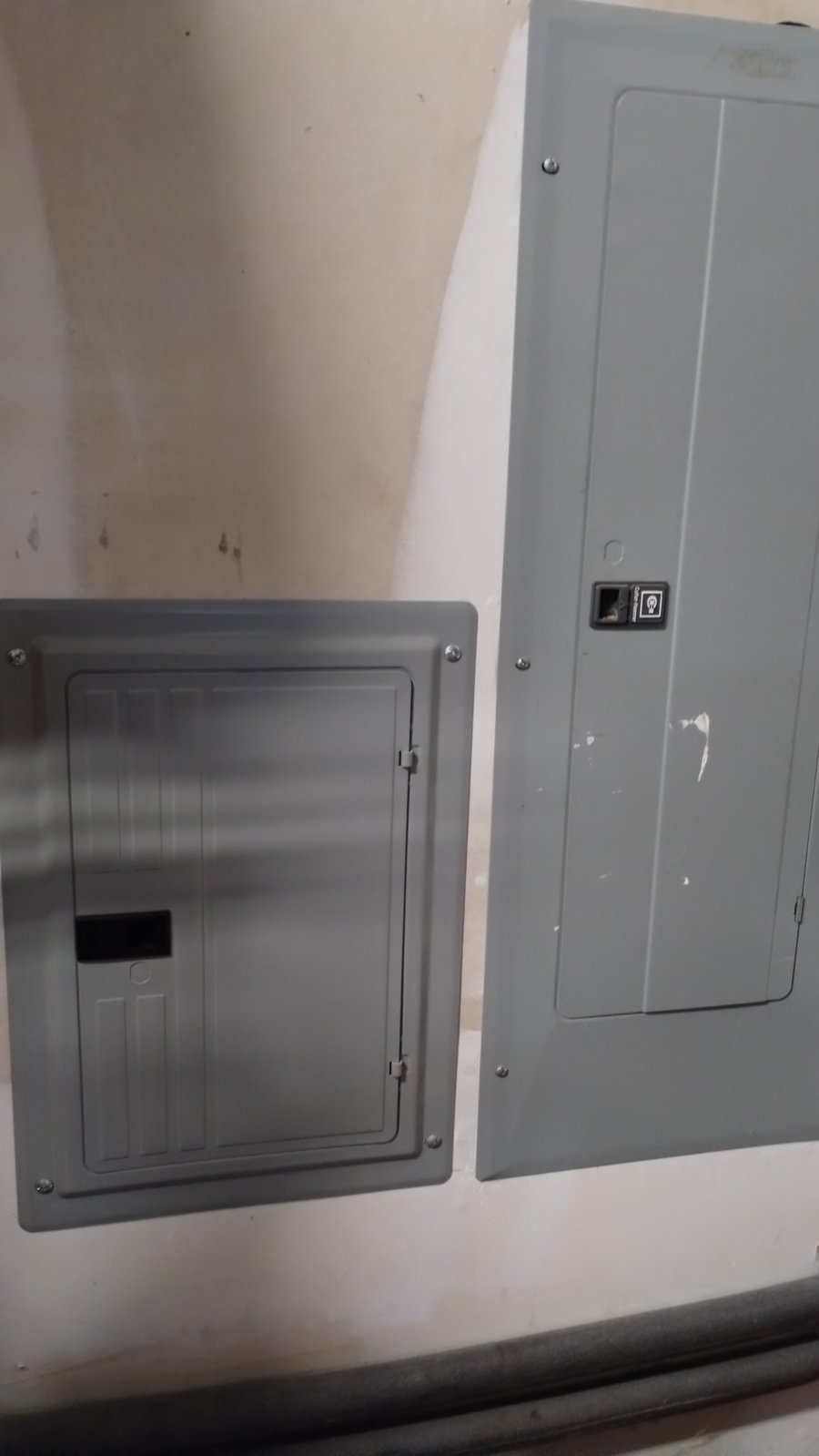

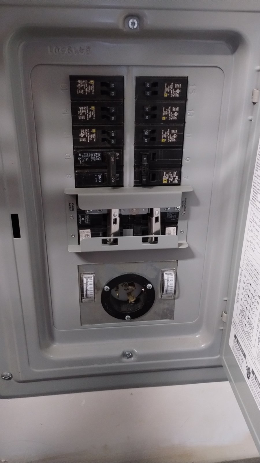

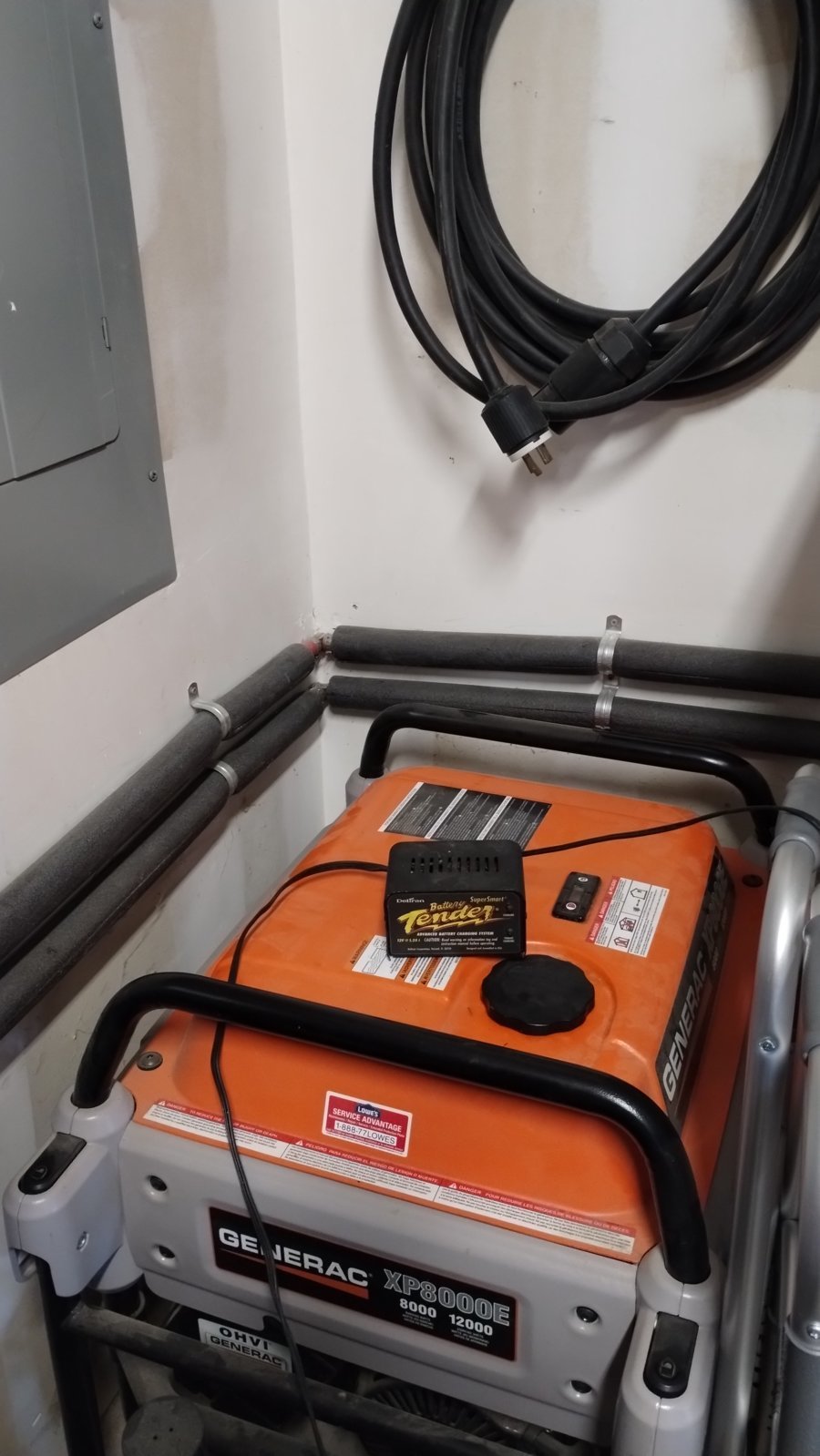

    Setup like this works good.
    IMG_20231215_165103765.jpg IMG_20231215_165113050.jpg IMG_20231215_165208663.jpg
    Generac outside and run cord plug in and throw switch run most of house.:thumbsup:
