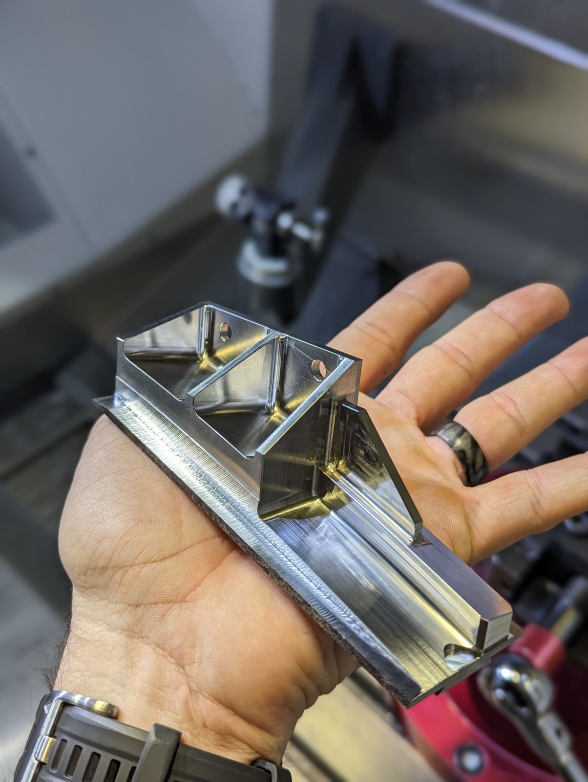

    Been a while... Life and especially work has been challenging and keeping me preoccupied.
    Probably the hardest part of my career to date.. doesn't look like much.. but between the heat treated 15-5, ridiculous feature callouts (that I was able to have the customer's Engineers change/adjust for manufacturing), and constantly trying new programming/tooling strategies (with a lot of broken tools).. I have spent almost 3 weeks on this thing between programming, testing out toolpaths and tools, and finally running an aluminum first article. After we get back from the Holidays.. I'm hoping I can get bought off and run out the 2 pieces they need from the live material.
    Nothing on this part is parallel, flat, or square-to each other. Bottom radius is based off a ~53" Radius. I had to design and make a custom fixture to locate off the 3 datums I established in this Op1. Model/print wall and floor Rads were .060" at 1.250" deep, when the other part family was .125" wall and floor Rads. All 3 surfaces (2x walls that are an acute angle to each other + a radiused floor) had to be picked out. This part shown is with the updated .125 Rads and still has the carrier obviously.

    Seriously impressive. :101010:
    Unfortunately the people in "the office" (non-Wrenchmen ;) ) will never have any idea how much work & time went into "that bracket" that you can hold in one hand.

    I appreciate that! It's really the office guys not taking the time to accurately quote or look over these jobs.. and just letting us find the issues and deal with them once they get onto the floor. Not to mention these part "issues/discrepancies" are coming from a very high tier and well known aerospace company. So when it comes time to get back some things... Now we're on hold for weeks, waiting for the process to finalize on their end, if at all. Having to gather and provide screenshots and info on why the features are non manufacturable or ask why they chose to design 1 set of parts different than the other, etc.

    Nice work! Engineering threw you a hard pitch to hit.
    I will say, wearing my engineer hat, we try hard to never draw something like that unless it is absolutely necessary.
    I work for a German company. When something is engineered over there and we need to mod or source the part over here, the first thing we do is redraw to NA specs so it is not absurdly expensive just because the finish or hardness is misunderstood by american shops because it is a German Spec.
