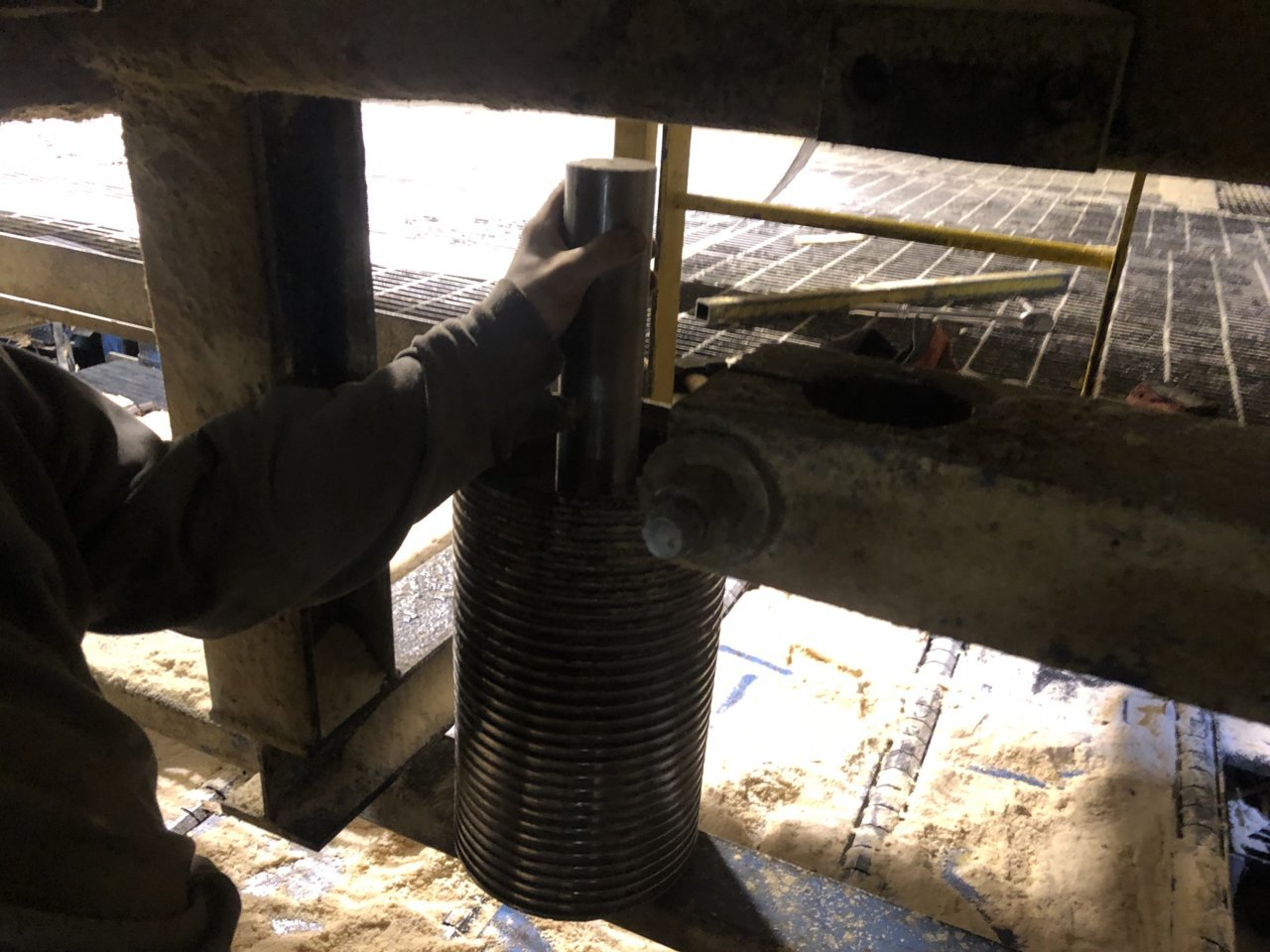

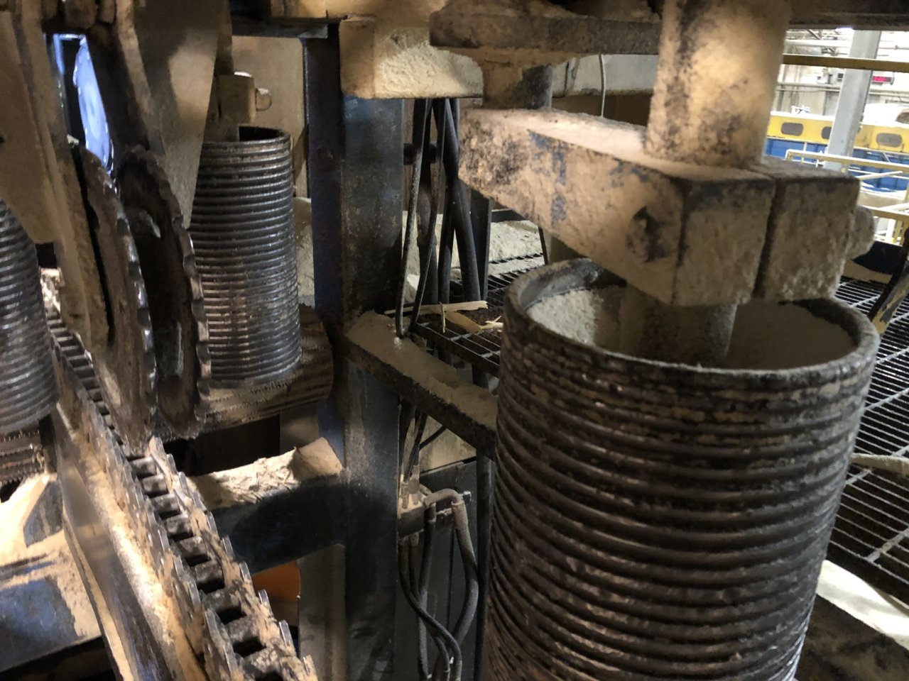

    Fun with bearings in the side rolls of the outfeed today. Skf 6212 sealed bearings top and bottom and the top one seats against a shoulder on the shaft. Spring clip on the bottom keeps the roller and bearings from dropping off the shaft. The shaft is 2 7/16 primarily, and about two and a half feet long. The roll is hollow, but made out of steel so still decently heavy. Altogether it's probably 80 ish lbs. Combine that with just enough room for me to get my body in, and not much else, you get a fun day.
    Tried taking the roll off the shaft, found that the bottom bearing had spun enough to groove the shaft and seize the inner race to the shaft. Entire shaft and roll removal ensues. Then finding out the only spare shaft we have is buried under half a foot of snow and ice up on our junkyard hill. After four hours of mucking about and getting everything cleaned up and back together, it was done. Original shaft was seven thou under at the bottom bearing surface. It'll get built up with weld and turned back down to the correct OD for the next time it has to be replaced. 48F4BFC4-CFBB-49BB-BAEF-DF2C77CBDAE0.jpg14A10219-4ABC-4AB1-B716-AD06D8696CE4.jpg

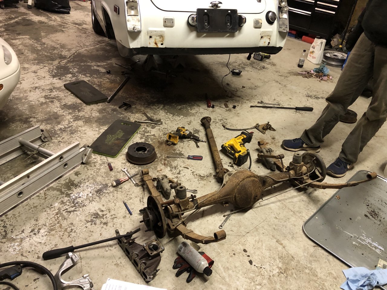

    Up bright and early (for me at least) to make the hour and a half drive from the better half's house to mine and work on putting this back together. 5B422E3E-3F26-42D6-8658-C072F66A61DD.jpg

    That's the entire rear driveline out of the '76 MG Midget I'm restoring.
