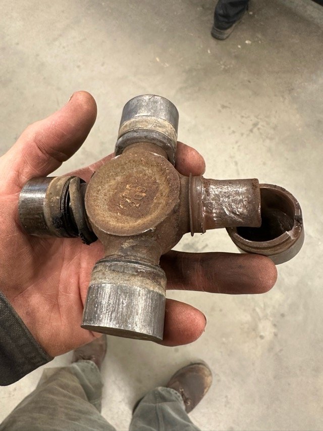

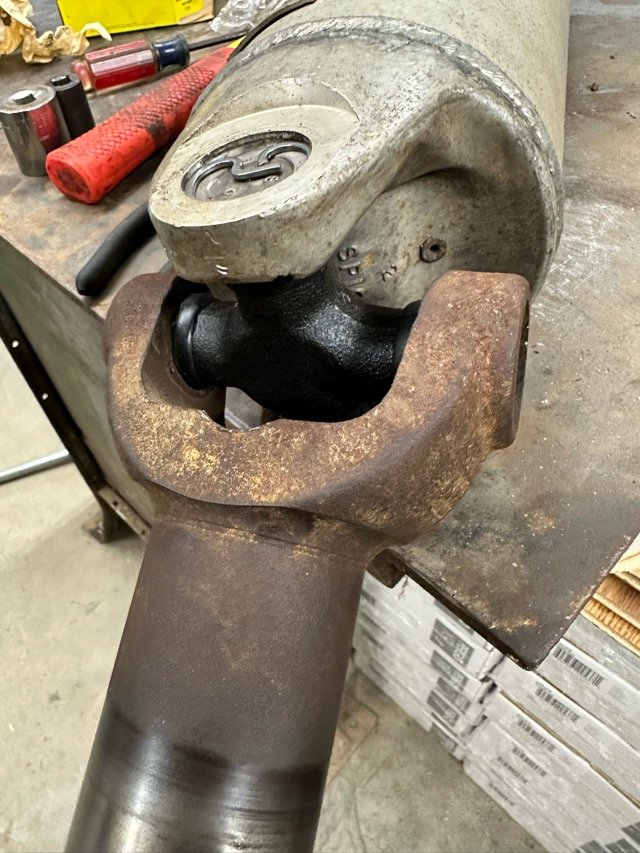

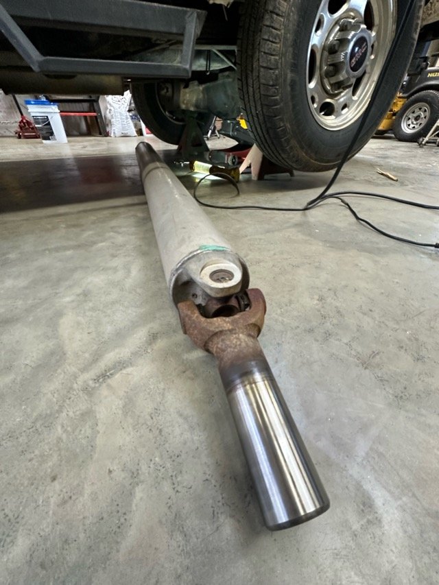

    Looked up which universal joint I needed on O’reilly’s website yesterday, it gives dimension so I crawled under my truck with calipers to verify the right one. Went in and the manger brought be a box with grease all over it and it had been opened. I should have refused it but I didn’t.
    Got mine out and the one I picked up was the small one, I needed the big one. I’m guessing someone swapped it since it’s more expensive and returned it. Who knows.
    Had to drive 30 minutes round trip to advance when I got home to get the correct one. Returned the other one this morning and told them what was up hoping they do something about it so someone else doesn’t get who-dooed.
    Found out why mine was vibrating and started making a noise. Not sure why they don’t put grease fittings on some of them.
    Helped my dad with a many of them growing up with a vice and two sockets. Luckily I have a small press and some sockets. Got Cole to help and learn.
    No more vibration :bananadance:

    That a new/fresh chip out of that ujoint? I had one explode on front before. Was not fun.

    It was like that when I took it out, I’m assuming it happened yesterday pulling that tractor back when it started making noise.
    It had been vibrating but I couldn’t figure out where it was coming from. The drivers side floor board was vibrating and I thought it was the left front wheel bearings. A new hub didn’t fix that but it’s got a new hub assembly on the drivers side :D

    Does new one have grease fitting?

    I can taste the dust puffing out of that cap, where’d all the needle bearings go :rofl::rofl:

    Yes sir, in the end of one of the caps.
