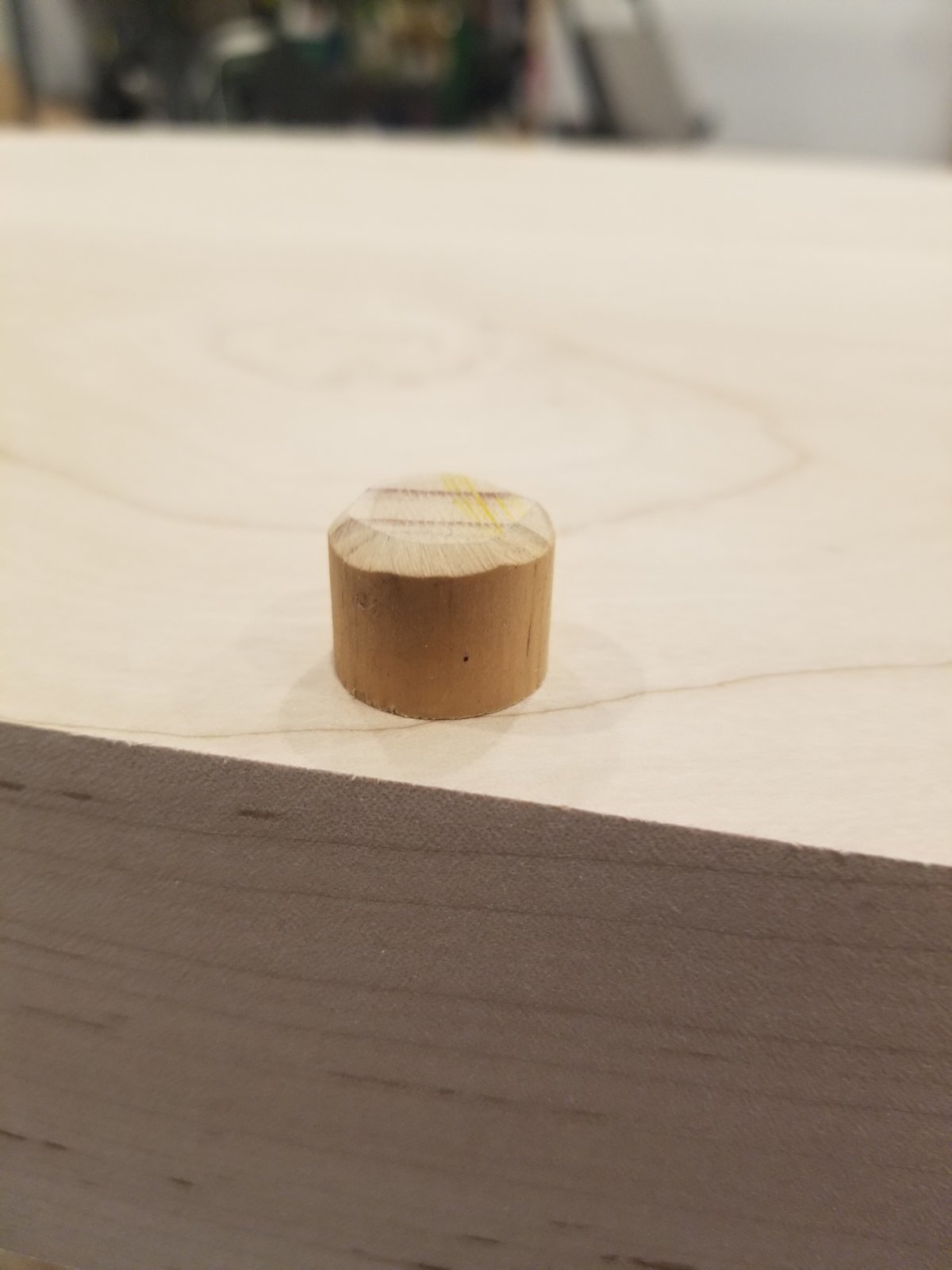

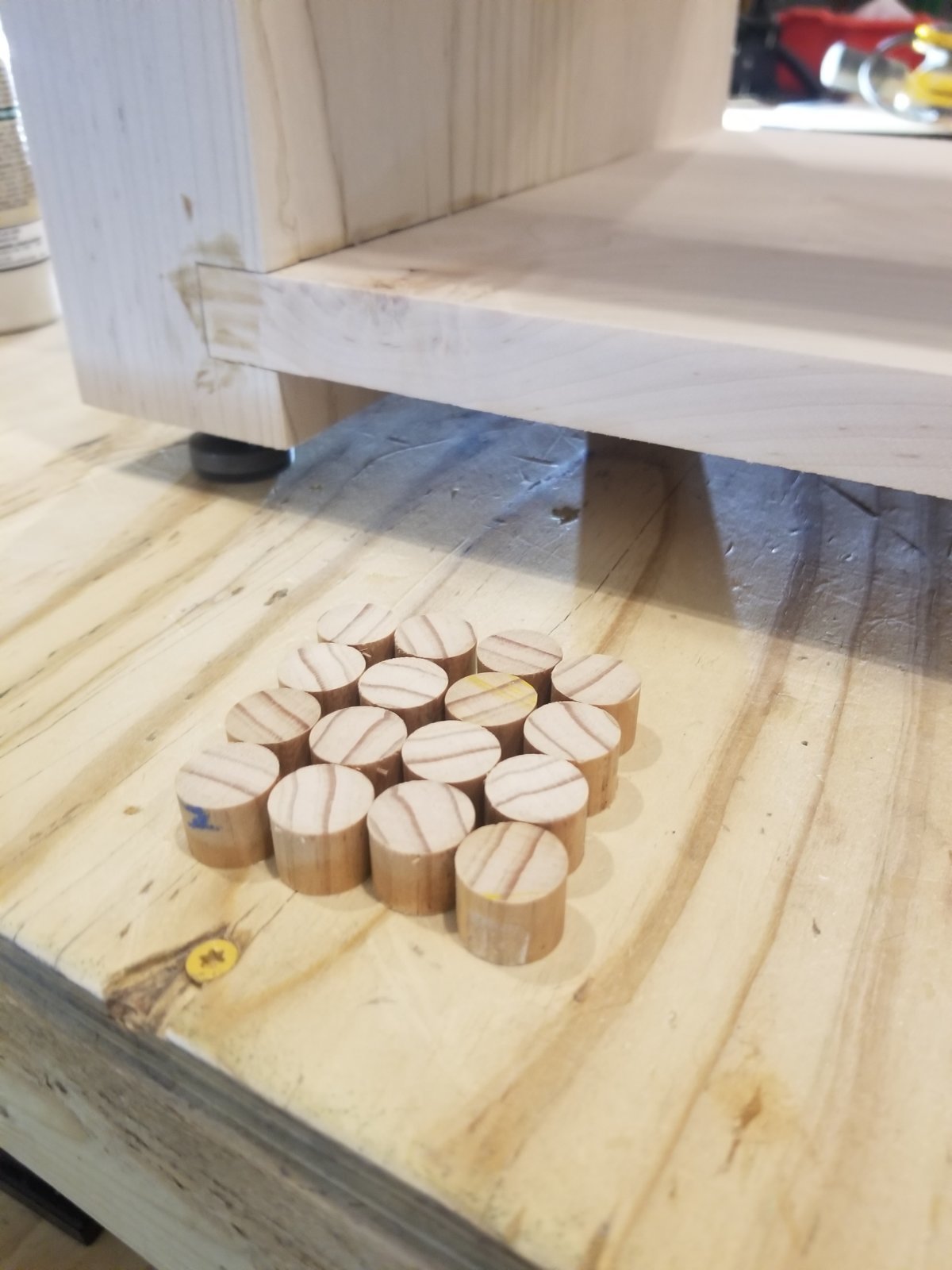

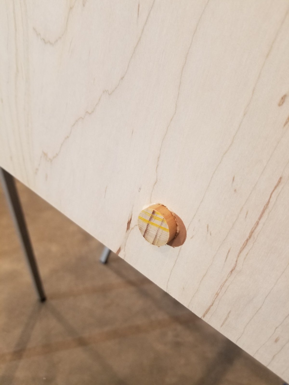

    20240218_211839.jpg 20240218_211926.jpg Stop me if I am going into too much detail.
    I made 16 plugs for this build. Most people think tapering the plug helps with installation, but not really. I can pound in a non tapered plug just as easy. You taper it so there is a place for glue to go and bond with the wood! Why glue them if it is an interference fit you might ask? Because the plug is a different wood than the tables. They will expand and contract at different rates. I tried using plugs without glue...once. Every winter I had to pound them back in. I figured it out after the 3rd winter... anyway, here is a tapered plug and one installed. I will go back tomorrow and flush cut to a 32nd high.and sand smooth.
    Extra credit to those who figure out what I am doing in the 3rd pic.

    Letting moisture content equalize?

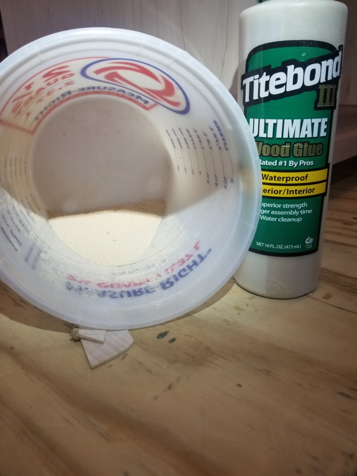

    Lol I am making a sand-able wood filler. Mix the same sawdust as the wood you are working with with glue and you have a stain-able wood filler. Works every tim but you gotta mix it stiff, like thicker than play doh!

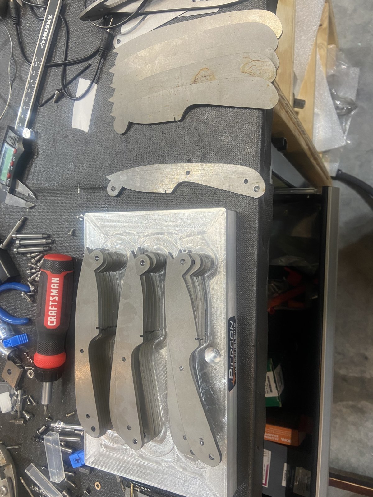

    Punching holes for OP1 on 30 blades. It’s a quick 90 second operation per blade.
