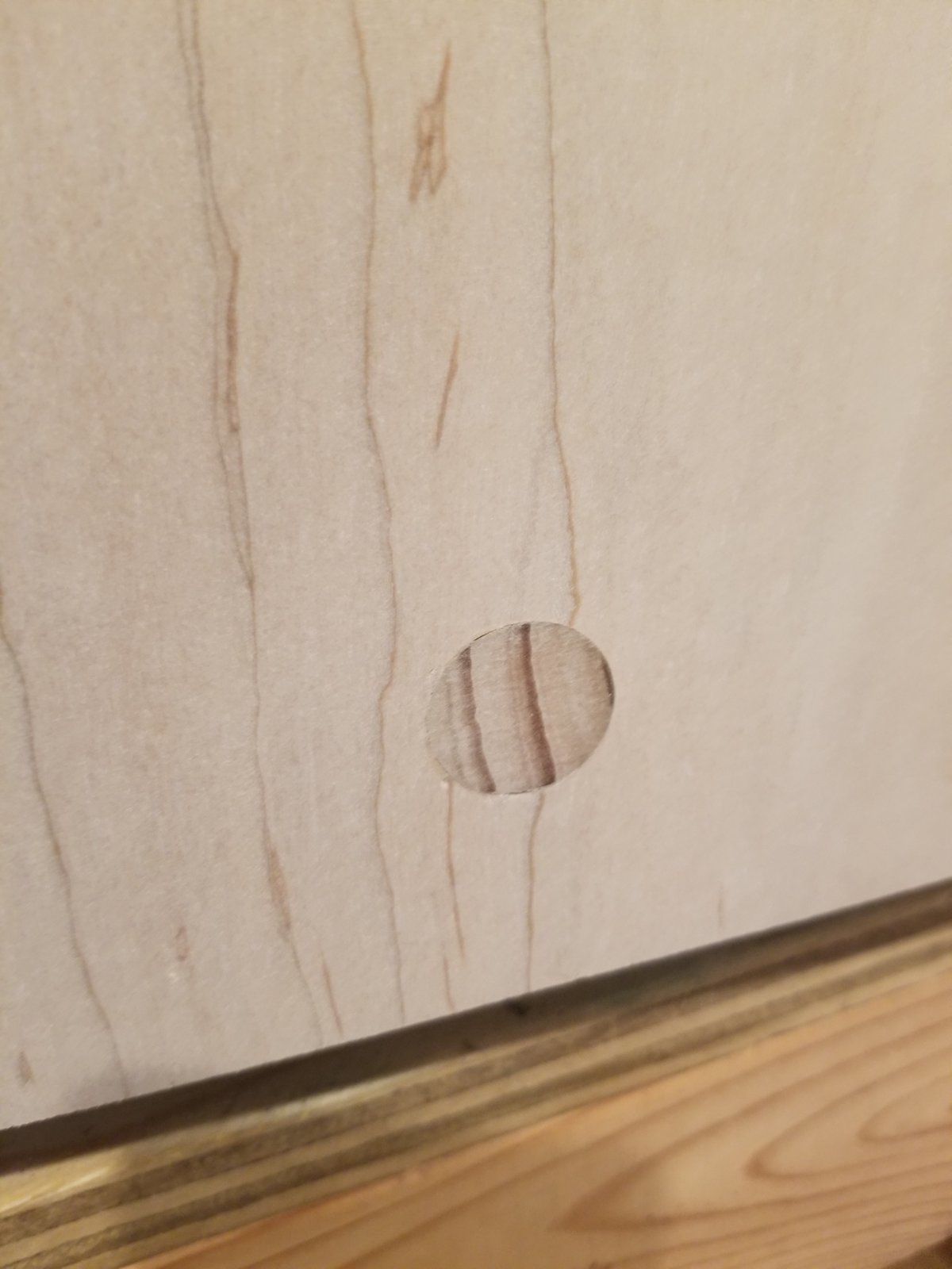

    I suspected your top and it gives a great colorful look! Well done!
    These tables... they are the hardest, most boring tables ever.
    I built them perfectly square yet they did not look square. I sanded and chiseled them so now they are not square but look square.
    When I say not square I mean maybe a 32nd off. But, something this simple requires just about perfection.
    Zoom up on the pic below. That is a three quarter dowel plug. See the tiny gap above and below? I will fill it with my blend of wood putty. Why? Because with a table like this, every error is magnified. I much prefer a more creative and artistic build. I feel like I am building a monolith to go to mars.

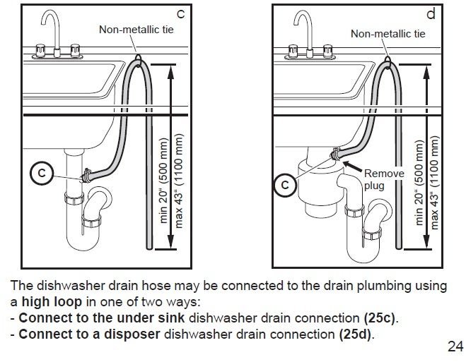

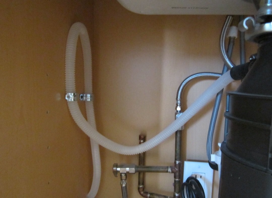

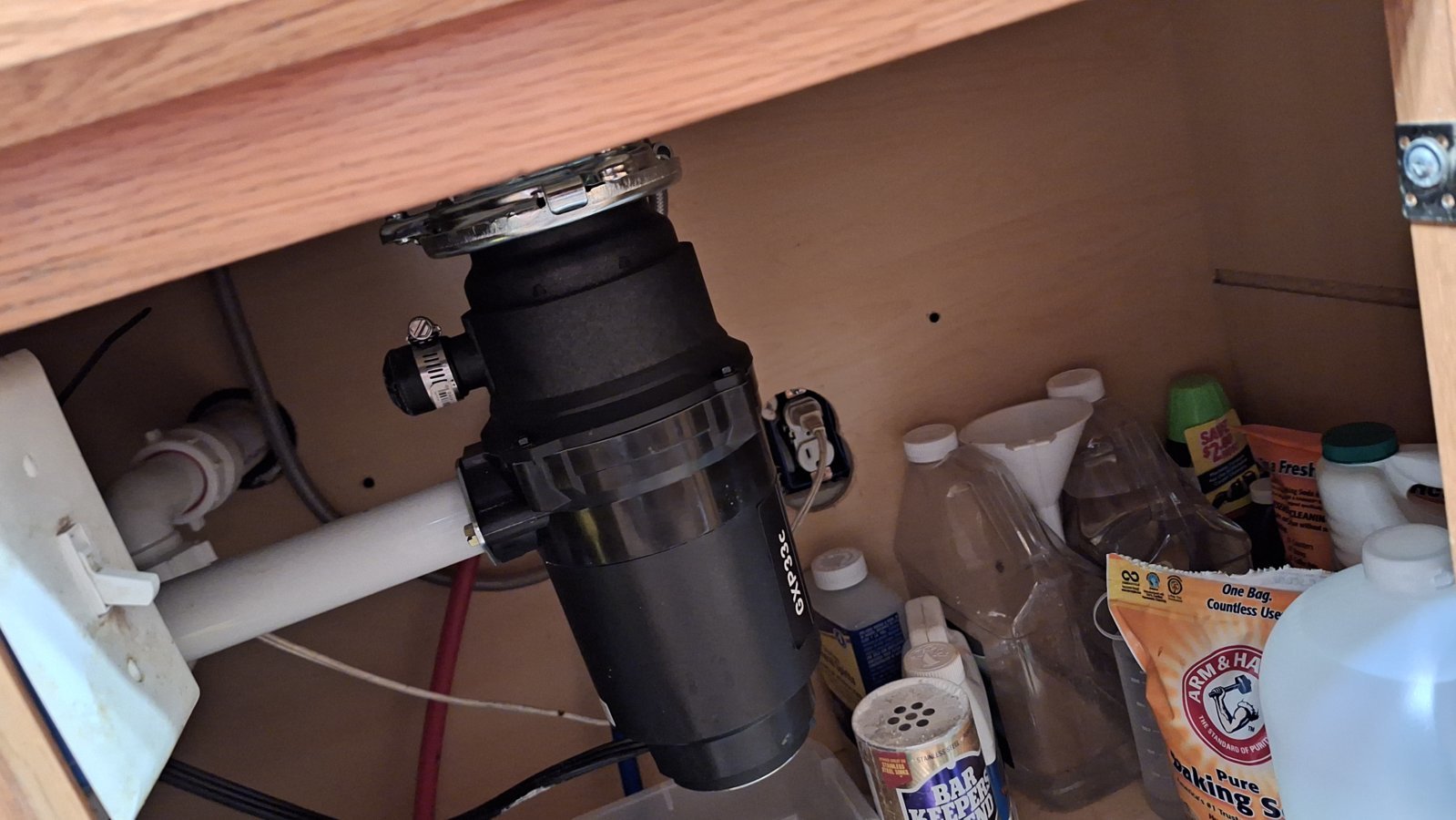

    Well Shop friends, I'm once again asking for your knowledge and advice.
    Got a dishwasher, now it's time to think about installing it. I've never done one. Any tips and tricks are appreciated. It will be a plug in cord not hardwired. And the drain will be hooked to a disposal. 20240219_194129.jpg
  5. Feb 19, 2024 at 6:57 PM
    wilcam47
    wilcam47 Keep on keeping on!
    Jan 27, 2016
    #176243
    54,881
    Will
    Bourbon state
    Also make sure the manufacturers plug is popped out of the disposal. It should be open where you attach the dishwasher line to inside of disposal
    308savage, Hunterdc1, PzTank and 5 others like this.

    Don't make the drain complicated. Every thing follows gravity downhill. Do not over-tighten fittings.
    I just advised my SIL and daughter on site for the same install. Today's fittings are hand tight, not wrench tight.

    I do tend to put the gorilla tight on everything, so I'll try to be very careful :anonymous:

    Just remember to remove the knock-out plug in the disposal. Some people forget that and wind up with water all over their kitchen.
