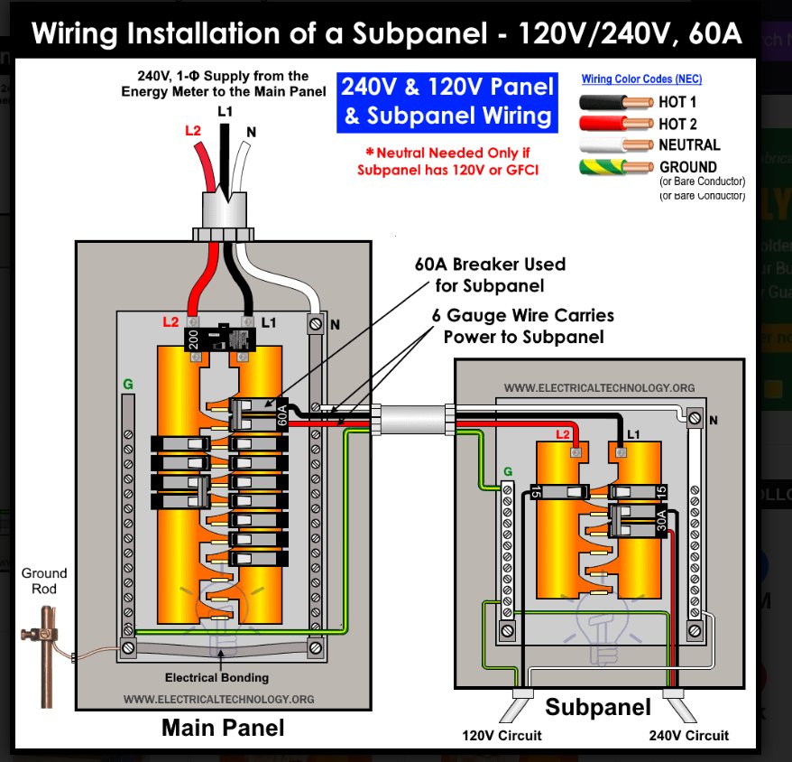

    It looks like they ran a proper 4 conductor cable to the barn but the AC circuit is only a 3 wire without a neutral. This is fine for the AC unit as it runs on 240 volts (L1, L2, G) and a neutral isn't needed.
    The barn circuit however should be 4 wires with the ground & neutral isolated in the barn panel and run back to the main.
    Can you run a new circuit (4 wire) from the main and make the splice in a weatherproof junction box nearby?
    Notice how in the illustration below the ground & neutral are bonded together at the main (left) and isolated from each other in the sub-panel (right).

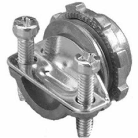

    What @RustyGreen said BUT you need to get a clamp, something like this to keep the wire from rubbing. The heat/cool cycle makes it move a little bit. This will stop it at the contact point against the box.

    without going into detail with all of the things that are wrong here, the easy solution would be to buy a UF splice kit, and fix the piece of UF (tan wire) you're having an issue with. A future issue will be avoided if you get an outdoor rated UF connector to put into that box. I'd also take that copper ground that's just wrapped around the aluminum ground and find a better way to attach it to the box or ground lug, the way its done there is asking for trouble.

    Right idea Shane, those are for indoor use, this is an outdoor rated one. either one would fix the chafing problem from happening again.
