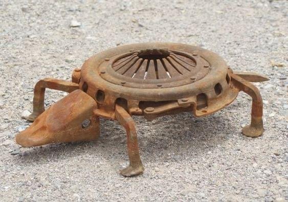

    Cool use of scraps.

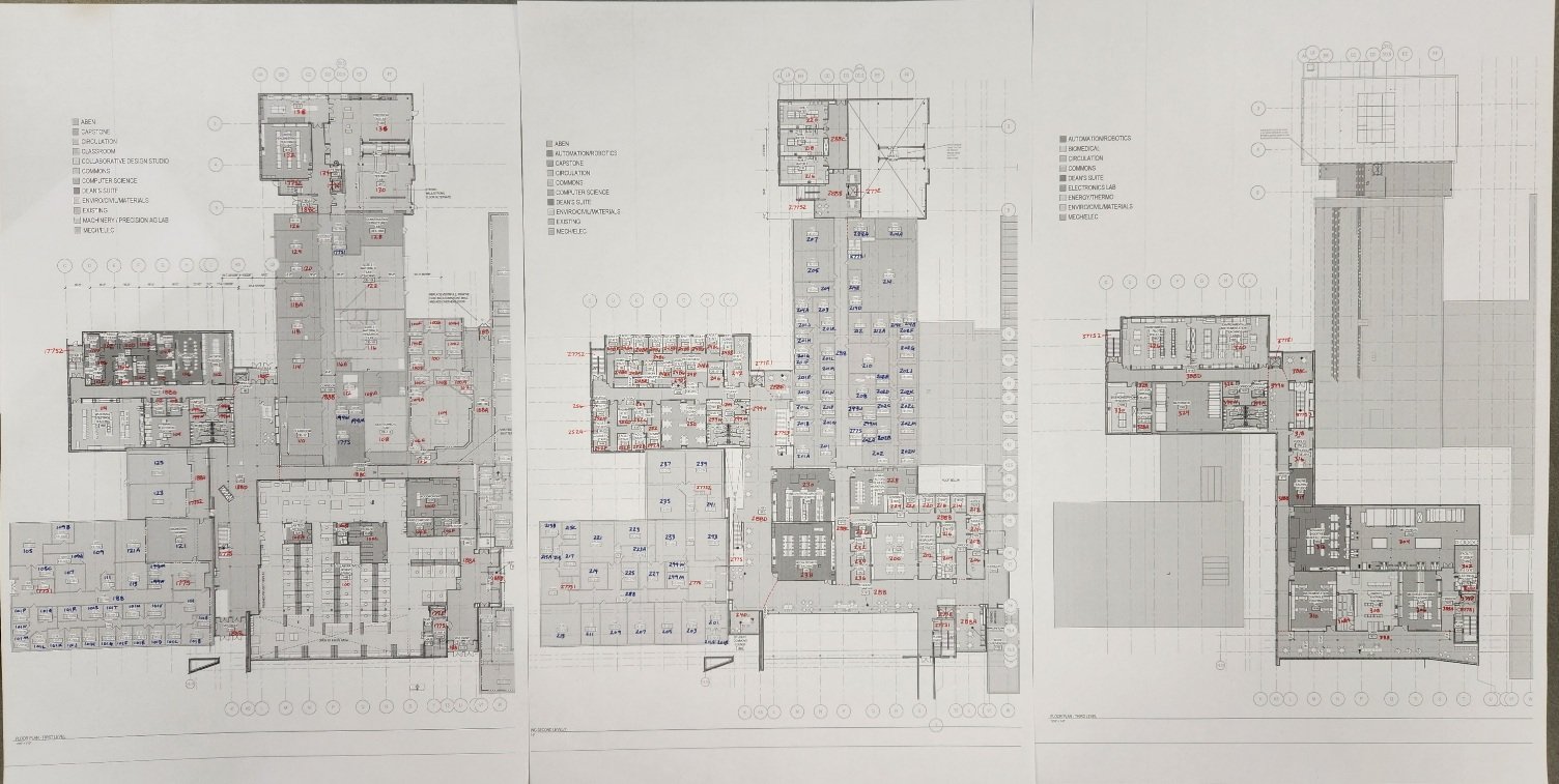

    Finally done.
    Red is new or changed room numbers, blue is existing, unchanged numbers.

    Aaaaaand I was just informed they're changing the floorplans. :rofl:

    As long as it's not the floor numbers you should be ok

    I will not be ok.
    If they make any changes, I'll have to redo them. Now that I have a basis figured out, adjustments aren't usually too bad to incorporate.
    This is the (admittedly horrible but no one else could come up with anything better) path I used for numbering the other building that's breaking ground soon.
    Once that was done, changes just fall into place.
