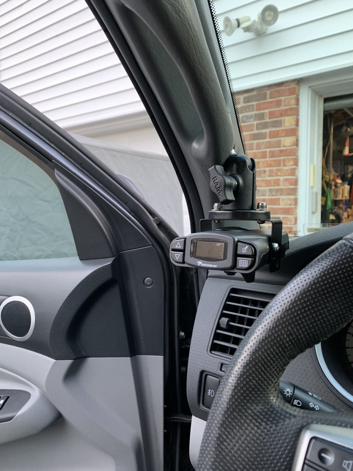

    Got my brake controller mounted, hopefully get it wired up tomorrow

    Did you get the plug and play harness for it? If so its a simple install, the factory controller harness plug is in the left kick panel. It's way up in there. It took me awhile to find mine, but it was there.

    Yep, plug in each end and run the ground wire, then try to tuck the cable out of sight best as possible.

    I'm not loving the controller location.
    Unless you are running multiple trailers loaded and unloaded, you won't be adjusting the P3 much.
    I have the same unit. I adjusted it for the RV 3 years ago. I haven't adjusted it since. The only time I touch it is doing a brake check before I connect the RV.
    Just seems kinda unsightly in that position.
    Just my opinion.

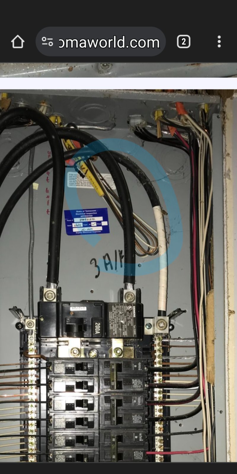

    Looking at the pic of the main panel, I'm betting this unterminated wires are in reference to your notes.Screenshot_20240221-223019.png

    Ok, I see it now. I'm going to have to find the other end of that. If it in the same space as the heater, it would be just a few feet above that A/C fuse box. I'm wondering if I could use it to extent out to the barn?

    The spare wire is only a 2 conductor.
    12/2 = 12 gauge wire x 2 - there will be a black, white and ground.
    Your barn circuit is 4 conductor:
    L1 - black
    L2 - red
    Neutral - white
    ground - bare copper

    What's the L2-Red for? The barn is only a 120v circuit, I'm familiar with Black, White and Copper ground. But I've only seen Red when making a double switch light connection.
    Edit: I know the wire going to the barn has a red, but I don't get why it needs it.

    For 120v it doesn’t need the red and black, if you could use the 12/2 out of the panel you would just hook up the black, white, and ground, and not use the red. 12/2 is good for 20 amps. It’s hard to say if the red wire is being used in your scenario, but the installer could have split the conductors, and used red for one circuit and black for another while sharing a neutral. You’d have to take the box in the barn apart to find out.
