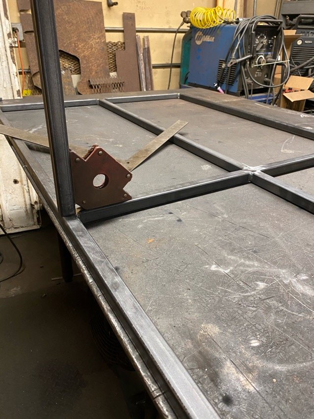

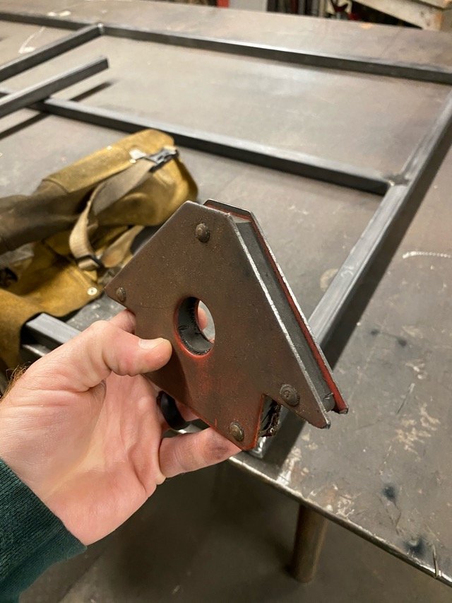

    It hit me this morning this would be a good job for a magnet square. I knew we had one somewhere, found it under the welding table :eek:

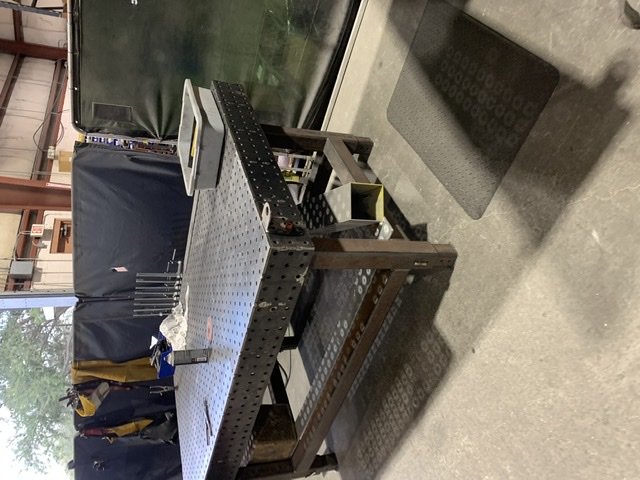

    Good morning Creed!
    We just fairly recently switched to some jigging tables and it was a bit of a transition, but they seem worth it in the end. We do a lot of lower quantity production jobs and it’s nice to not need to build a fixture for repeatability.
    Rule #1 was NO WELDING TO THE WELD TABLES!!!! :welder:

    Damn, thats smart. If only glass was magnetic lol

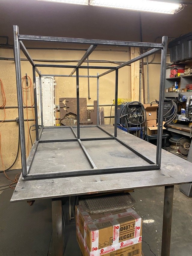

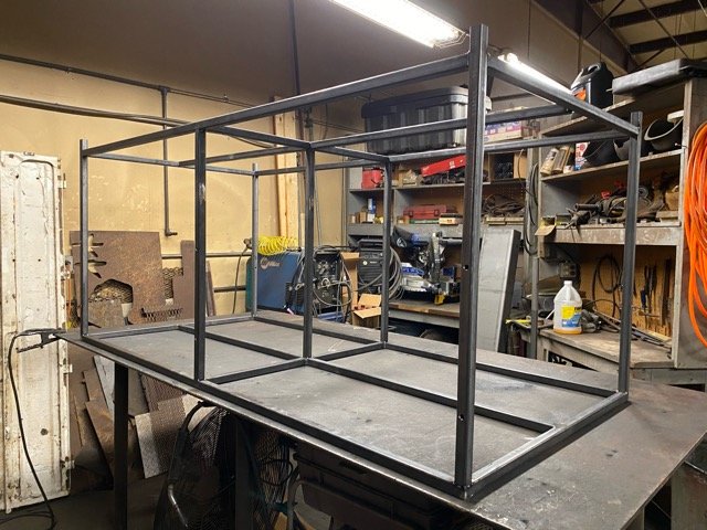

    Got it tacked together, now to turn it over and make sure I made it to the print before burning it in.

    I’m just waiting for @McRib to come here and see the box of McNuggets under your welding table. o_O

    There’s actually 2 boxes but don’t tell anybody.

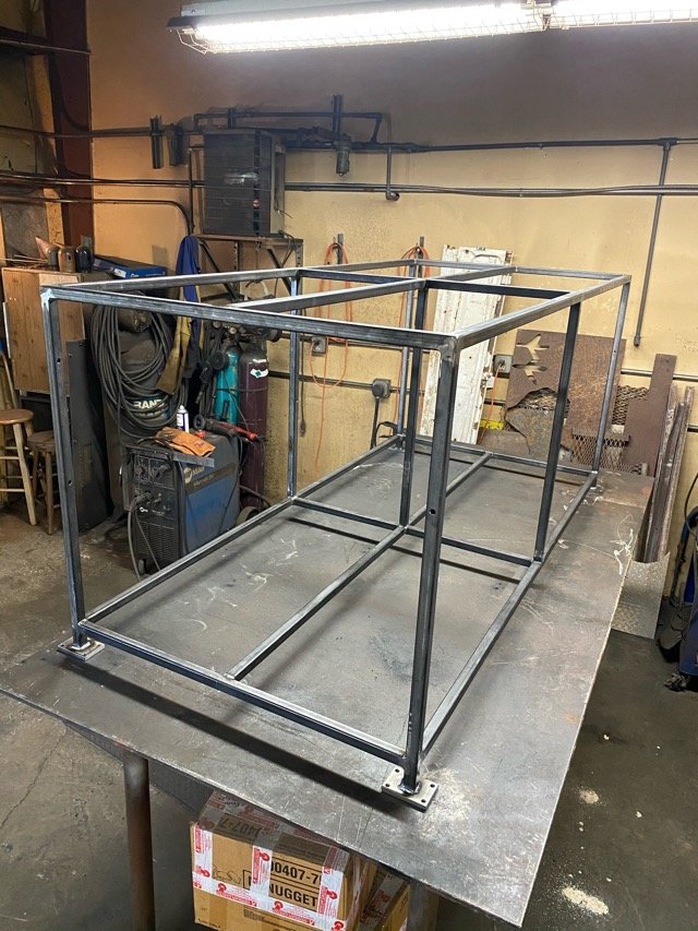

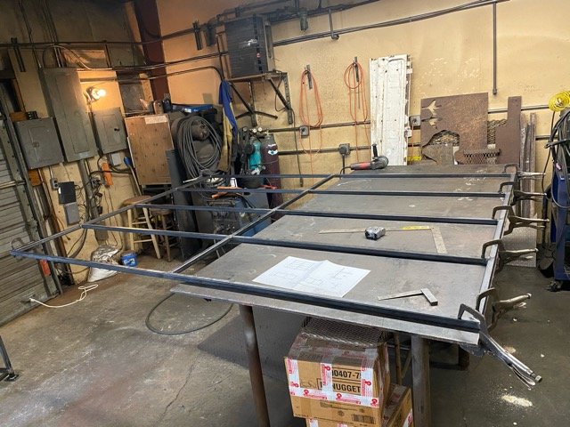

    1st one is almost done, now for the biggest one.

    Ohh those the new spicy ones?! Mmmmm

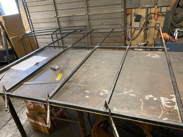

    Told y’all that 1st one was the small one :eek:

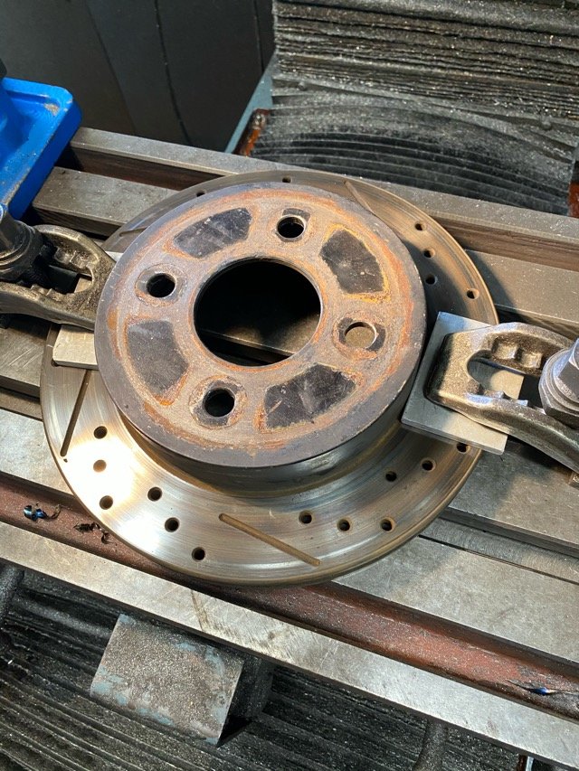

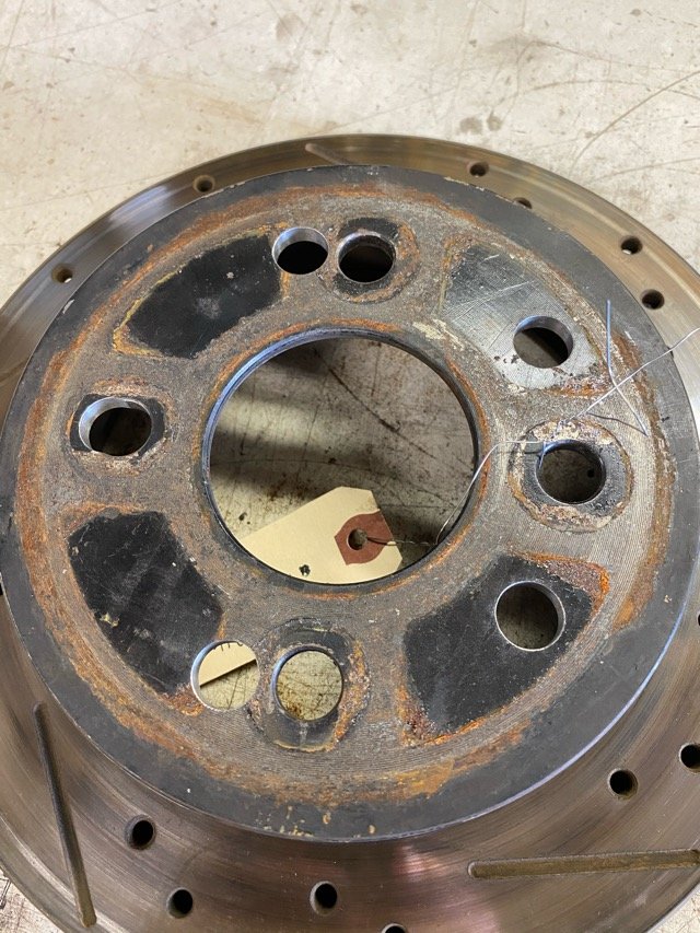

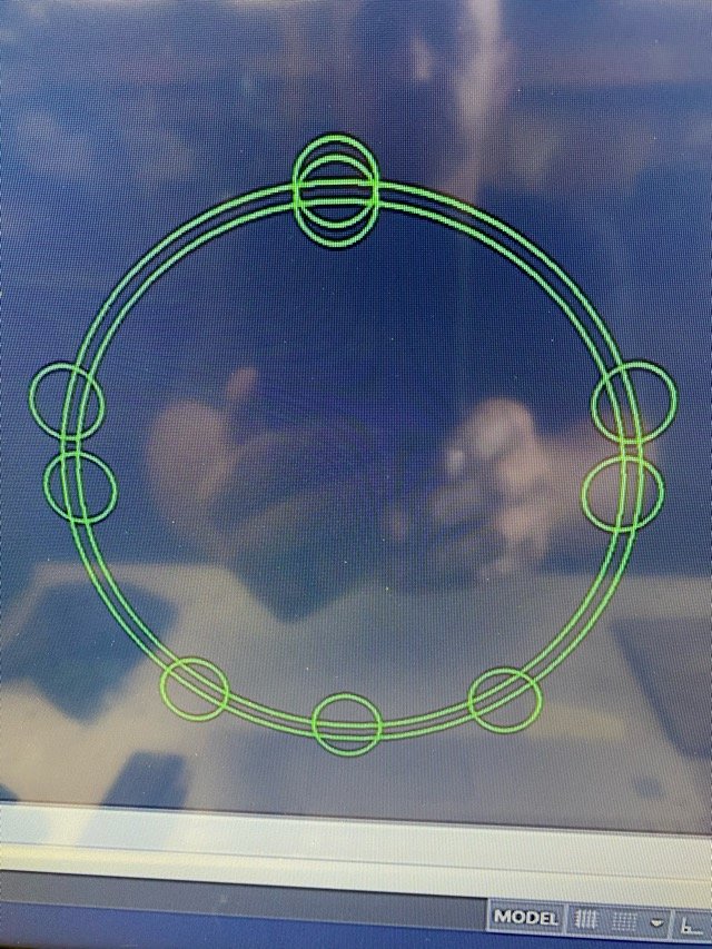

    Customer brought in two rotors with a 4 on 4.25” bolt circle. He wanted them 5 on 4.5”. Drew it up on cad to show him no matter how we lay them out one will interfere. He said he didn’t care, do it. They may be a tad out of balance now.

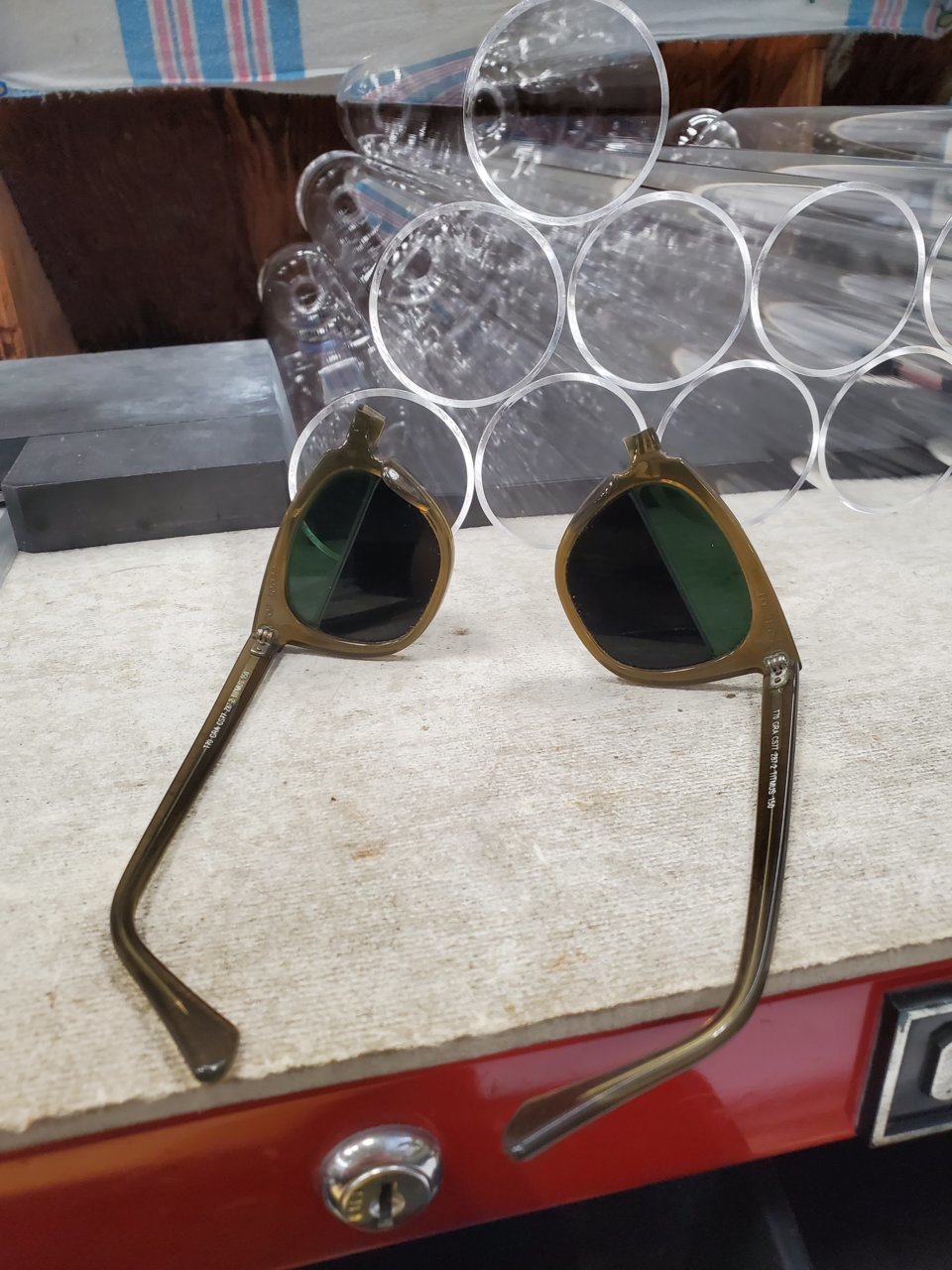

    I know a guy who could probably make you some new frames out of glass :D

    Hmmm... interesting.
    I am curious how your machining charge compares to a new set of (correct) rotors.
  17. Sep 23, 2020 at 12:05 PM
    #857
    CttAznRanger
    CttAznRanger Crazy NE Asian with the Cali Lean (temporary)
    Dec 3, 2018
    #274702
    4,757
    Brandon
    Boston, MA
    2018 Tacoma TRD Sport
    I hope this person doesn't come back when something goes wrong...
  18. Sep 23, 2020 at 12:41 PM
    #858
    six5crèéd
    six5crèéd [OP] Be the light
    Jul 9, 2019
    #298734
    36,231
    Southern Virginia
    8 lugs no plugs
    Boss man told him we weren’t responsible, he’ll make him sign something when he picks them up.
  19. Sep 23, 2020 at 12:42 PM
    #859
    six5crèéd
    Jul 9, 2019
    #298734
    36,231
    Southern Virginia
    8 lugs no plugs
    I would have bought correct ones to begin with :D
