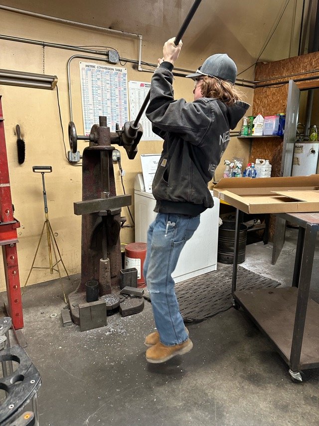

    Cole said can I try to press that bushing in? I said sure :rofl:
    It’s a .004” press fit, bronze into steel :D

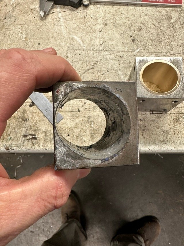

    Customer wanted me to bore this piece out and press this bushing in, I said it’s already too thin. He said can you make one?

    At the way back job I worked with a fellow about 6'2" but only 140 pounds.
    I walked up one day to find him swinging on a pipe wrench in mid air.
    Well, I had over 100 pounds on him and just reached up and pulled on the wrench with one hand loosening the fitting. :rofl:

    Tell him, the leverage comes at the end of the bar...:popcorn:

    I generally shoot for .001” press fit but my boring bar was bottomed out and I didn’t feel like switching setups since it was bronze and I knew it would fit.

    Do you think that hole on the old part was bored so far off center on purpose?
