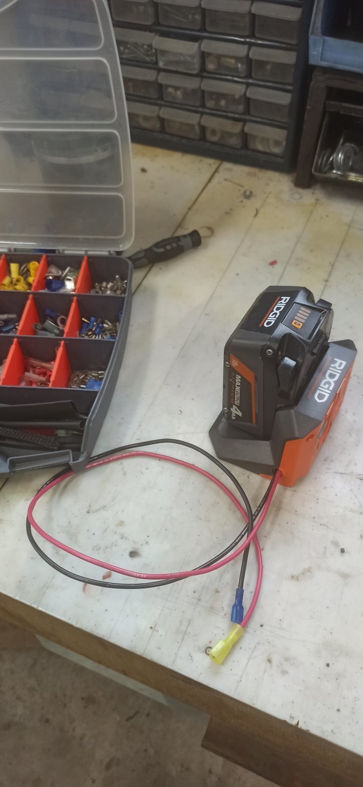

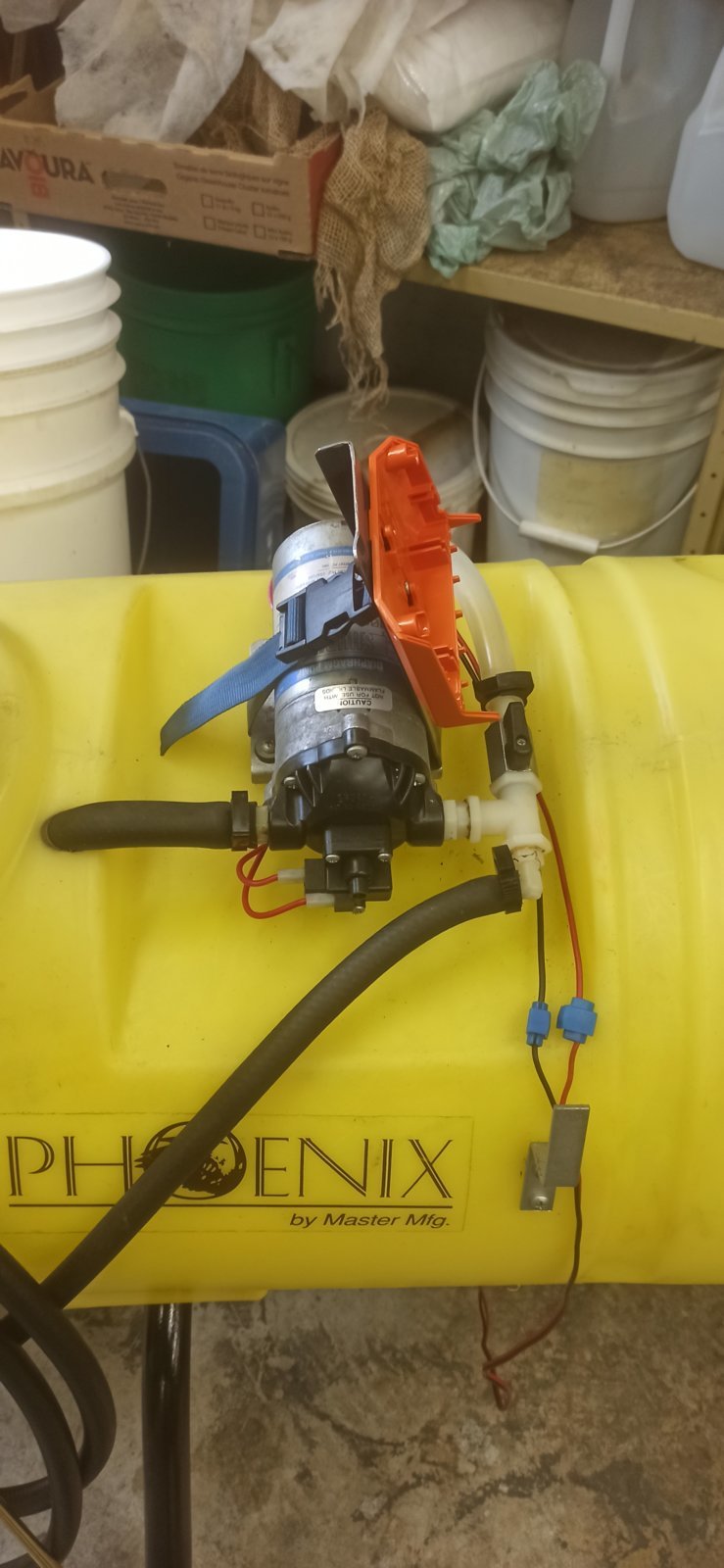

    Decided to power the free sprayer I got last fall, and keep it for a bit. While figuring how I would wire it, and to what (tractor or zt), I had a mini brain wave.
    I've had Rigid cordless tools for years and have a collection of surplus chargers, so...

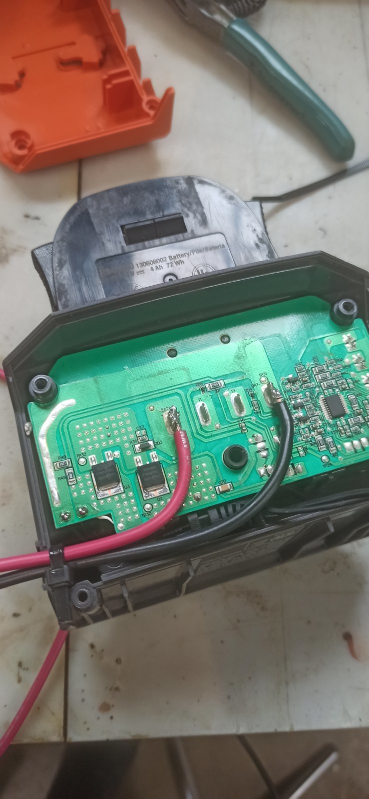

    I opened up a small one, cut the cord off where I could fix if necessary and soldered onto the + and - terminals. I'll also use this for bench DC power when I need it.

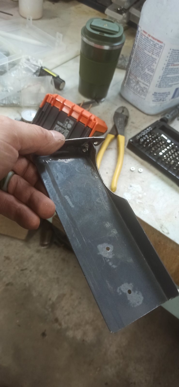

    I found a chunk of steel that I think was a stacking kit for our washer dryer that is now over 15 yrs old. I'm not a thrower outer. :rofl:I whittled a bracket that mounts to the pump motor hardware and added a strap to soak up vibration. The bracket is at the powder coater hanging to dry after I rattle canned it. It might even work...;)
