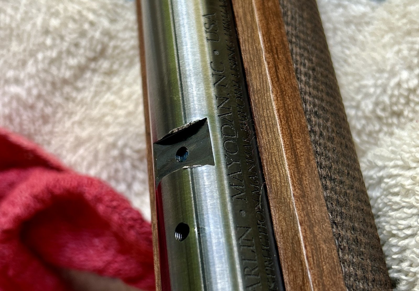

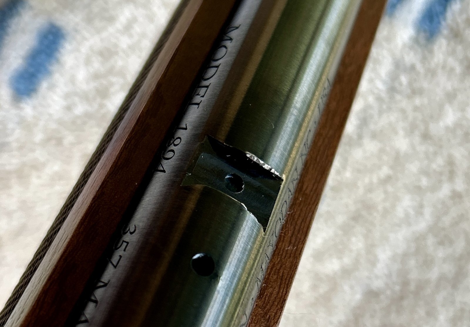

    I was thinking about the dovetail repair while I was on my walk this morning, thought I would ask @six5crèéd Shane and any of you other machinists for ideas.
    I’ve already knocked the worst of the burrs off with a dovetail file but the blank seems to be catching on the rough edge along the round of the barrel. Think I should hit that rough edge a few more times with a file, send it to a gunsmith to be recut and an oversized blank fitted or try a warranty claim. I don’t expect option 3 to work since I had to take a file to it just to get the buckhorn sight back in.

    I think option 2 is probably your best bet, doubt Ruger will do anything. Let a gunsmith make it new again without filing on it anymore :thumbsup:

    That’s what my gut was telling me but I wanted to ask the professionals. Thanks

    I'd try Ruger first. They may not do anything, but you won't know if you don't ask. I doubt you rifle is the first to have this issue. If Ruger won't fix it, then send it to a gunsmith.

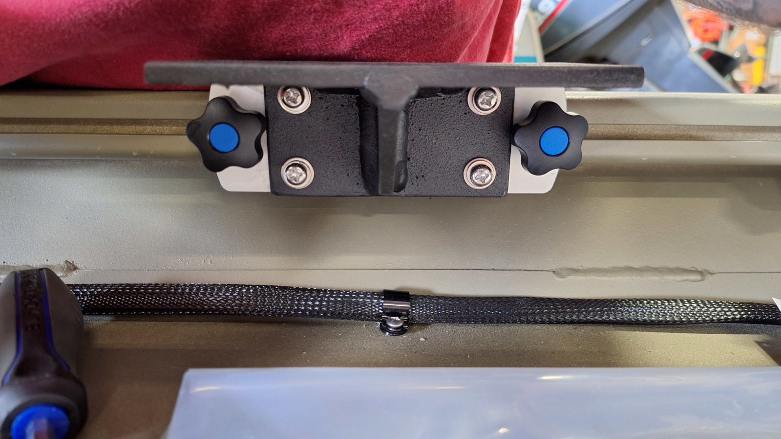

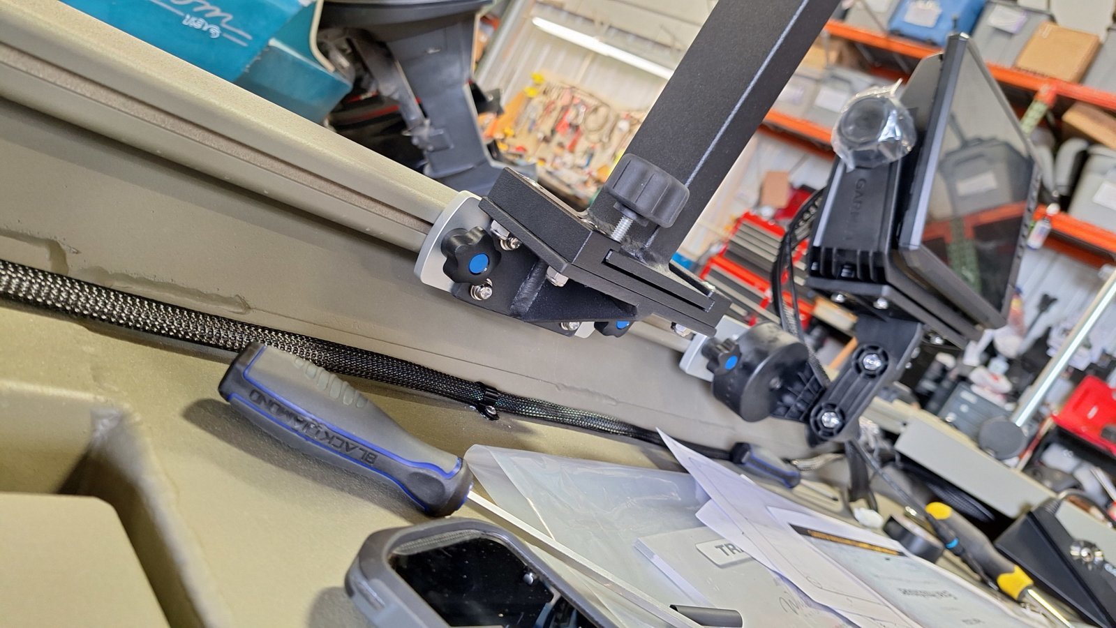

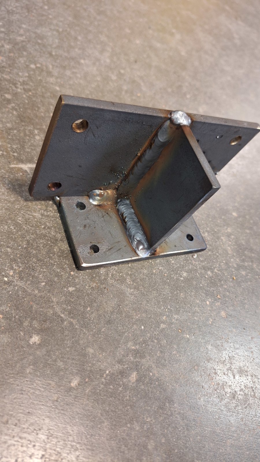

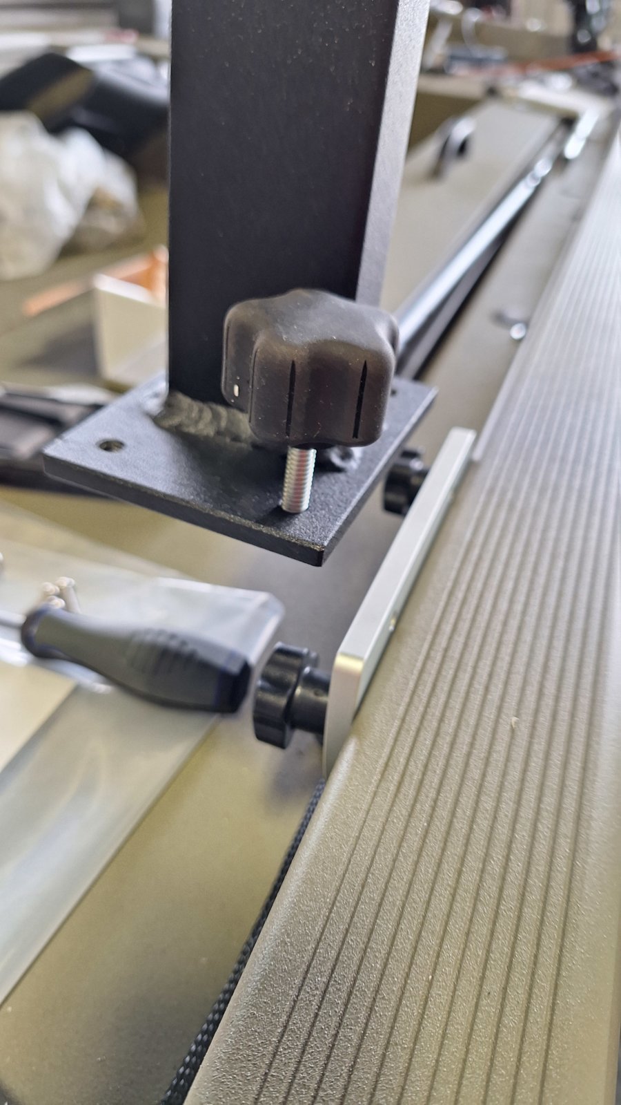

    Got to do some fabrication work today. Needed an in-between bracket to get from the rail bracket to the transducer bracket.
    Needed to join these two
    So here's what I came up with
    A little trimming
    Here it is in place
    And joined with the other bracket
    I'm happy with it.

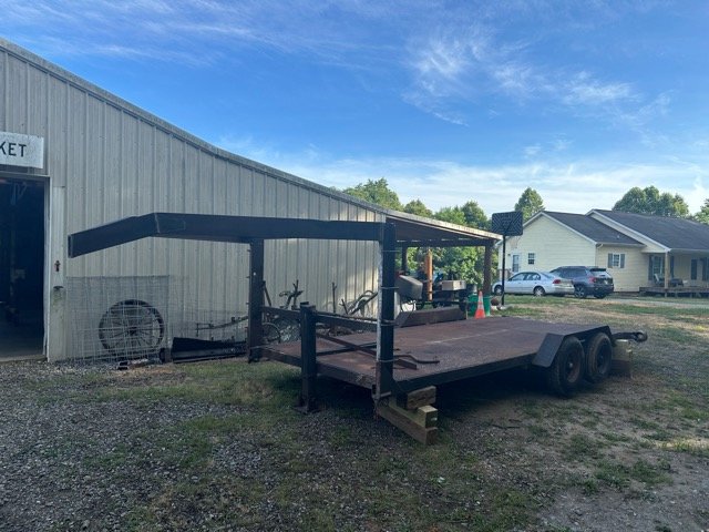

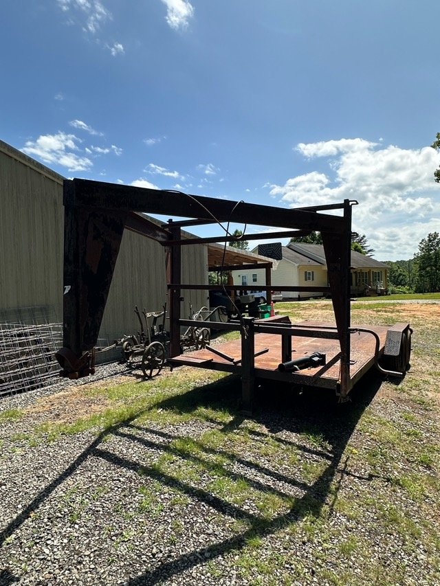

    Made a little progress on the gooseneck redo since Monday.

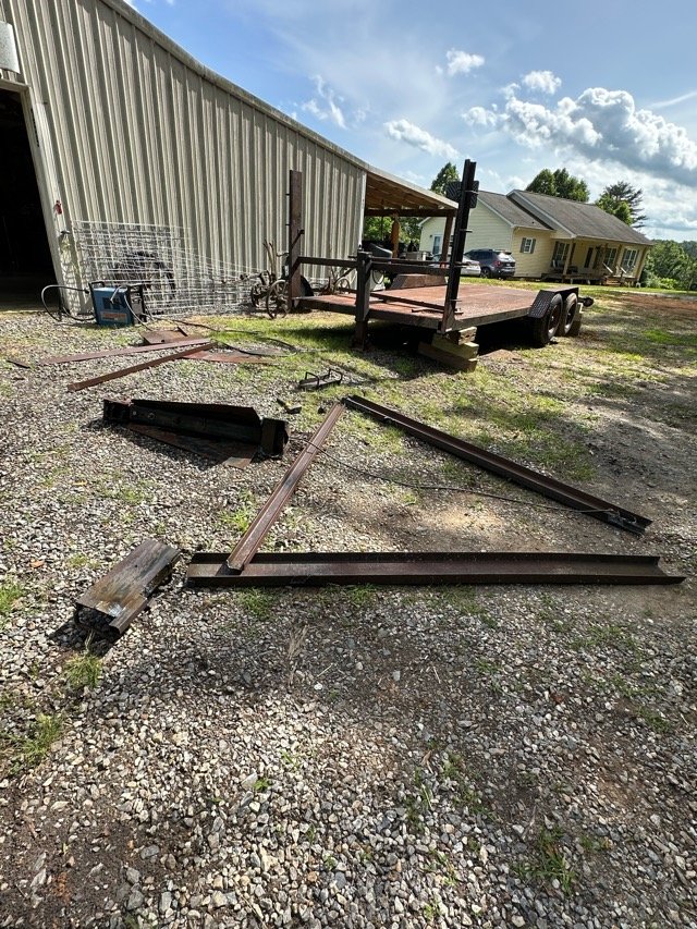

    Cut it apart, put in straight pieces. 20# of 7018 series rod should be enough!
