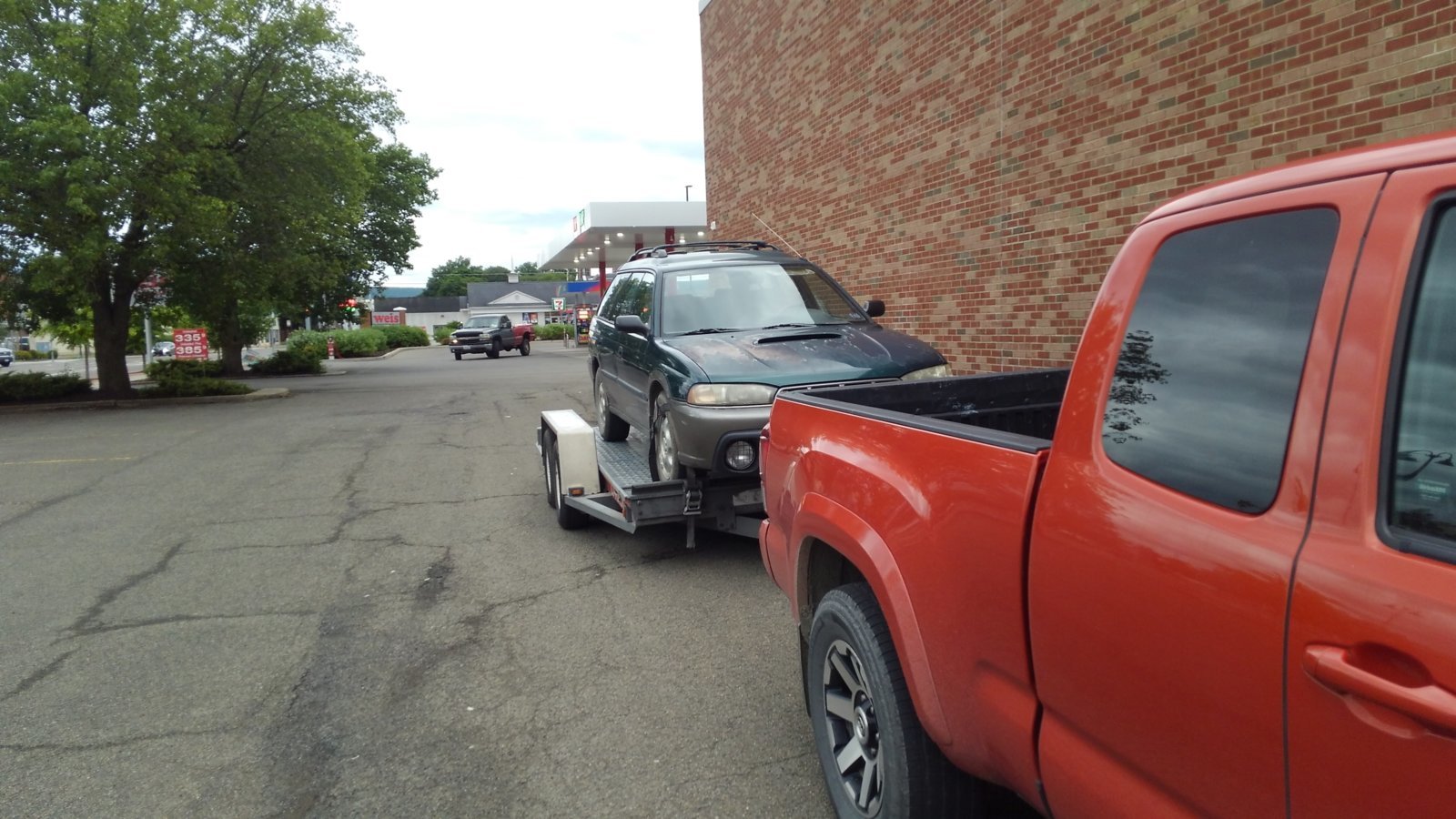

    Out the door at 4 am to deliver Mrs Green to work.
    Found a fuel pump - 45 miles away. :burnrubber:
    Had pizza special lunch at The Club to fortify myself for the task ahead.
    Well now, lookie here - an access panel behind the back seat...
    I really don't want to work on anything however this isn't a bad car to work on.
    The Subaru engineers were pretty helpful.
    Have I mentioned we live on a dirt road?
    A bit of work with a vacuum & paint brush cleaned things up - my little tester is a piezo buzzer from Radio Shack (remember RS ?? :pout: ) with 2 clips.
    Makes it easy to test for power when you can't see a light.
    Buzzer works with the key therefore the pump is bad - wonder why, it is only 28 years old... :notsure:
    And out on the outdoor work bench - truck tailgate.
    Swapping the pump was easy enough, now turn the key and...
    ...wait for it...
    $142 and back on the road!
    :yes:
