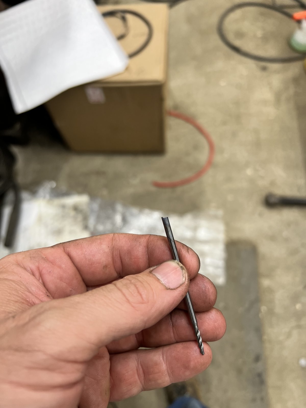

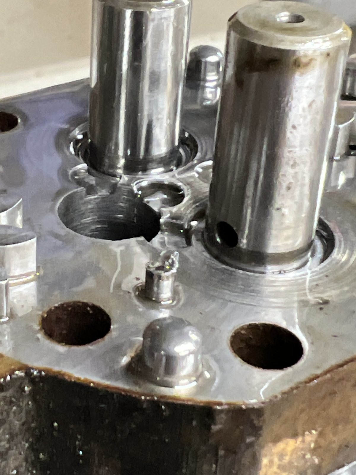

    So I had a oh crap moment last week. Was splitting wood, then the woodsplitter just stopped having any power. The ram would move, but wouldn’t go through the smallest log. Engine wouldn’t lug down or anything, the ram just stopped. I did some reading, and it looked like it could either be the ram seals were leaking by, or the pump could be toast. I changed the filter and found some metal in there. Not a great feeling. I looked up the pump part number, a replacement was $800. So in debating buying a new woodsplitter, I said it’s already broke, I can’t break it more. I pulled the pump apart. Here’s what I found. IMG_6718.jpg
    That little pin right there sheared off, and the small clips that held the larger gears in place on the shaft were non existent. Luckily, I had a scrap endmill that fit that hole just right. IMG_6719.jpg
    I also had some stainless clips that fit perfectly to keep the pump gears in place. Wound it back together and tried it last night. Thing splits as good as it ever has, and it didn’t cost me a penny to fix it!
