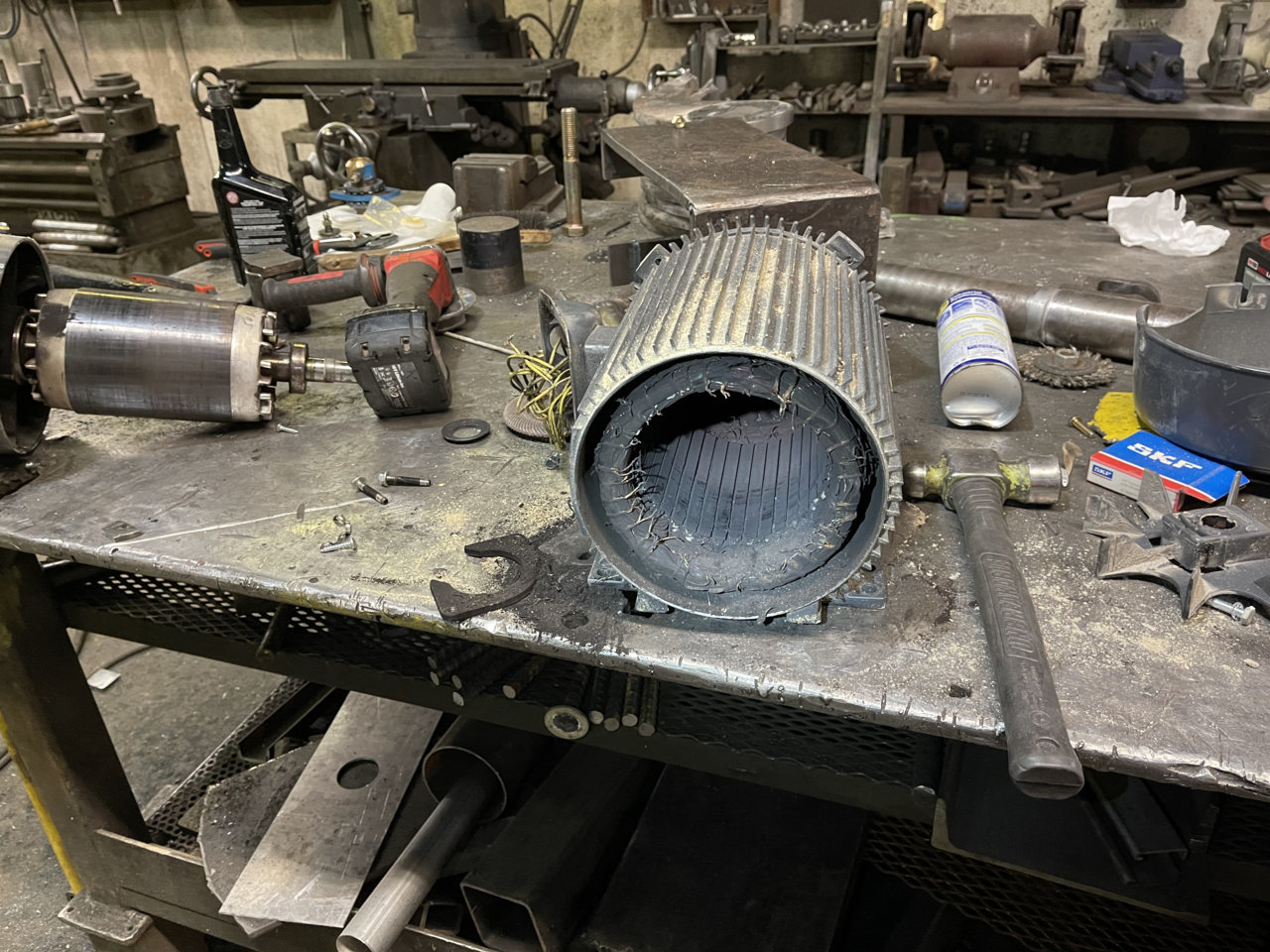

    Looks toast for sure! Just 2 months? Is that expected life span?

    I certainly hope not. No idea how long the one before it was there

    Time to look for root cause of that early failure then. Someting Wong

    Likely cause is the environment that motor is in. Lots of wet fresh sawdust around it, lack of cleaning and care by the cleanup crews. Not in an ideal location for ventilation/decent airflow. Sadly with the way that waste belt is placed, it's the only location available.

    Was it grounded or bearings howling

    Grounded on two phases. Instant popped fuses

    After the bearings growled momentarily then she went to ground looks like rather nicely when the rotor and stater became acquainted with one another.o_O

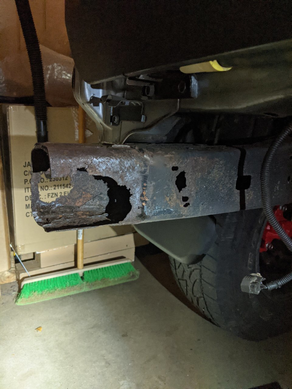

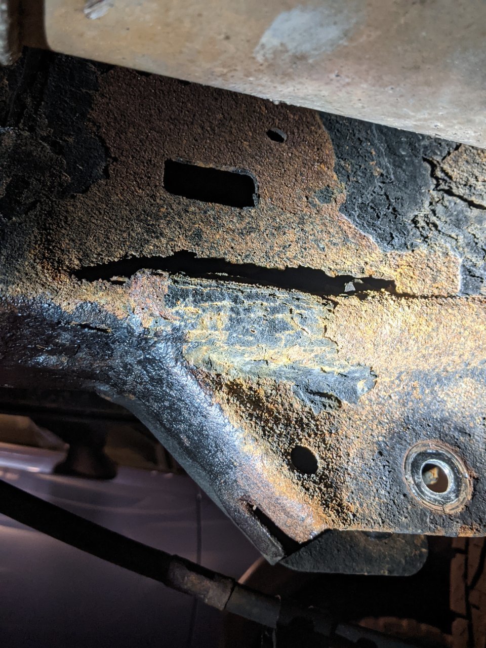

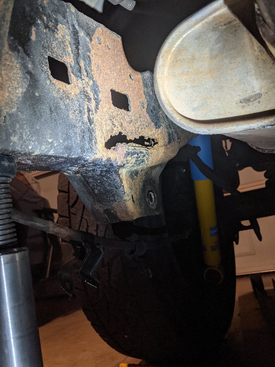

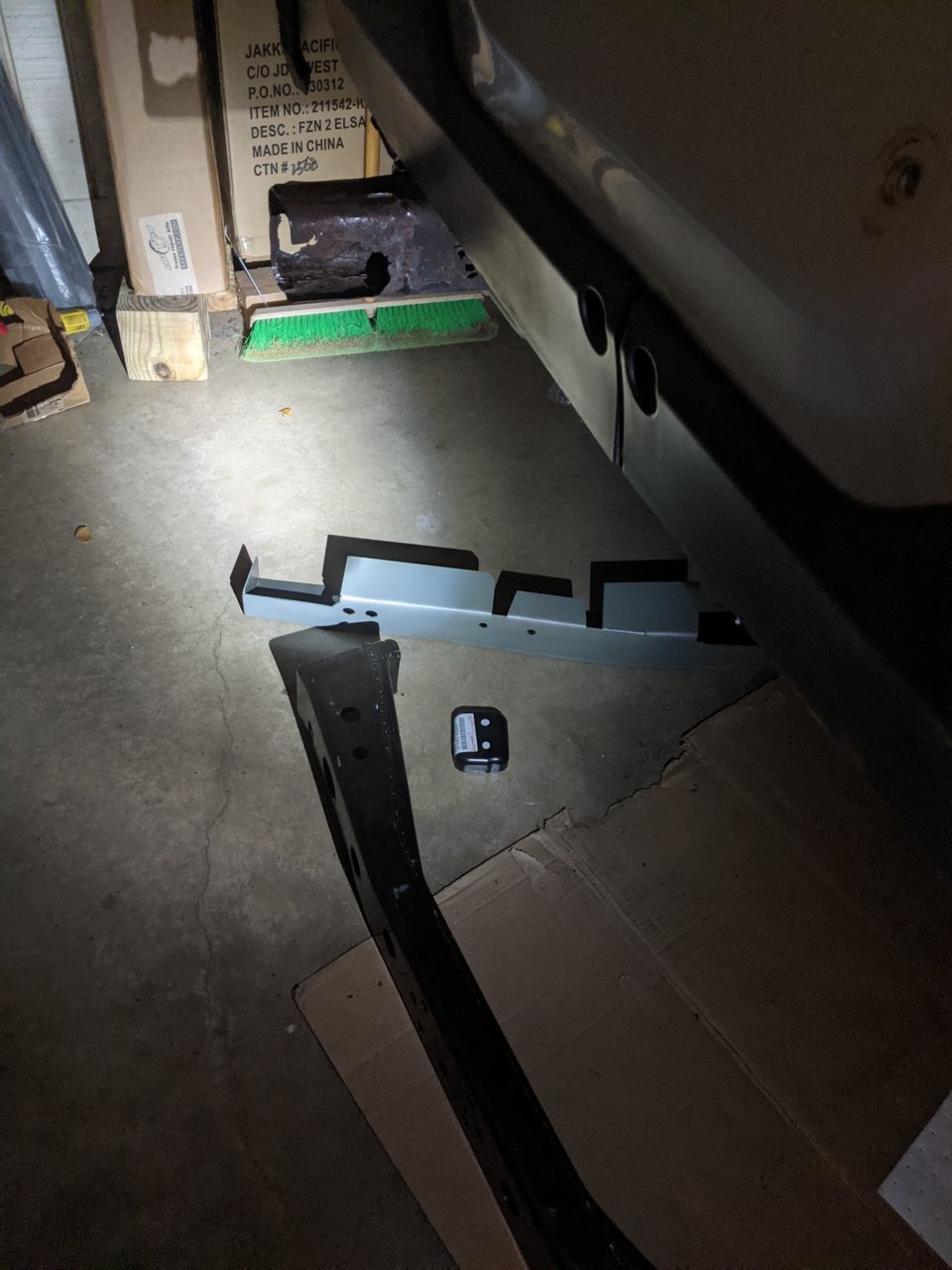

    If your up to a challenge and would like to spend some time in the subtropicals. I have some welding that needs done.
    PXL_20210202_022223404.jpg PXL_20210202_022242853.jpg PXL_20210202_022327571.jpg PXL_20210202_022405399.jpg
    This FJ came from NY, I think they use to park it in the ocean.
