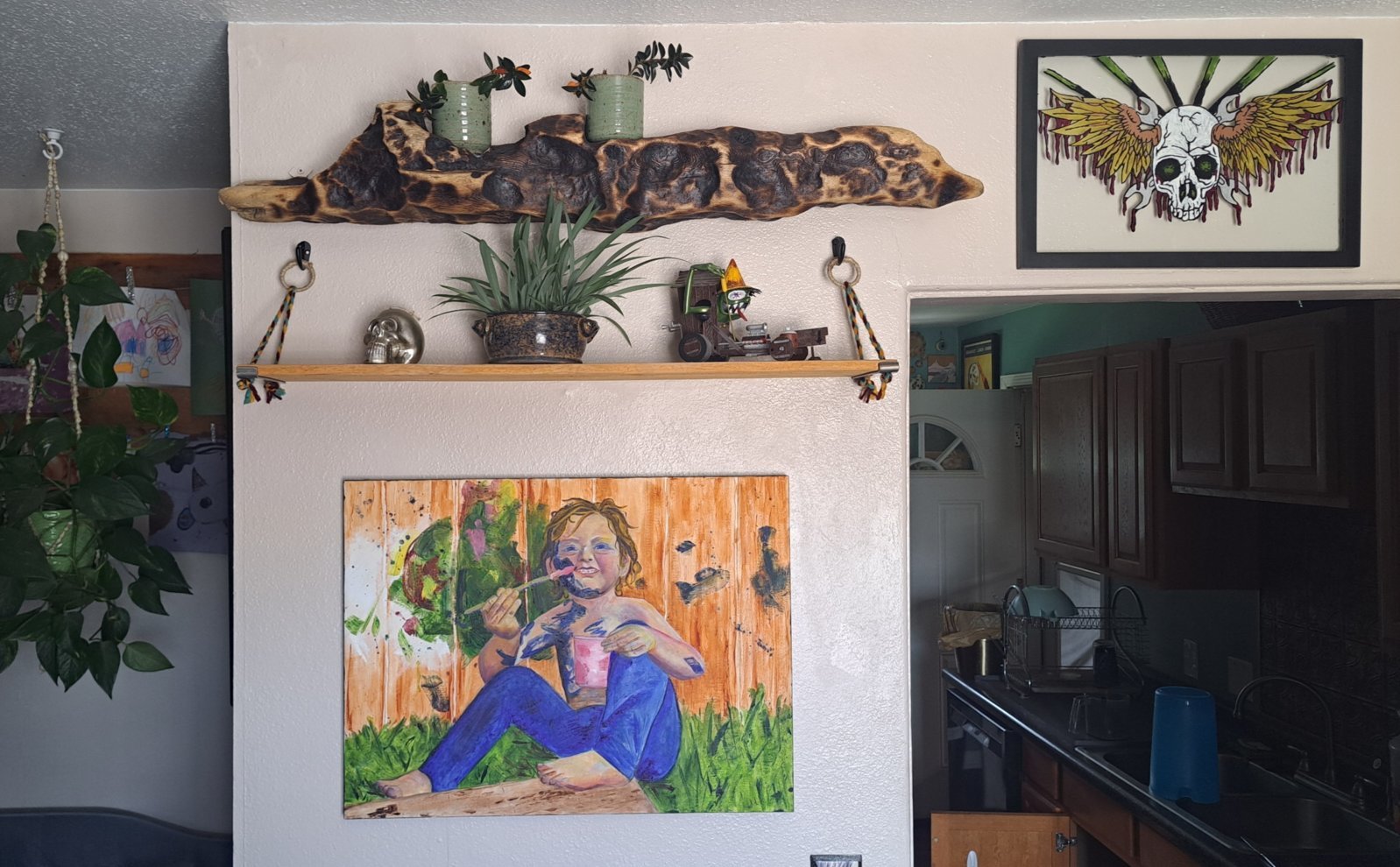

    A while back I found a beautiful (to me anyway) piece of drift wood from a burn area while on a hike.
    It already had two pretty flat places on it so I just flattened them to fit the pots, put some poly on it and boom. A plant shelf thing is born. Nowhere near the level of woodworking I've seen here, but not bad for me Resized_20240703_111203_1720026869775.jpg

    Looks cool!

    Creative random :101010:

    I like it

    Nice job!
    Good job on having the vision to see a project in a random piece of wood too. :thumbsup:

    Thanks sir!

    I have seen just a stained board look incredible! That looks great and add 11% for creativity!
