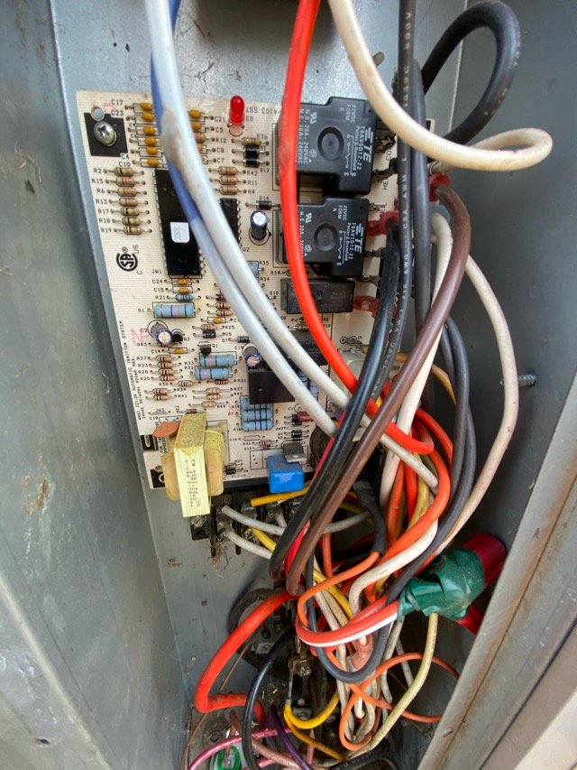

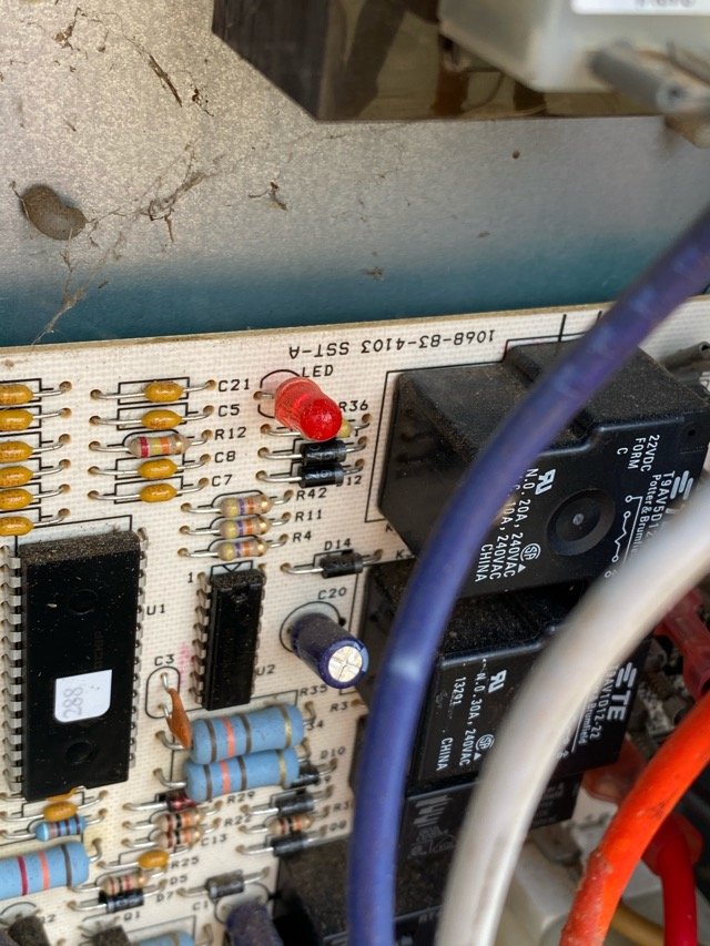

    Where are the HVAC peeps? I have searched all these numbers on this circuit board and can’t find anything that matches. It’s on our Goodman gas pack at the house. Every now and then I have to tap on the black contact, second one down to get the fan to turn off. This isn’t the first board to do this but it’s so old now I’m having trouble finding one.
    The man at the local supply house found me one but it’s not a direct replacement and I don’t know enough about wiring to wire it in if I have to start cutting wires.

  11. Feb 3, 2021 at 7:28 AM
    #9411
    Gregthespy
    Gregthespy Well-Known Member
    Apr 27, 2015
    #154090
    1,577
    Greg
    Orlando
    2015 Blue Ribbon Metallic TRD Sport 4X4
    Morning Shane.
    Worst case scenario, find someone handy to re-solder a new relay onto the board. I’ve had to do that for my gate opener control board because I’m a cheap SOB. The new board was $170 and a relay was $8.
    I didn’t feel comfortable soldering the relay directly to the board, so I bought a relay pigtail with some wire leads and made a jumper harness that made it easier for me to solder the individual wires to the board contact holes.
    I hate board integrated relays!
  12. Feb 3, 2021 at 7:52 AM
    #9412
    tirediron
    tirediron Well-Known Member
    Jan 19, 2019
    #279864
    3,891
    John
    Victoria, BC< Canada
    2022 4x4 Sport, Auto, BCM
    It's easy enough with the right tools, first and foremost you need a GOOD soldering iron (I like Weller variable temp units) with an appropriate size tip and a de-soldering pump, or "solder vacuum". The de-soldering pump is the secret; it allows you to get the excess solder off the board and leaves nice, open holes for the new conductors.

  13. Feb 3, 2021 at 7:53 AM
    #9413
    wilcam47
    wilcam47 Keep on keeping on!
    Jan 27, 2016
    #176243
    55,266
    Will
    Bourbon state
    https://www.amazon.com/Upgraded-Replacement-Goodman-Furnace-1068-400/dp/B00EF5Q9J2
