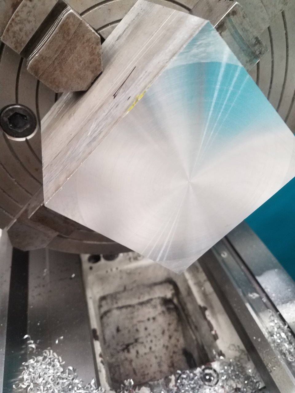

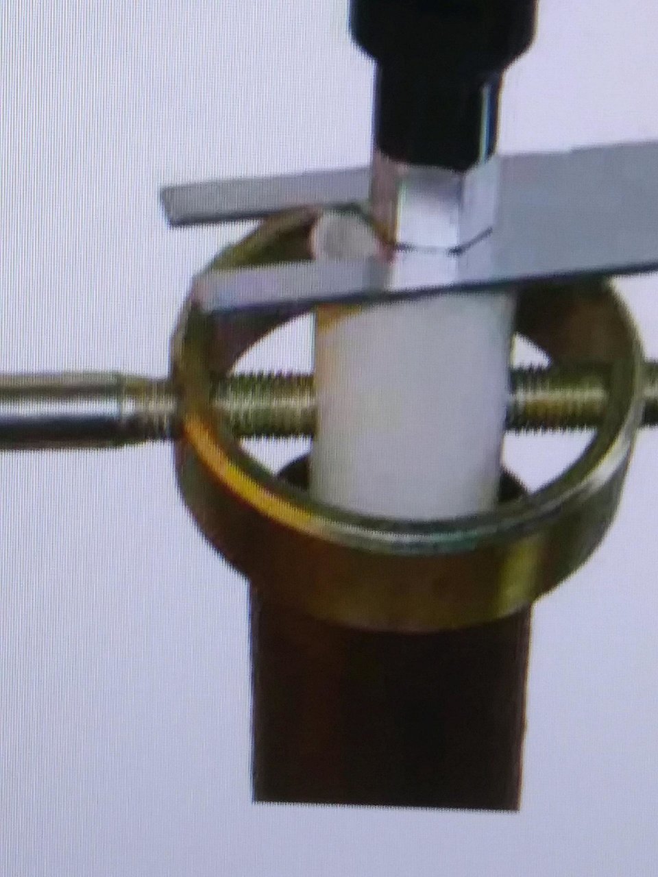

    There's 2 pieces in the 4 jaw
    Hint;

    Anti-spin jed clamp-it device

    That piece is bored out 3 thousandths of an inch over the tube diameter. I think 2 strip of 2" wide blue masking tape for no scratches and it should hold tight.
    A little concerned if his vise will open 4 inches, but have a idea around that.

    Clamp for a barrel?

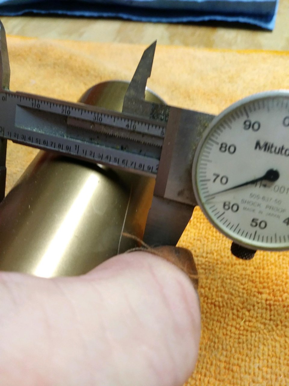

    Fork tube so kind of.

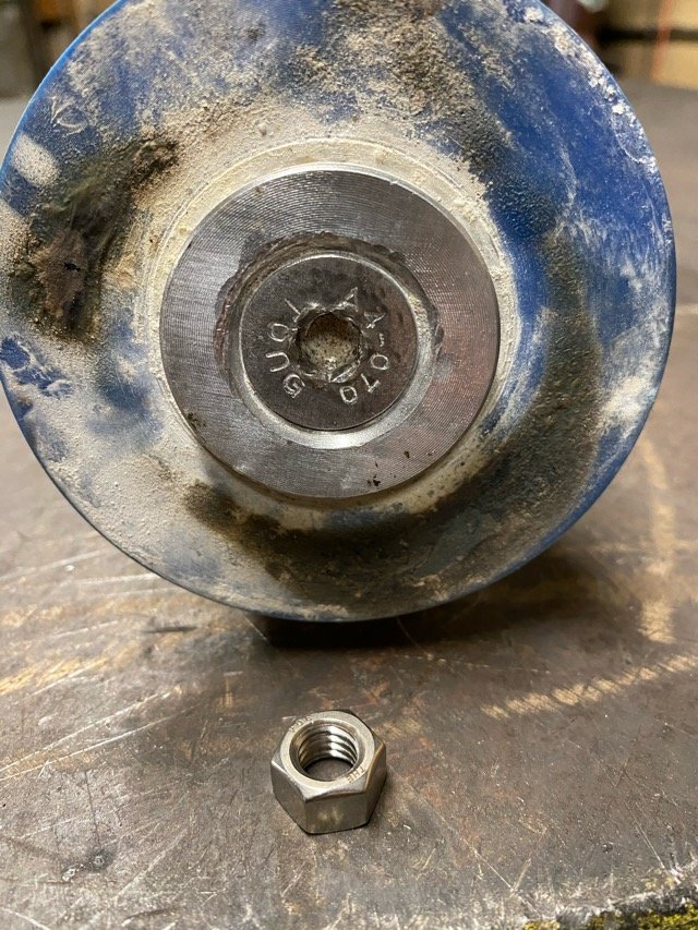

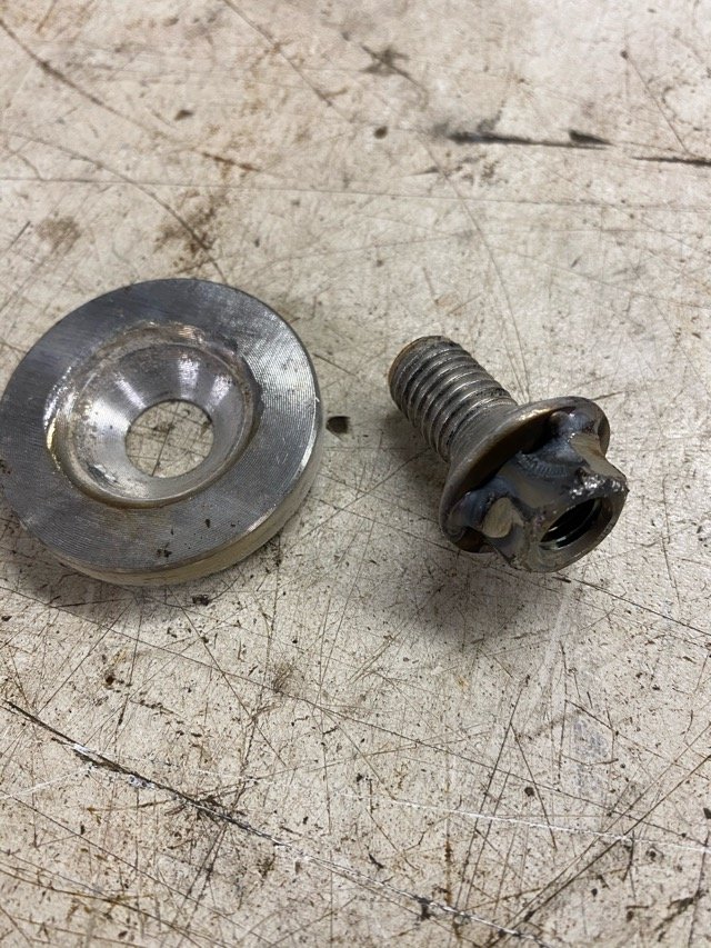

    Tig welding sometimes is like using a pair of vice grips, you need 3 hands. I tried welding this first nut on but need to regrind the tungsten and haven’t. Couldn’t get it to stick without filler rod. Second one repositioned the part, used filler rod and it came right out.

    I'm rather curious why you tig welded that. We always reach for the mig welder when attaching nuts to things.

    I usually do, this was stainless and the large piece around it is rubber. Didn't want the sparks getting into that :thumbsup:
    My coworker already charred part of it with the butane torch :bananadead:

    Ah, couldn't tell it was stainless at a glance. That makes much more sense now!

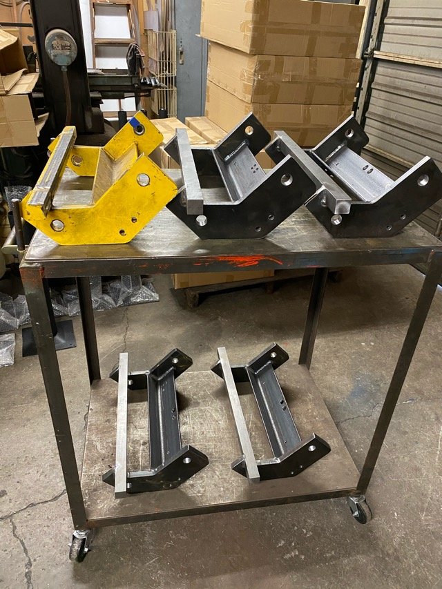

    Do you have any idea what that part is used for??
    Why is the middle part on the table different??

    I was wondering why the middle one was different too, good eye!
