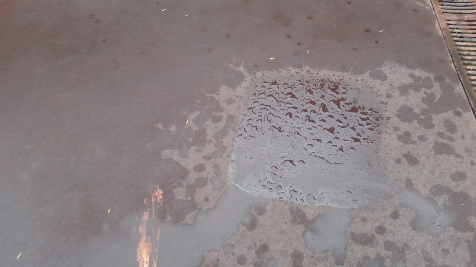

    Here is a small test I have been monitoring.
    Back when I was working on the Subaru I sprayed a heavy coat of Fluid Film (L) and Cosmoline (R) side by side on this rusted car hood.
    The only prep was to wipe the surface with a clean rag. This is horizontal so it gets full weather exposure.
    You can see the Cosmoline is still there while the Fluid Film is gone.
