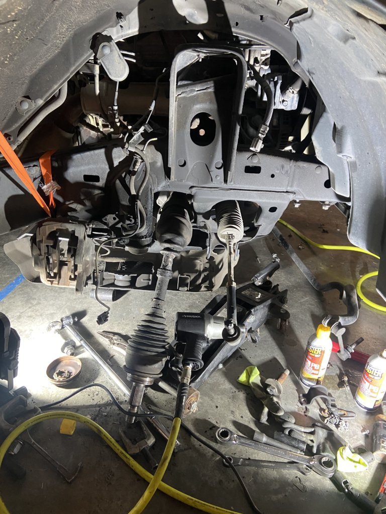

    Passenger side deconstruction almost complete. Just need to remove the CV axle and the tie rod assembly

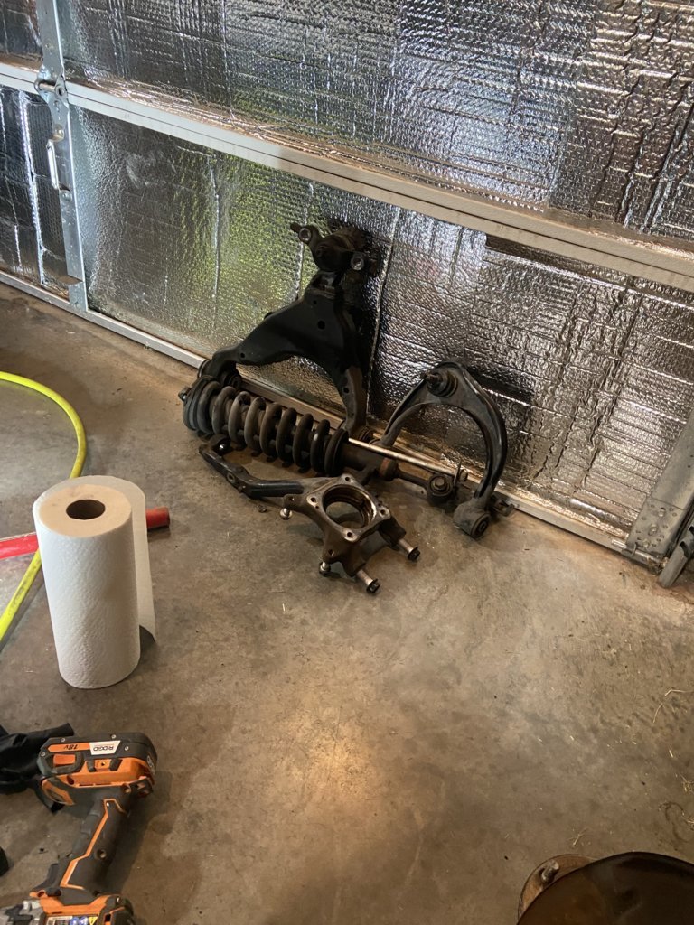

    I’m calling it a night in the garage.Pulled the CV axle. That thing was toast. Figured I throw in the control arms and coil over to see how it looks. Installed a new passenger side headlight assembly as well. Tomorrow I’m going to weld on the limit strap bracket and hopefully get everything assembled on this side. And if the wife doesn’t make me do too much yard work I might start taking apart the other side of the Lexus.
