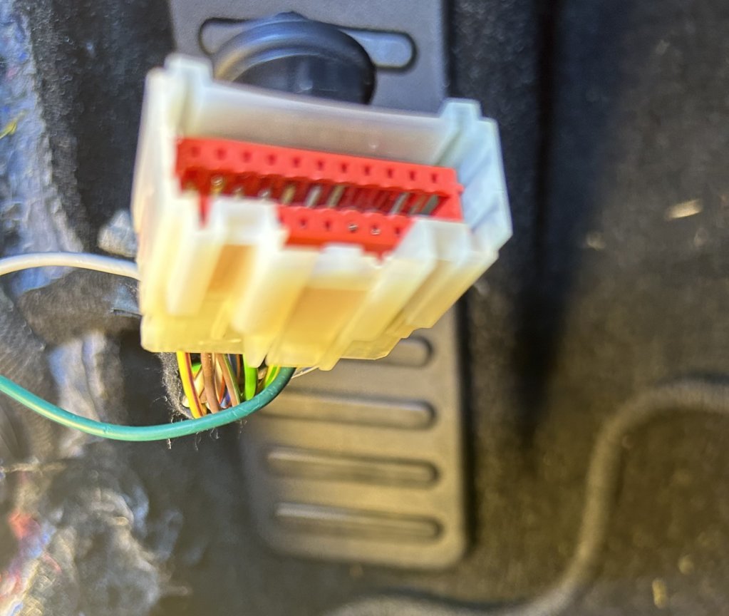

    Maybe someone as knowledgeable as @Tacoma Mike ?

    WTF..
    THAT LOOKS SOOOOOO BAD.
    Can you pop the retainer back out and line things back up.
    Those pins are so fragile. To be honest I’d have to get my hands on it to play with it..
    One pic does not a repair make..
    I have done straightening when one of the kids bent the crap out of them. Those were males.
    This looks like the female end. Lots of loose pin connections waiting to happen..

    Yeah, bad is a nice way to describe it…
    Thanks for responding so quickly :hattip:
    Lining up the pins was what I spent a couple of hours trying this afternoon. Some snap into the housing but it’s not consistent. Some are lined up perfectly and I was trying to maneuver the next highest ones into place, both rows from the slot in the center, while simultaneously applying gentle downward pressure on the plate, in sequence.
    I wasn’t able to precisely move the pins with the collection of small picks and screw drivers.
    I might file a small slot in a tiny screwdriver to be able to get some lateral control.
    I’m thinking I’ll need to depin one side but not completely remove from the connector, just enough to seat one side of the plate, then repin the other side.

    Edit: YT has quite a few clips on how to depin automotive electrical connectors. I learned the reason they’re all working with connectors cut from vehicles and doing on a benchtop…. :frusty: (Lemme know if you want a hint)

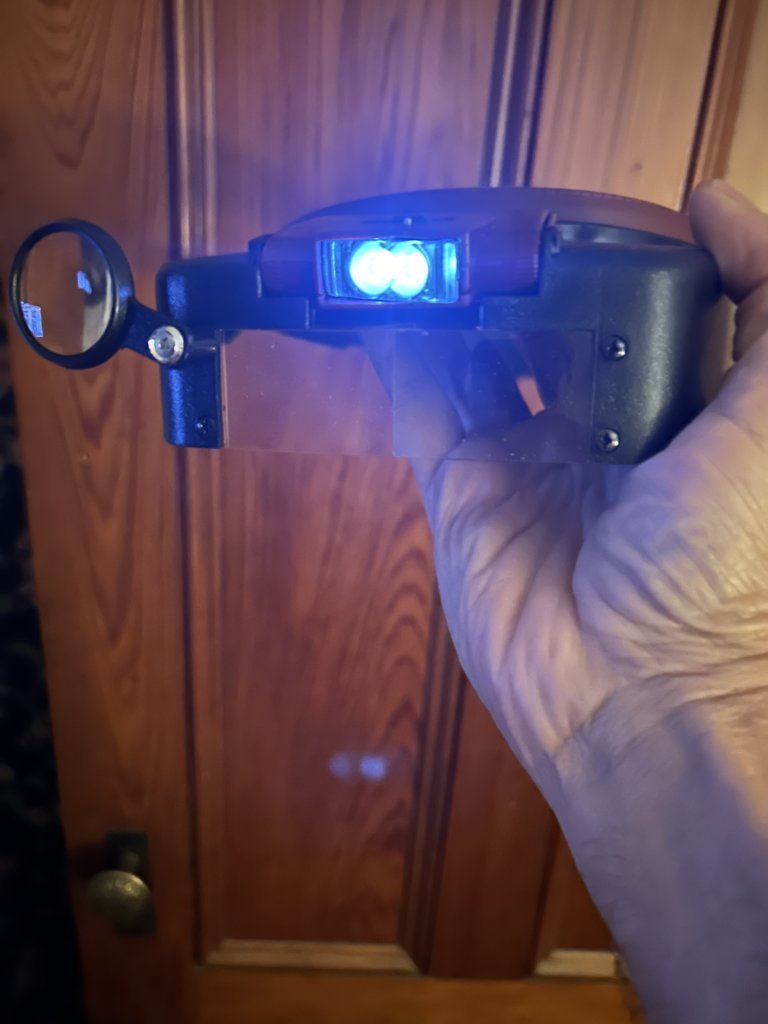

    Before I threw in the towel, I had to blink and refocus a bunch of times.
    Time to deploy the lighted, magnifying thingy! But first, gotta get some more AAAs

    i'd consider placing two screwdriver shafts on the outside rear of the plug, and pinched together to force the pins outwards from center. normally there's guides on the outside of the pins to locate them, but there's also usually not openings in the middle for them to fall into either...

    It’s a pretty hard plastic and I dont think there could be any pinching that wouldn’t crack the housing.
    It’s kinda miserable trying to manipulate this connector in the footwell where it is.
