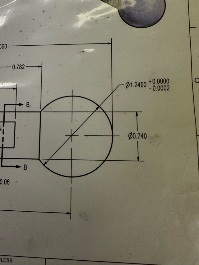

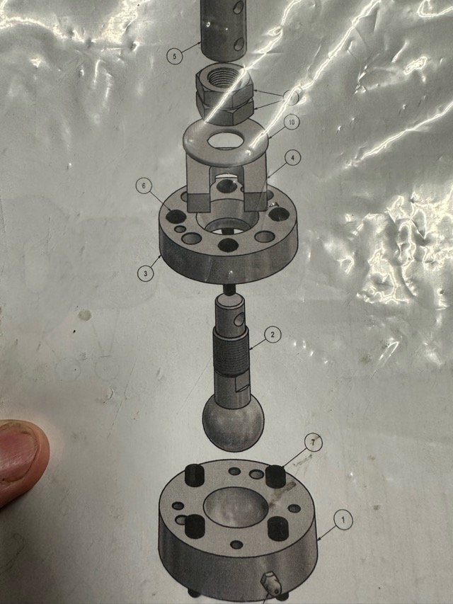

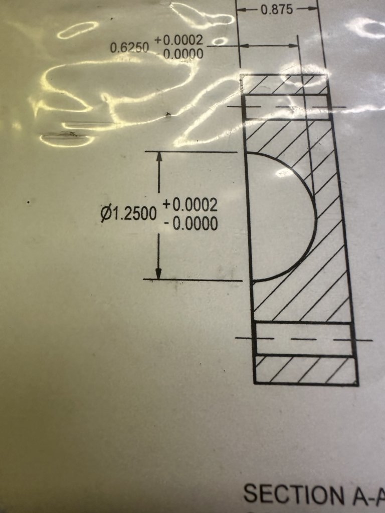

    What’s the ball and socket clearance? .003 ?

    .001” to .0014” and it gets fitted after heat treat. D2 tool steel.

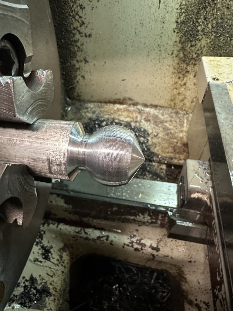

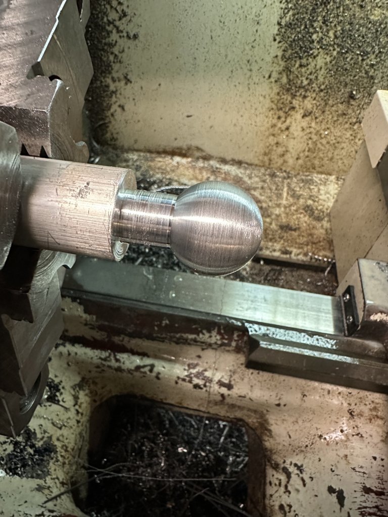

    My 1st ever attempt at making a ball in cnc mode.
    Oops, wrong tool.
    2nd try, oops, wrong tool again.
    3rd try, 2 different tools, got it. 3rd times the charm.

    Nice Job

    Thanks. Was a headache trying to figure out how to set the tools up since I've never done it. Once I got it figured out, it's simple.
