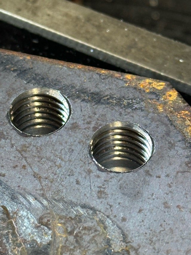

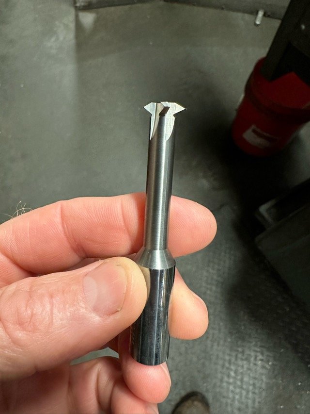

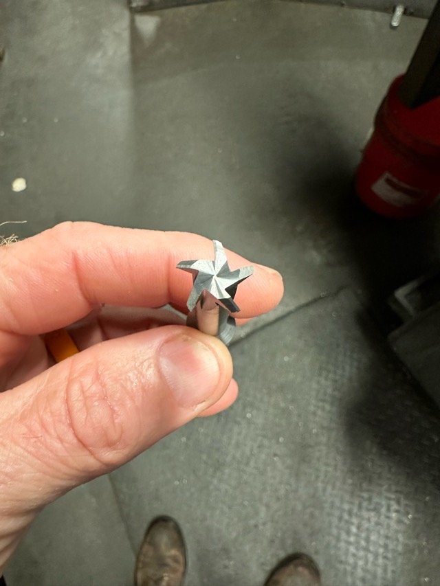

    Boss man ask me a couple weeks ago how I felt about thread milling on the mill. I said I’ve never done it but get me a tool and I’ll try it. 3/4-10 thread, hot rolled material. Worked good.

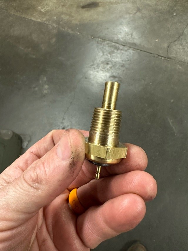

    Customer ask if I could make this 3/8” npt instead of 1/2” npt. I said only one way to find out. He’s putting it in his Corvette.

    He has modern/aftermarket heads on an older car.
    The temp gauge is calibrated for the older style sender with 1/2" threads.

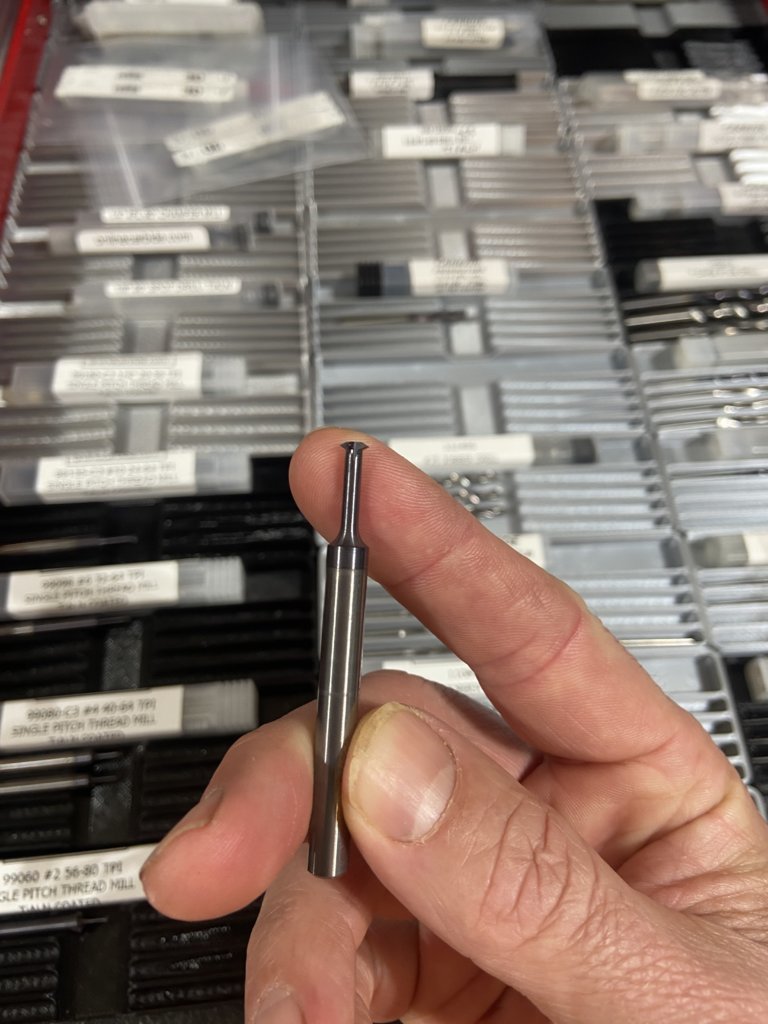

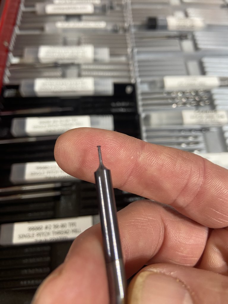

    I love thread milling. Smallest I use is 2-56 and largest I use it 1/4-20

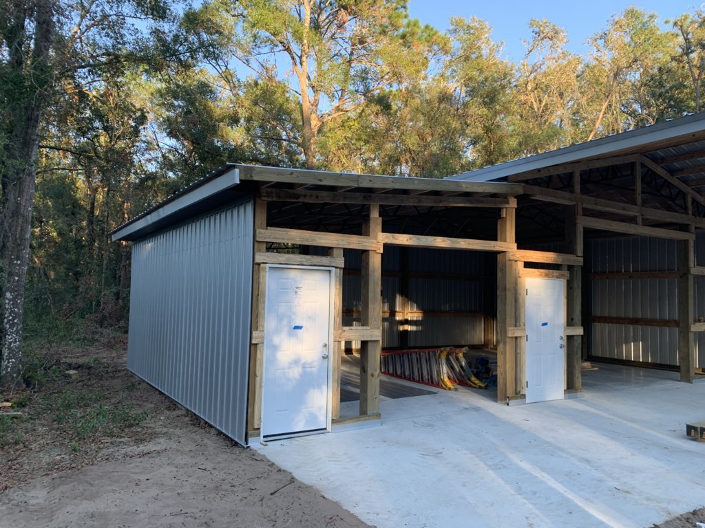

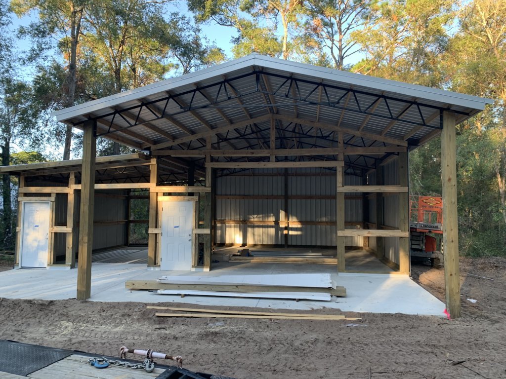

    We’ll crew is gone got a lot done should be done on Monday. IMG_8892.jpg IMG_8891.jpg

    That blows my mind that bit holds up

    Ok, trying to wrap my head around it.
    How does this work? Is the tool smaller than the hole, and just cutting 1/8 of the threads at a time and you're just running it in a circle while also forcing it down at a predetermined speed to create the threads?

    There’s a cycle for it on the mill computer, you tell it major diameter, minor diameter, pitch, rpm, feed, and tool size. It figures out the hard stuff and feeds in a circle while going down. I did drill the hole the tap drill size. I did this in 7 passes with a .008” finish cut.
