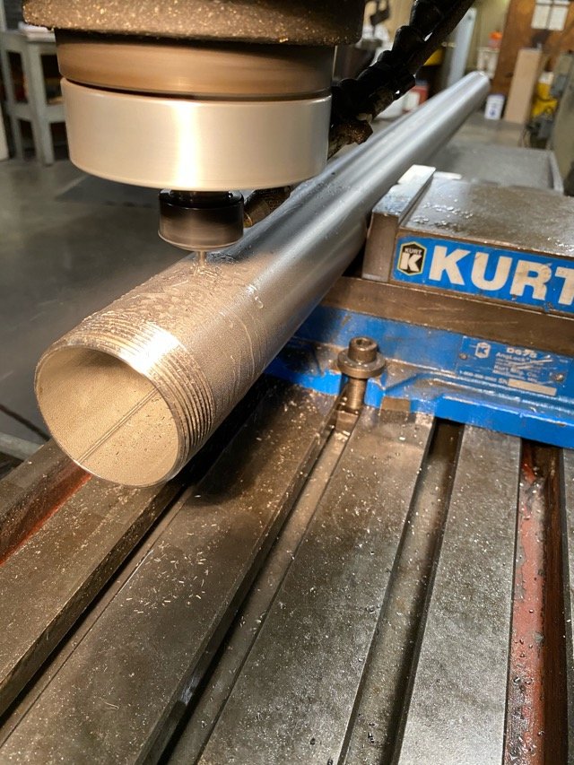

    Basically, yes. Since I have to move it anyway I just put it in the vice. It really isn’t a critical part. I have to fight that “make it perfect” urge.

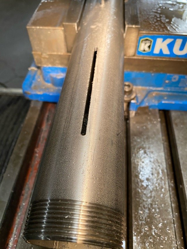

    First slot done, didn’t break the end mill so that’s good. 1878 RPM, .5” a minute feed.

    1878 rpm?
    That picky huh?
    I’m usually
    “Take er easy”
    Or
    “ give er hell”

    Textile plant, one of our biggest customers and also the only one left in the area. 99% of the things we make for them are out of stainless.

    I programmed it at 1,500 and hit override until it sounded good, it stopped at 1,878 :D
