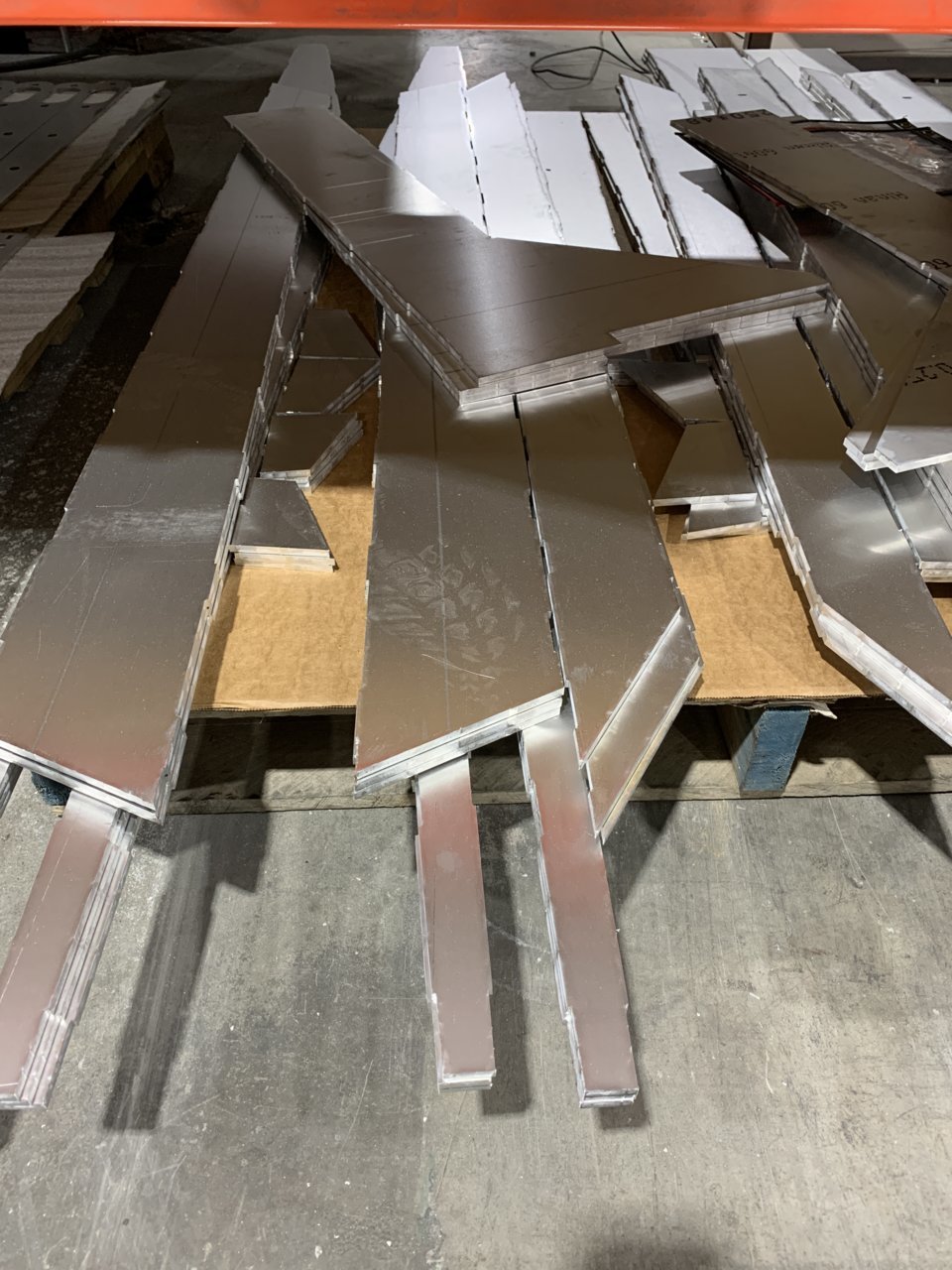

    So here’s a little more about those parts that I had in the back of my truck. They’re not simply box tube with mounting plates welded onto the ends. When approached by the customer they had a CAD model of a trapezoid shaped part with a taper from one end to the other, no instructions on how they wanted it fabricated. Not exactly something that you can buy in the form of aluminum extrusion. So I had to get creative and make these parts from 1/4” thick 6061-T6 sheet and fully MIG weld them (4043 wire).
    In order to make sure they always were welded in the correct orientation, I made the edge surfaces join together with sawtooth tabs which only mated with the correct edge of the corresponding part.
    They are also internally gusseted to help hold the shape while adding all of that heat while welding.
    Had another batch of them rolling through the shop and thought I’d show the pieces. This is after they come out of the sheet off of our high speed punch.

    A dummy proof welding puzzle, I like it :rofl:
