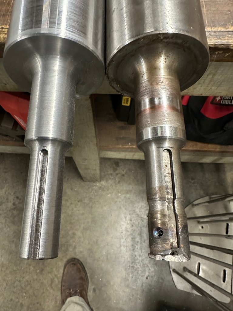

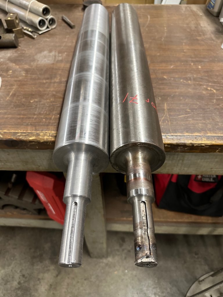

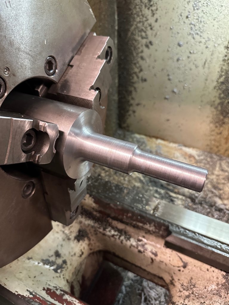

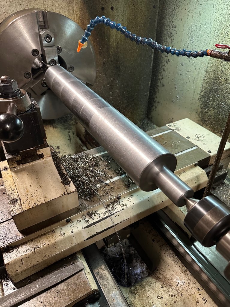

    @Delta09 you got any of these at "the company"?
    Boss brought this in and said they had to have it. Both ends needed repairing. I got to measuring and the body has .100" crown. No way to hold it in the lathe to turn the ends if I welded them up.
    Told him it would be quicker to make a new one so that's what I did.

    I hate those things with a passion! So heavy to try and put in place :goingcrazy:

    Yerp, right at 100 lbs :muscleflexing:

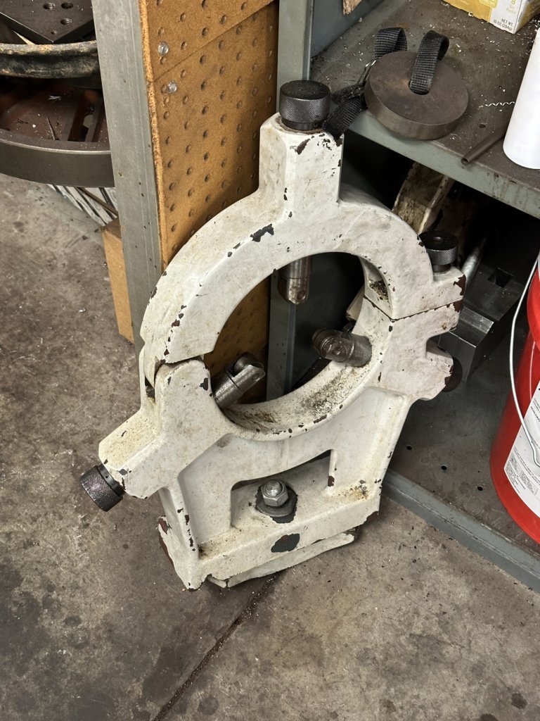

    Is this poor maintenance or just normal wear and tear. Yikes!
    Also, look into getting yourself a steady rest. Should help with the oversized jobs.

    Normal wear I suppose, running non stop.
    We have a steady rest :thumbsup:

    You should hear how loud they thump when that shaft fails. We had one that shook the whole floor :rofl:
  16. Dec 18, 2024 at 5:25 AM
    Delta09
    Delta09 Requires Supervision
    Apr 29, 2019
    #291677
    13,304
    Adam
    South Central PA
    2024 SR5 DCSB 4WD
    If the lock collar gets loose, it'll spin the shaft. Or the bearing goes out. That's typically the two failures we see in our building.

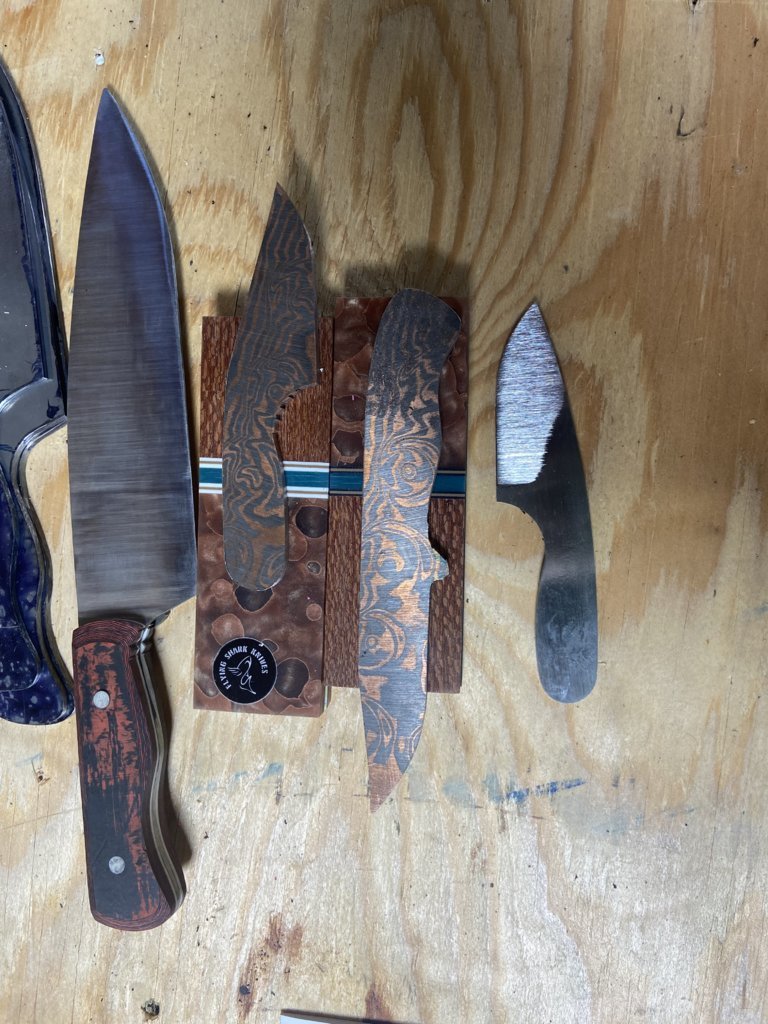

    not taking anything away from @phillstill but if you guys wanted to see something else cool.. google Copper Damascus

    That’s some cools stuff. I actually just started working with some last week.

    I dunno how good an edge it would keep being copper is so soft
