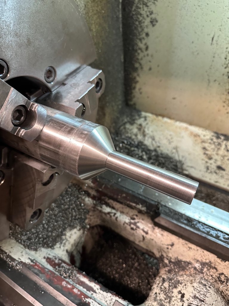

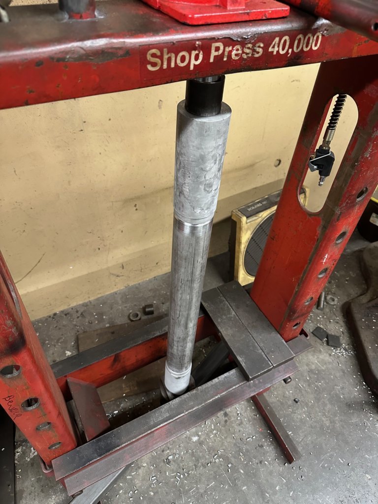

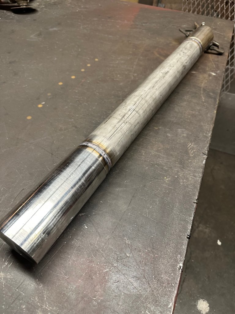

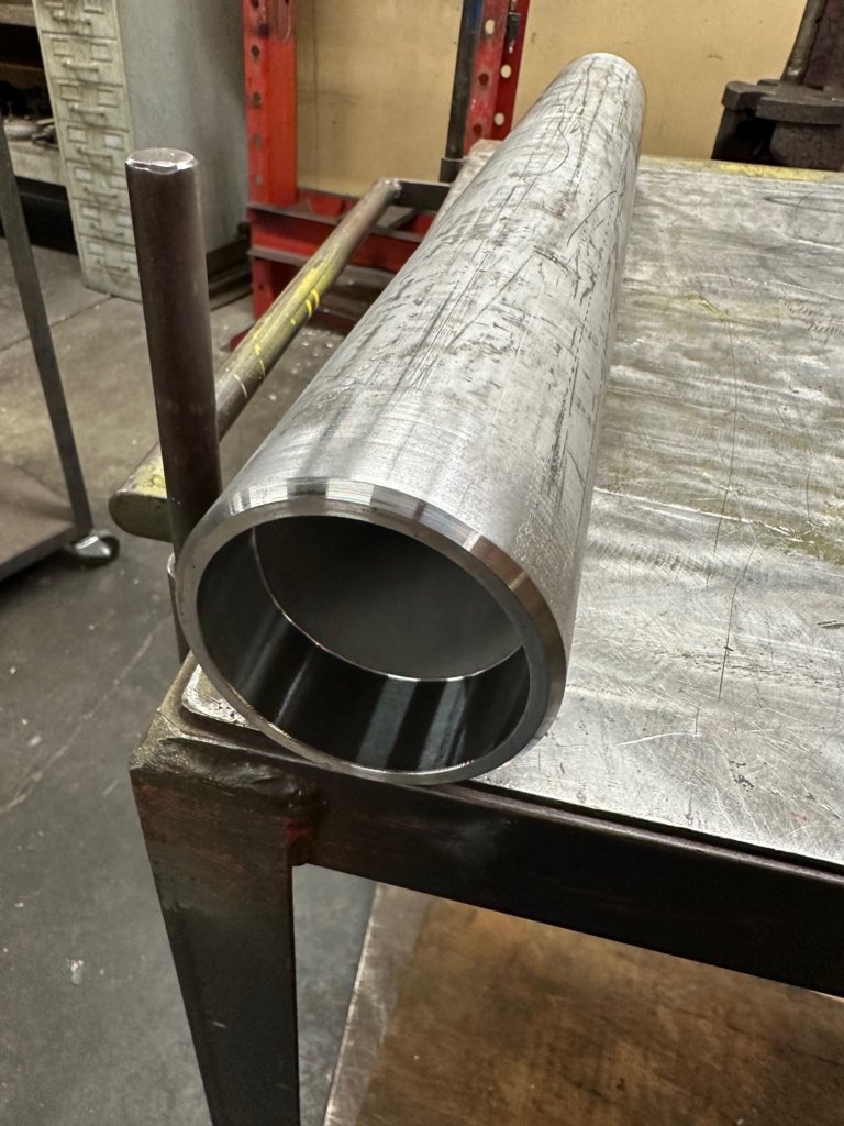

    Made these yesterday and stuck them in the freezer before I left, they shrank .002" which is exactly what I needed for a drop in/snug fit.
    303 stainless
    Had to press one of them half way in so I left it in the press while they warmed up.

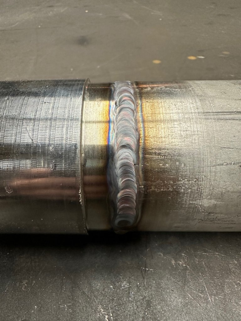

    Thank goodness this ugly weld gets turned off. Just because you have a TIG welder, doesn't make you a TIG welder.

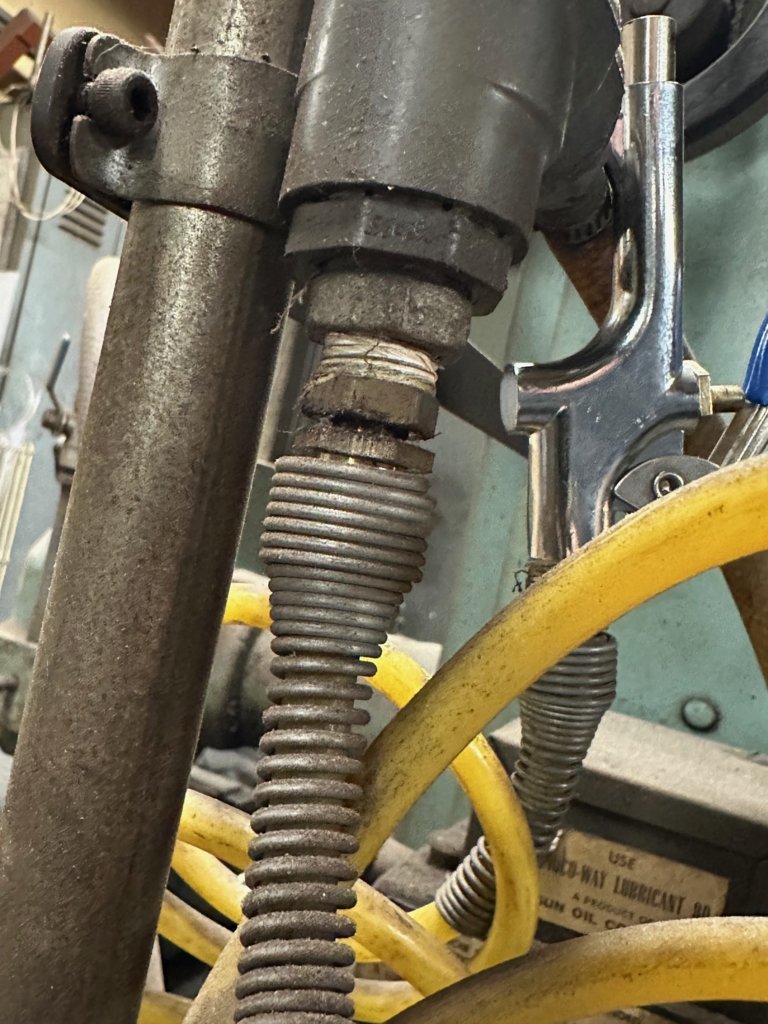

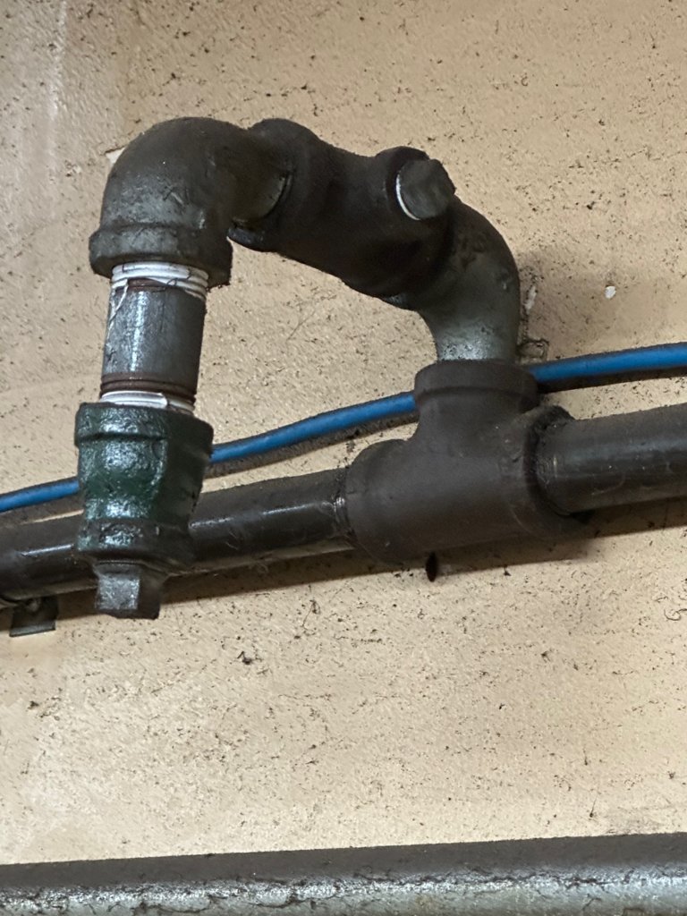

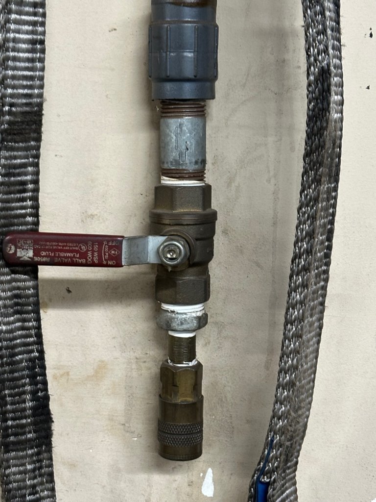

    You can get most fittings at local hardware stores or Lowe's.
    Here's some of the crap we have at work :anonymous:
    Some are capped off because we've moved machines.
    Some is schedule 80 PVC
