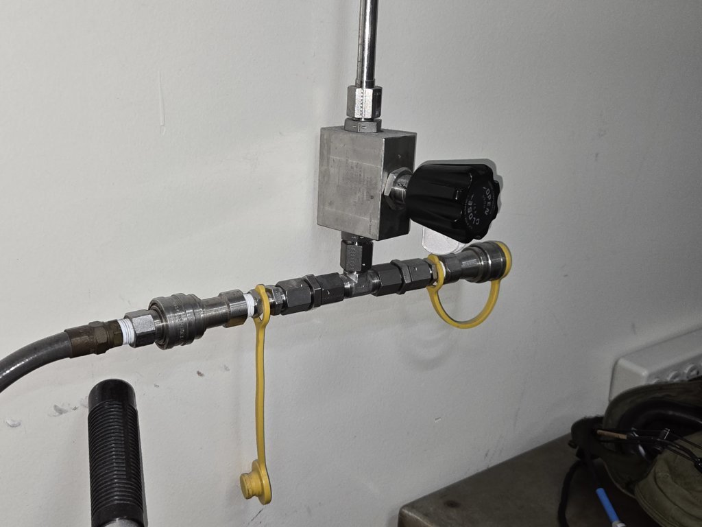

    Get you some of that double ended QD setup...no telling what Nasa spent on this crap...

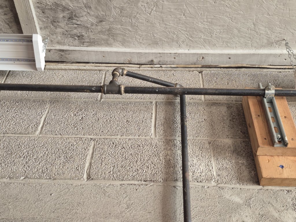

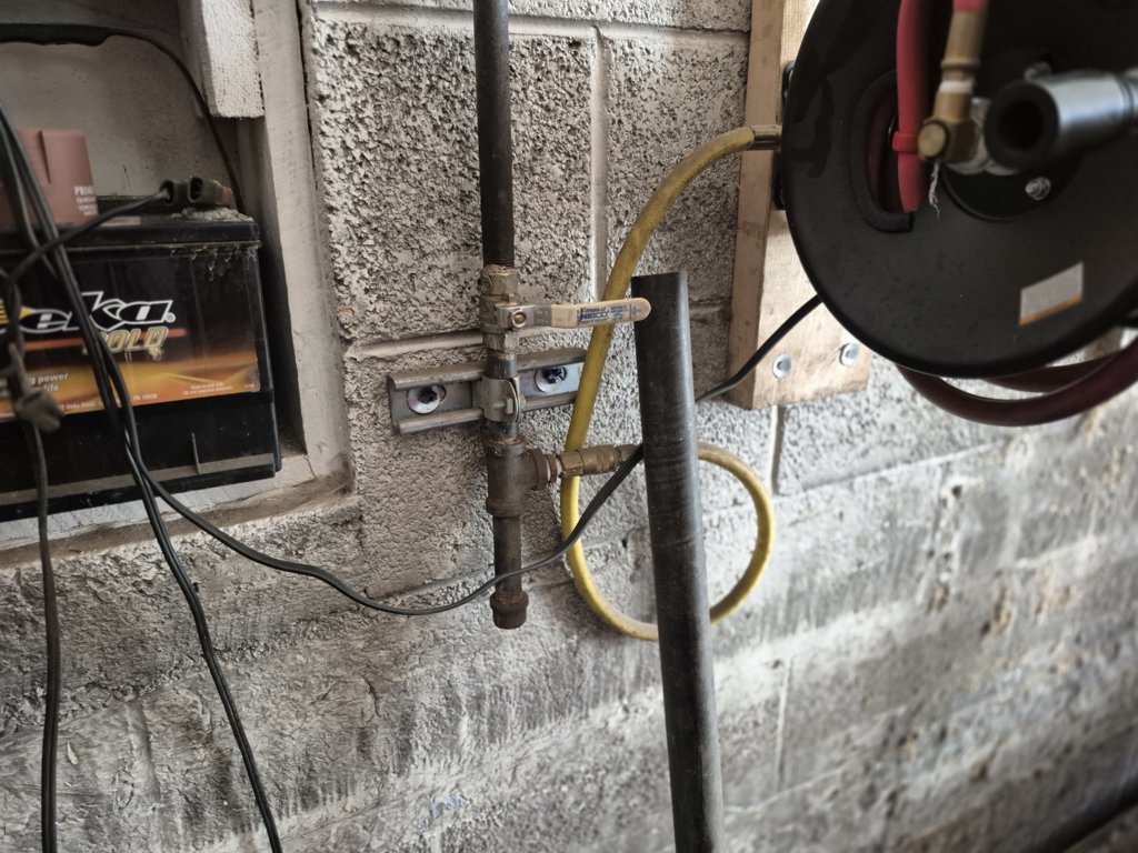

    Pipe runs should be pitched 1" per ten feet of run toward a drain leg, the leg should be of sufficient length to hold a fair amount of water and have a valve at the bottom for draining said water.
    Compressor tanks should have any moisture drained routinely, you can do this manually or with a programmable drain valve.
    A short hose of full pipe size is recommended between the compressor & piping system to isolate vibration that can damage the piping over time.
    My local hydraulic supplier made me one for a reasonable price.
    The system should have a vertical riser at the tank, with drain leg at the tank, this encourages any moisture to go down rather than into the piping system.
    All take offs should be on the top of the main line and again each take off has a drain leg.

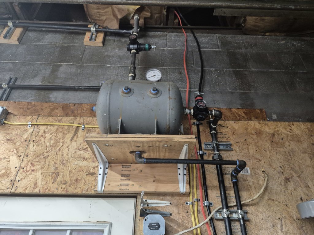

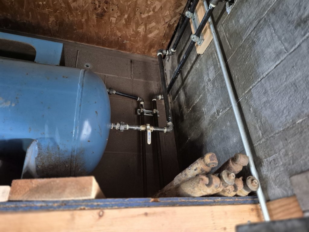

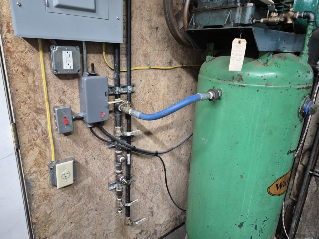

    Air system photos:
    The blue hose the Hydraulic Supply made for me, rated 2250 psi, I think it will do. ;)
    Notice there is a union at the compressor tanks for ease of service if ever needed.
    You can also see the riser with drain leg.
    The male fitting is where I plug in the gas power compressor or my back up electric one. That is what the left outlet is for also.
    The riser feeds throught a regulator set to 150 psi into this small tank, the tire machine requires the higher air pressure.
    The regulator on the riser out of the small tank feeds the main shop line and is set to about 110 psi.
    Note the tank has a drain also.
    Take offs are on the top of the pitched pipe, this keeps water & debris out of the drops.
    The bottom of each drop has a drip leg to catch anything just in case.
    At the far end of the run is this second 80 gallon tank, again with a drain. This feeds the blast cabinet which is also equipped with a water trap.
  13. Feb 14, 2025 at 2:31 PM
