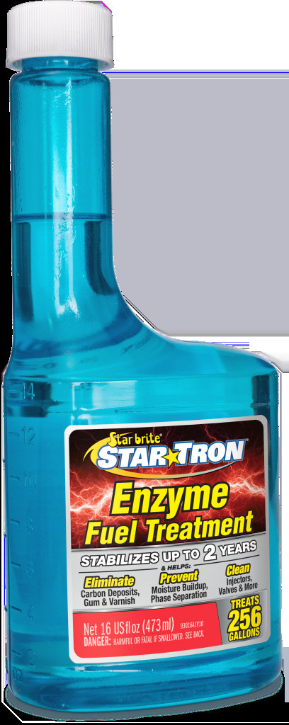

    Running lean due to clogged carb passages, you might try dumping some fuel injection cleaner in the tank and running it for a bit - might not work but then again it might and it is easy.

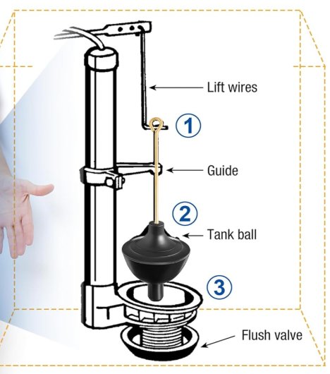

    That is basically what I have in similarity. There are few rubber pieces do get deteriorated/self-destructed that need replacing. Low budget system maintenance.

    Lazy tip #2
    Take the cover off so you can get to the carb.
    Shut the fuel off at the tank and let the engine run out. Pull the fuel hose of the carb intake and blow a blow a good bit of carb cleaner in there to fill up the bowl.
    Start it and crank it up to full throttle.
    Quickly put your hand over the carb throat until the engine almost dies then let it come back up to speed - repeat, repeat.
    The hope is the high vacuum will pull anything out of the passages. :fingerscrossed:
    Once you have used up all the cleaner in the bowl turn the fuel back on and repeat the hand thing a few more times.

    Did you run ethanol free gas? If not id say the jet nozzle is gummed up or might be some debris in it. If theres a fuel bowl carefully take it off see if bowl is git grit/dirt/gummed up. The jet usually unscrews with a flat screwdriver

    generator, atv, power warsher, stuff that has a loooong sit cycle, i never empty the bowl, i just start em and run em once a month, im sorry, did i say ethanol free? oh and i do put a splash of
    in my old style gas can with the ethanol free...just sayin
