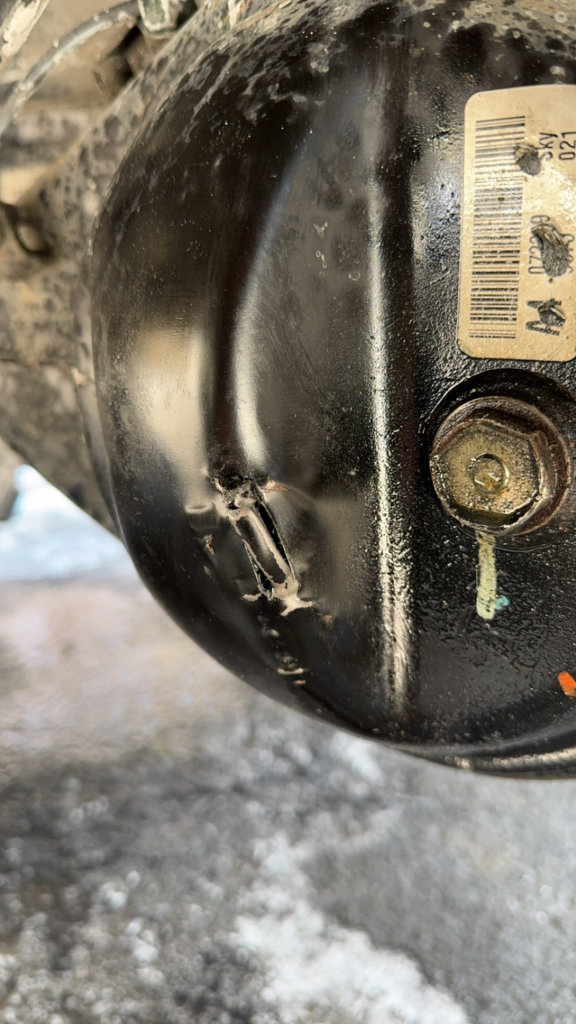

    rear diff?
    really looks like something tried escaping, given the paint chips...
    not good

    X2
  3. Feb 23, 2025 at 2:37 PM

    Are you bringing to the same shop that did the regear?

    It’ll be interesting to hear what they have to say about it.
    I would think whatever additional work you’re having them do would be dependent on their response to the diff issue.
    Good luck, I hope they treat you fairly :thumbsup:

    That is definitely something trying to escape, you can tell the dimples are pushed out :eek:

    Since you are re-geared I'm going even harder on my theory that a ring gear bolt backed out, got wedged, and caused this damage. Right now the bolt is sitting on the bottom thus not making any noise now. If one backed out then I can only assume another can back out. This is totally on the shop that did your re-gear. This is all speculation from me, but seems to be the most plausible thing to me.
