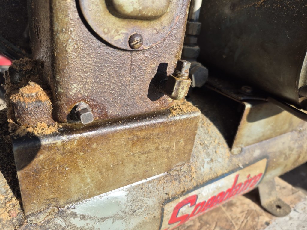

    First, check the oil the plug on the right is the level - none...
    Use 20 or 30 grade non detergent oil, automotive oils will make foam in air compressor service - foam gets by the rings and into your compressed air. :puke:
    Foam doesn't lubricate well either.

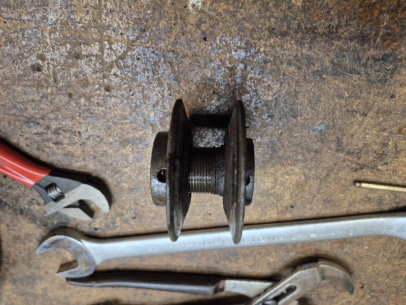

    The motor pulley was broken, the V section that the belt rides on would spin on the center. It wasn't moving without some persuasive.
    It doesn't know who it is messing with here, we have these situations covered.
    So there.
    Fortunately in the archives I had a spare, nicer cast iron adjustable one.
    These are in 2 pieces, the inner section goes on the motor shaft with a set screw to hold it. The outer threads on, tighter is taller which speeds up the belt.

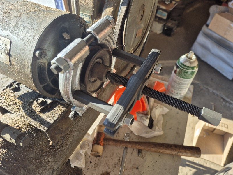

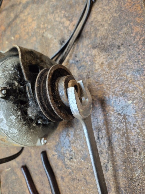

    The new pulley wouldn't slide on the motor due to the shaft being somewhat chewed...
    With a a few drops of oil for the bearings, 20 grade ND again, plus a temporary cord the motor zinged to life. :)
    I polished the shaft ;) with some sand cloth, installed the pulley and gave it a try.
    The pump works & is quiet. :)

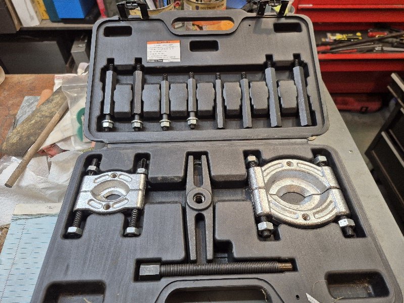

    I finally bought one of those puller kits last year, wish I'da had it many years ago. What a game changer.

    No doubt, the job is done in minutes rather than the hour you would spend putting something together.
