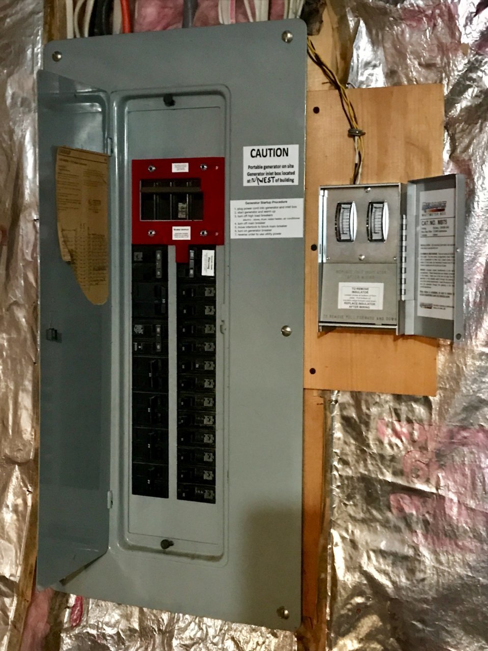

    If I told you how much I did mine for. It’s not fancy. But it works. It’s not automatic.

    Gen , wiring installation, lock out.
    And my monitor .
    $1,000.00

    you have to understand it took me a long time to acquire those parts. That generator had 10 hours on it and I bought it for $400. I ran the wiring. Set up the boxes and everything. The electrician came in and took him 15 minutes.

    So I just installed a 13kw generac at my moms place. 100amp entrance rated transfer switch, battery and oil heaters, concrete pad, ready to go cost me 4200$. Power goes out, it turns on. Texts you when it needs an oil change. She had propane but that would run most everything including an electric range. A local guy does them for like 7500 installed. My cost was just the parts and me wiring it.
    the other way to do it, is buy whatever you want for a generator, I have a predator 6500 from harbor freight, it was 489 and runs like a million bucks. Get a generator inlet, a lockout, and a breaker and do it that way. I’ve had good luck buying from geninterlock.com. They usually offer free shipping if you buy the cord, interlock, and inlet at the same time. It might be tough to get them now where most of the state of Texas is having rolling blackouts, I don’t know if they’re buying generators or not.
