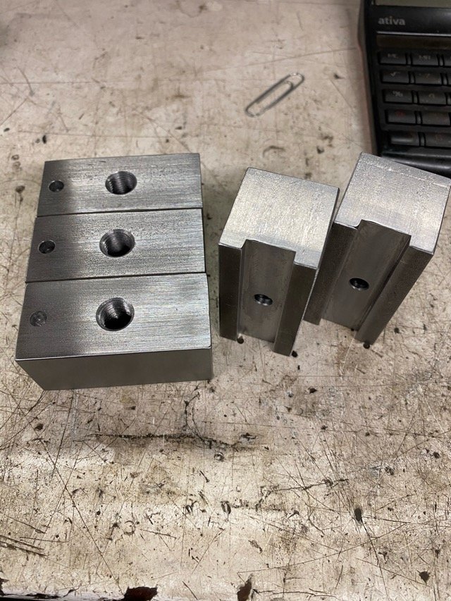

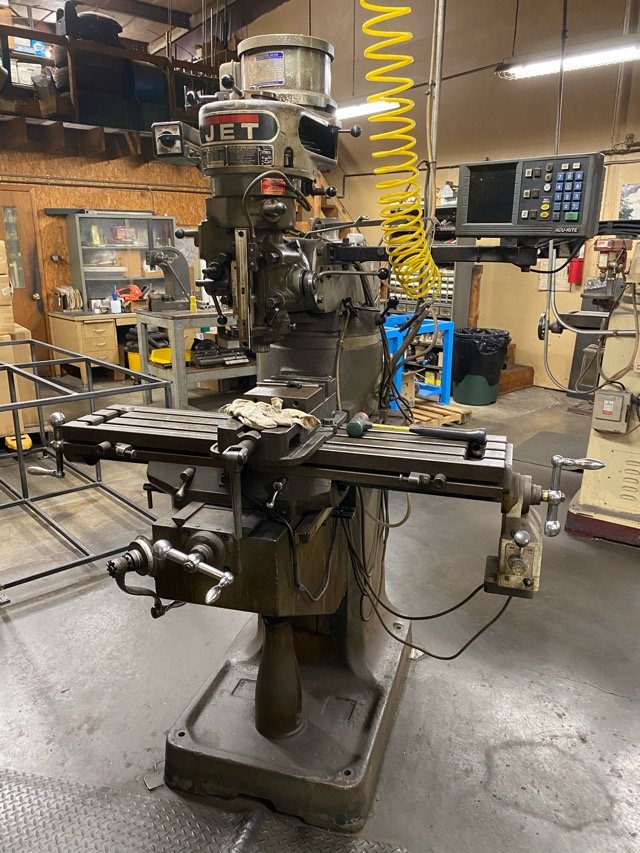

    The third picture you posted is basically the same set up as the mill we have in our shop. I believe its a Bridgeport (?). We don't use it a lot, and as stated by @Gregthespy it often is used as a drill press but watching you guys has fed my interest in using our machining tools more so yesterday I got my boss to give me a short lesson on using it.

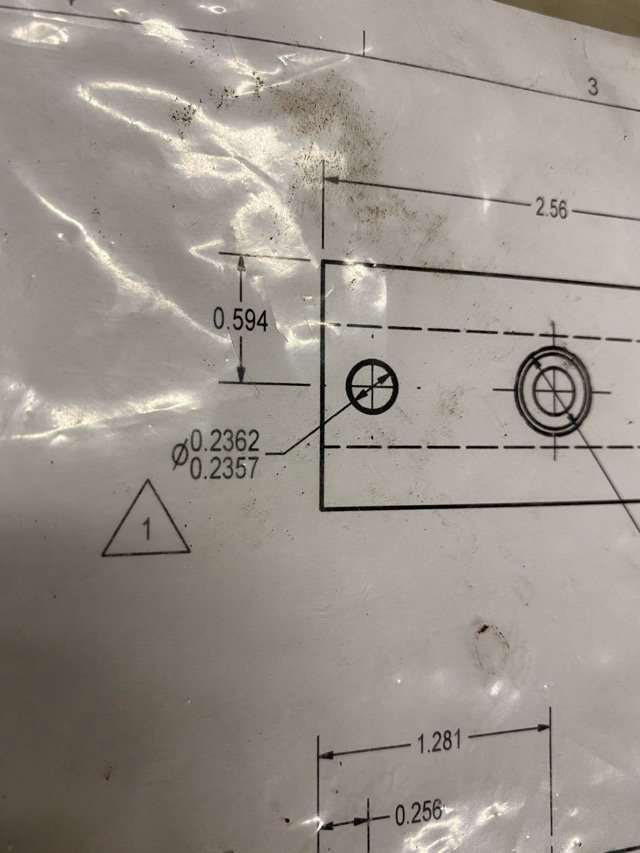

    I did a job the other day that had some .7874" holes with a tolerance of +.0004" -.0000" luckily we don't get a whole lot with a 4/10ths tolerance.

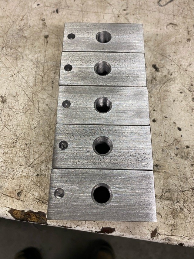

    I sanded the other 4 parts so they blend in with the one I welded. This one had a dowel hole with a .0005” tolerance. They get zinc plated so you won’t be able to see the boo boo anyhow :D

    Ream it to size?

    I was going to ream them but drilled them with a .234 (A) drill bit and they came out perfect.

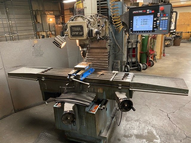

    Is the one you welded the middle one of the first picture?

    Yerp :thumbsup:

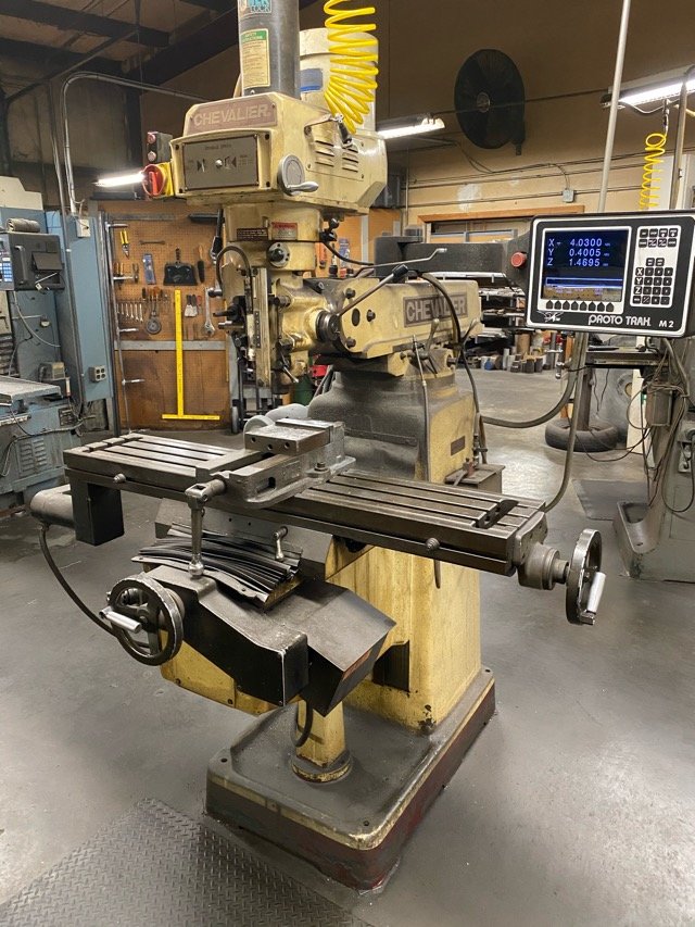

    No DRO on the machine?
