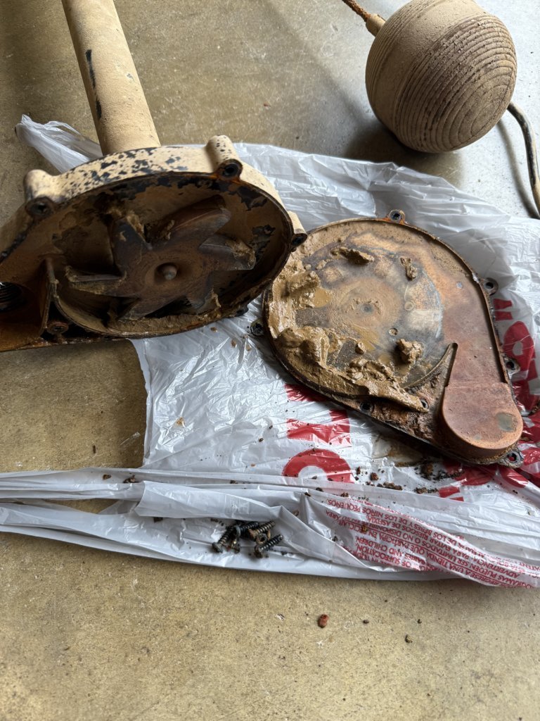

    I’m adding sump pump repair to my list of abilities. Motor and switch still worked, so I opened it up. Impeller came loose.

    If there is a check valve on the output it is stuck open or there isn't one.
    Either will allow water to spin the impeller backwards when the pump shuts off.
    Since the pump goes from "on" to a rapid reverse it loosens the impeller.
    Check valve should be as close to the pump as practical.

    Not one, just a flat where the shafts meet
