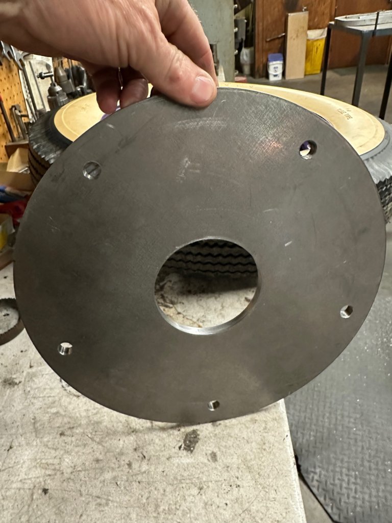

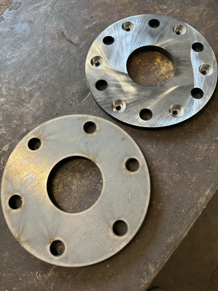

    Customer brought this "wide 5" wheel in and ask me to make him an adapter plate so he can balance them out of 3/8" thick steel with a 3 1/2" hole in the center.
    Did a quick search and found this info......
    "The '36-39 Ford had the "wide five" bolt pattern, the actual bolt pattern is 5 on 10 1/4 and it is also easily identified by just looking at it. All the normal cars and pickups had 16x4's, but the ones that had the V8-60 engine had 16x3.5's. The hubcaps on these wheels are held on by clips. In 1936 only, the heads of the rivets that hold the hubcap protrude from the mounting surface and the back of the rim. These wheels MUST be used with drums that have a recess for the head or they will not mount flush."

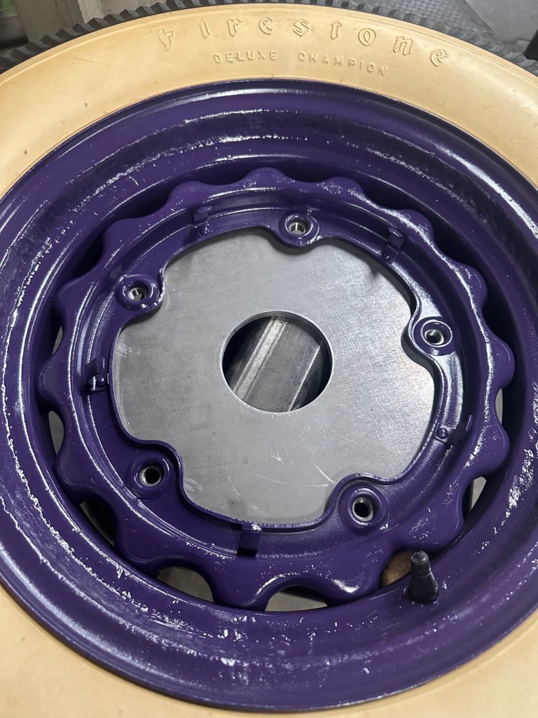

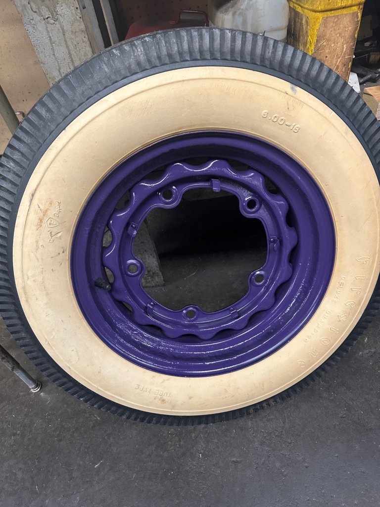

    Excellent work by you as always! :101010:
    However that wheel is uhm.. interesting. Not the way it mounts, but the painting over the rust like that... wow o_O

    He said this was his spare. He needs to look on Ebay, there are some decent ones on there for not a lot.
