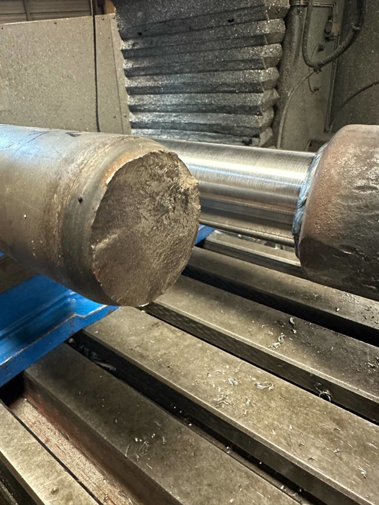

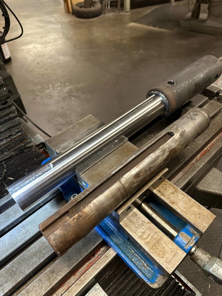

    Broke shaft repair. Bored the big part out 3 1/2" deep and put a new piece in it, welded it, then turned it and redrilled the hole. Keyway didn't need to be as long.
    Cole was with me yesterday and I said you want to see something cool? I set the big piece upright on the floor and put the new piece on top of it, it went in about a 1/2". I got the torch and heated the big part up and the shaft fell in. He said why did it do that? :D

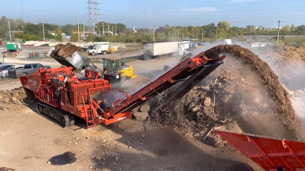

    It goes somewhere on a Morbark grinder kinda like this...
