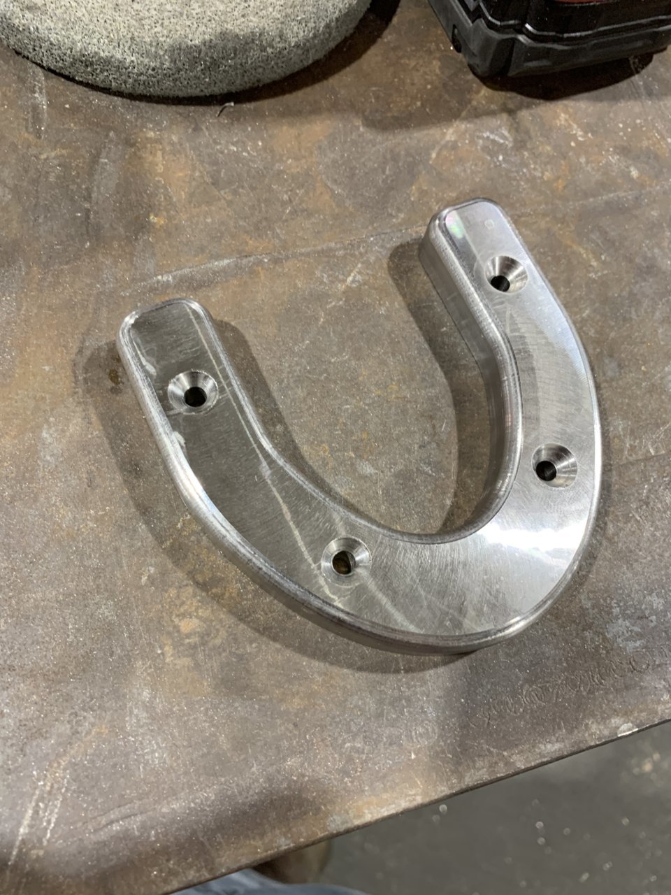

    This is one of the first production parts we started with on our Milltronics using MasterCam. It’s type 316 stainless steel. We currently have the tool paths set up so well that we don’t run coolant on it.
    Being that we had no machining experience, quite a few people who have machining experience are often impressed we pulled it off. We definitely are seeing that the smaller frame machine has its limitations when it comes to vibration.
    These parts are then hand polished to a mirror finish.

    I don't see how you do it with no coolant on 316 ss, that blows my mind!

    316 definitely is one of the tougher stainlesses to machine in my experience, seems like to like more feed. Profiling I've always found the endmill is happier running with air than coolant. Drilling is another story though lol

    That’s where having complete control over your tool paths is needed, using cam software allows you to send the chips off of the flutes in the correct direction which keeps the flutes free of chips.
    Programming conversational on the machine is great for a lot of things, but this was where we saw the value of offline programming.
    We also make a corresponding egg shaped piece which goes inside of the horseshoe. One of the big challenges was holding these parts since they’re all parabolas.
    If you knew what these were for you’d agree that some people have waaaaay too much money and spend it on details that probably don’t even matter.
    But hey, it keeps our doors open!
