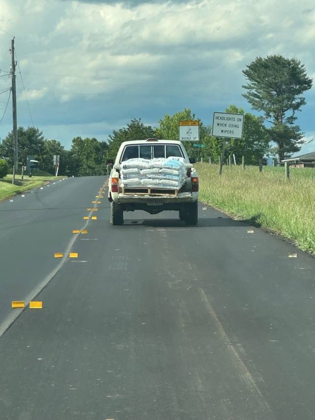

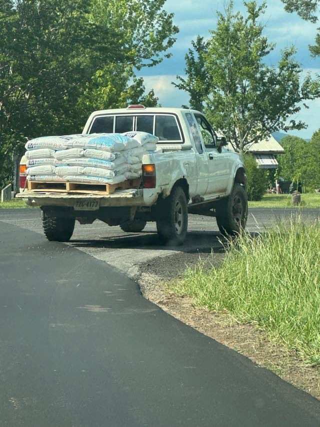

    "Oh what a feeling" is what the frame of this Toyota was screaming yesterday. I hope the frame isn't rusted as bad as the bed :eek:

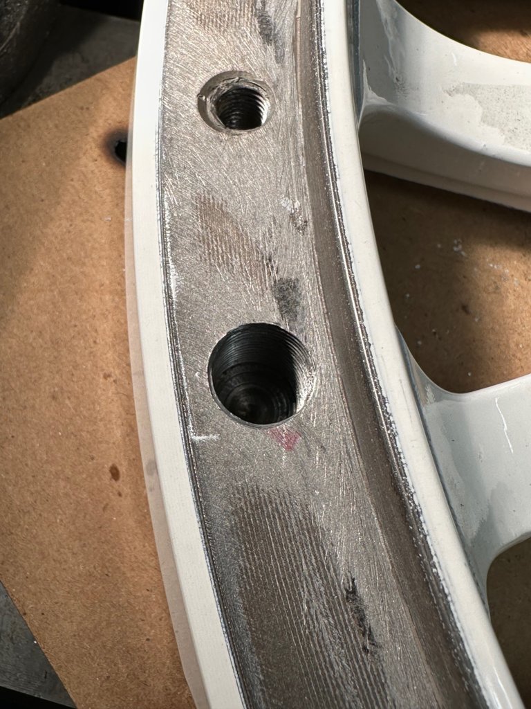

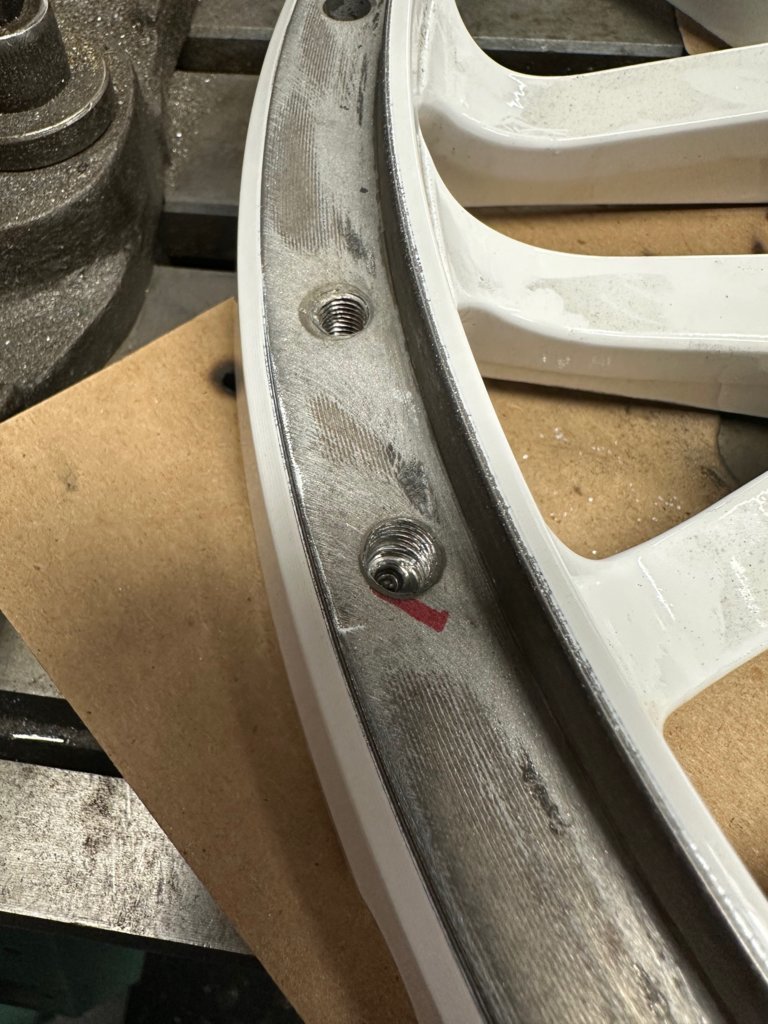

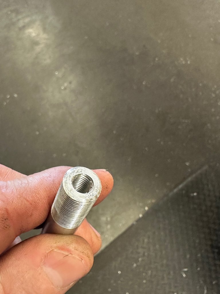

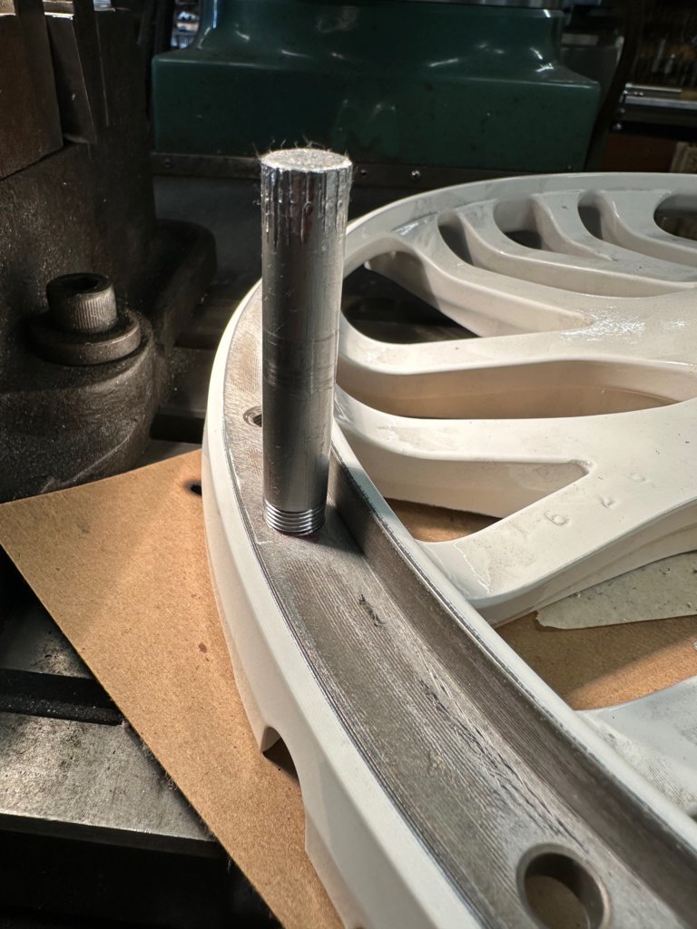

    Customer brought this wheel in and said it had a broke M7 bolt in it he tried to drill out and then tapped the top M8 but he wanted the bolt out and for it to be M7. Alright then.
    Made a special thread insert M12 on the outside and M7 on the inside, little loctite, lot of plier to get it tight then hacksawed it off and filed it down.
    Oh and the face is polished and painted, don't scratch it :facepalm:
